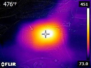

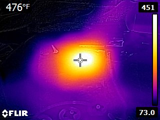

  3. Haven't seen that at all with my Therion 75 ... As a matter of fact I was bored one day and checked it with a FLiR gun... The DNA75 was set for 475° at the time...

  9. So I was reading over the problems everyone has with SS316L and temp control. I too have noticed that with the temperature set at say, 450F it seems to be a cool and airy vape, like it's not hot enough. So I decided to check it out with my handy little FLiR gun... It seemed to be lower than the set point at first (this was @450F) but I soon realized that it the vapor will throw it off if it's in the area of the focal point... So I set it @ 475F and got close up to the coil, so the vapor wouldn't throw it off... Seemed pretty close then. Oddly enough, at 475 it's a cool vape (IMHO) and that I now see why some folks have theirs set at 500 and above. Haven't tried Ti yet or anything else.
