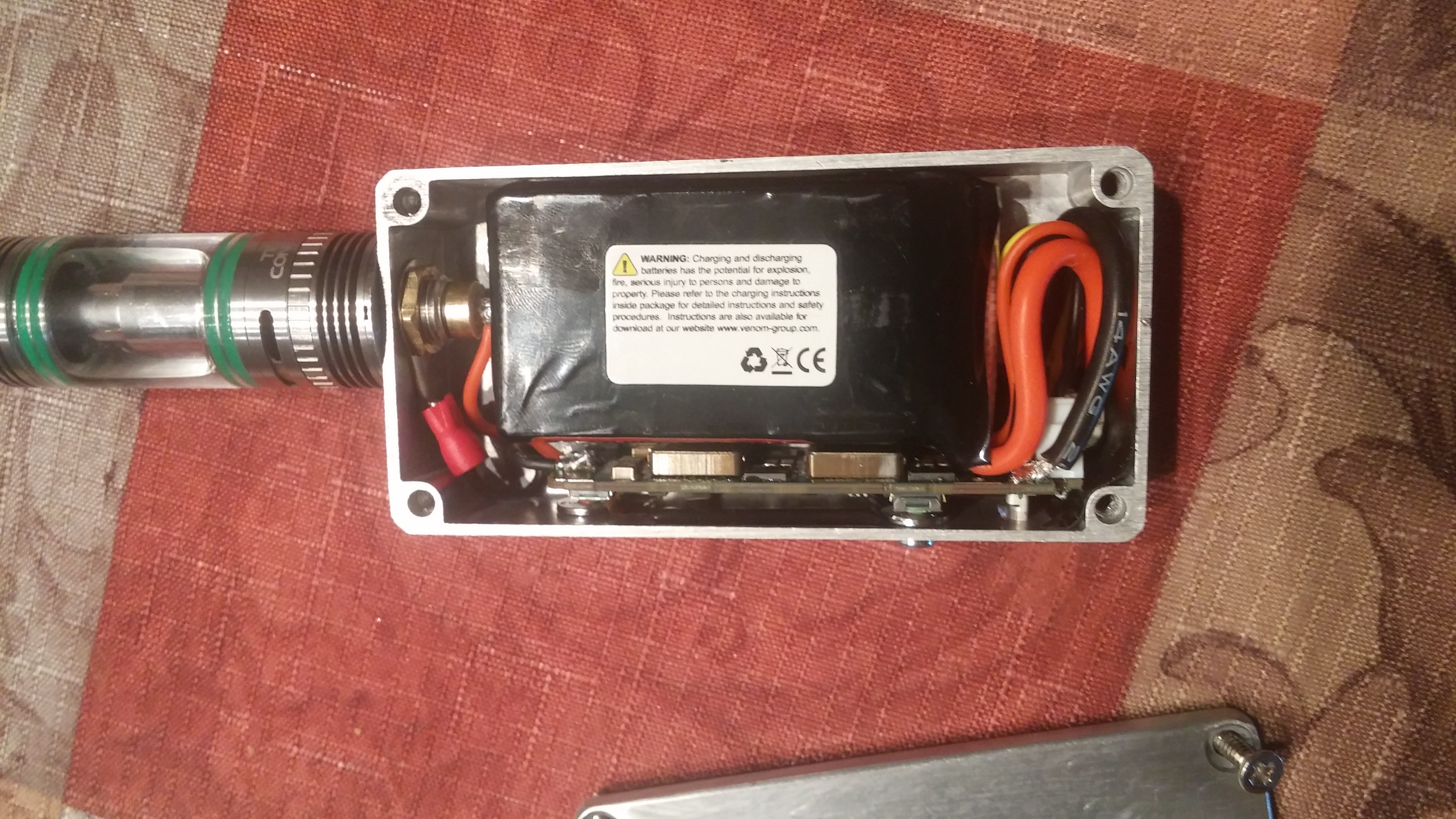

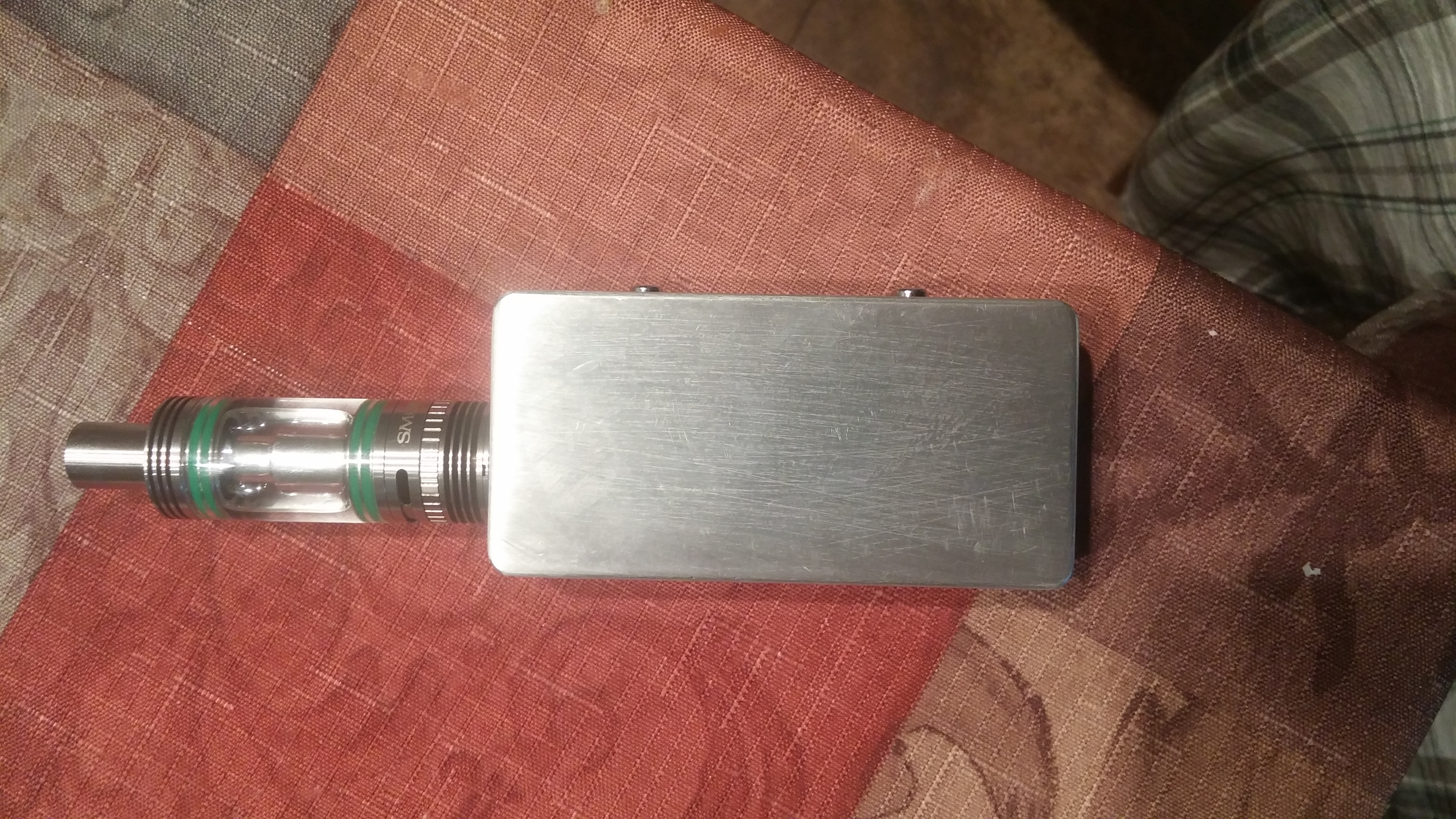

adski Posted July 18, 2015 Report Posted July 18, 2015 Just semi finished this one. Inside needs tidying up so no pics of that yet. How do you guys go about cutting out the USB port? I can never get it anywhere near right

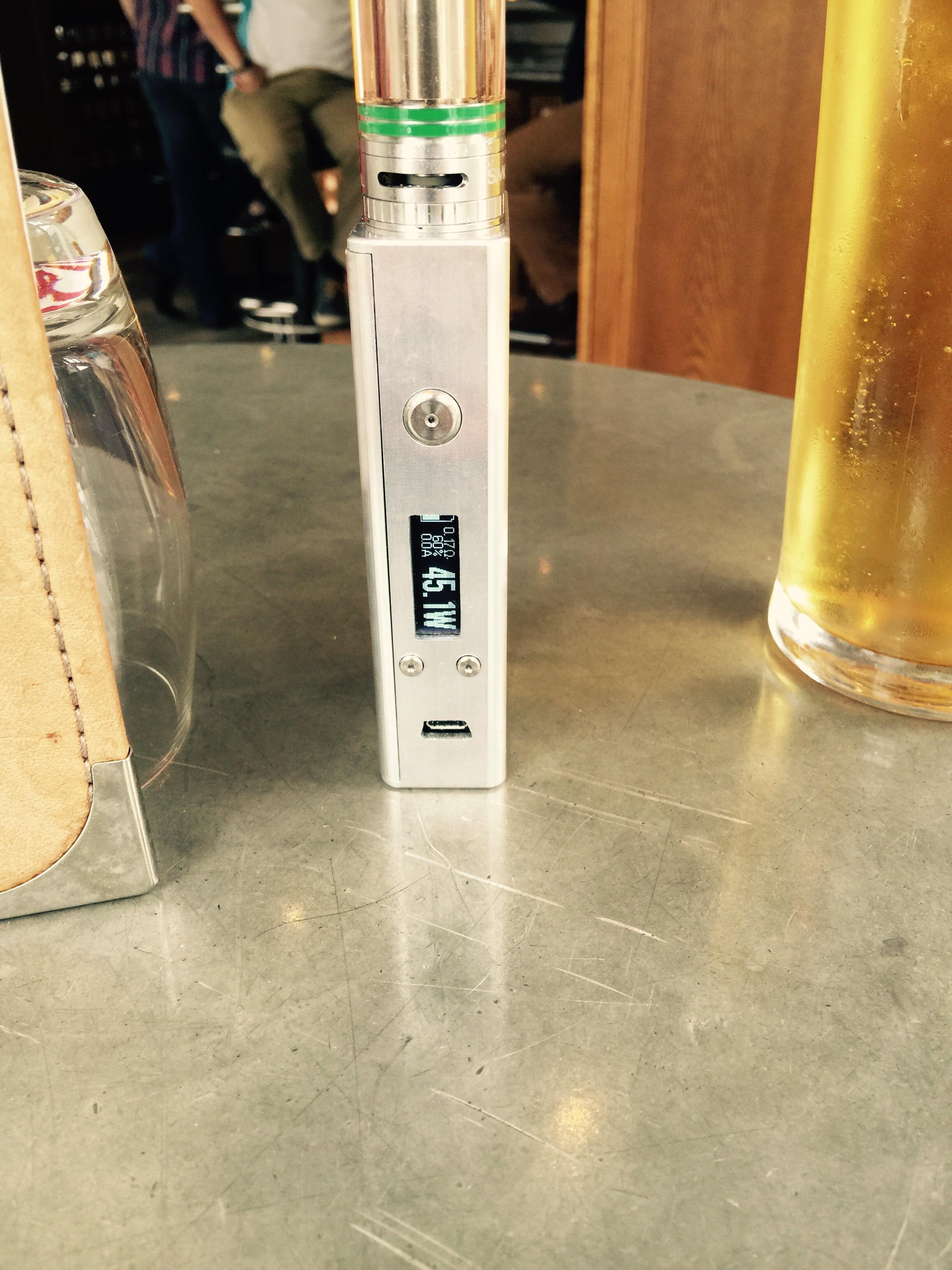

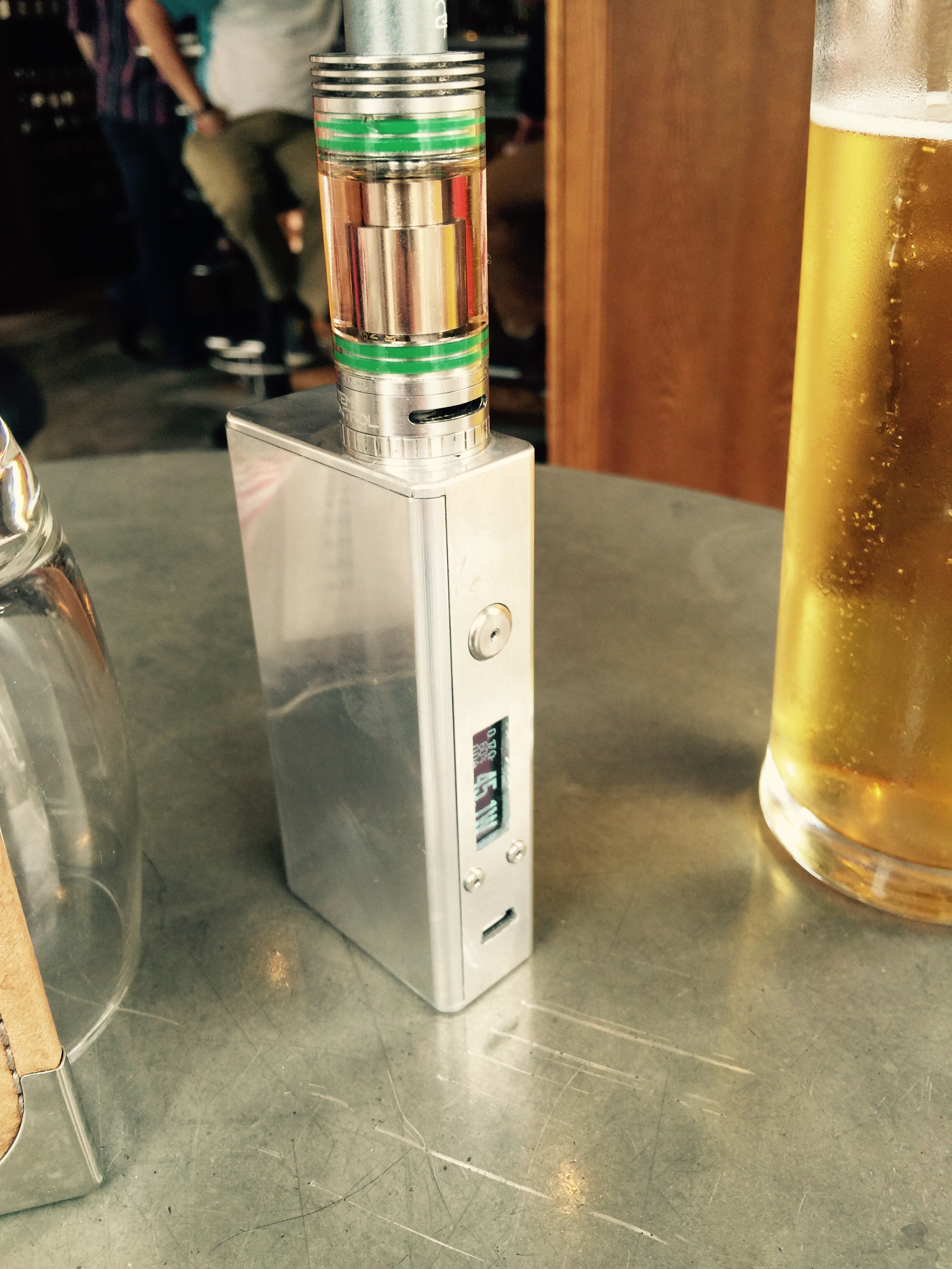

speed4mee Posted July 18, 2015 Report Posted July 18, 2015 Which enclosure is this?I've made a function mod, all is hand-crafted :
adski Posted July 18, 2015 Report Posted July 18, 2015 Ric Groves cases of modmaker UK. Don't buy them all because I want a few more.
adski Posted July 18, 2015 Report Posted July 18, 2015 http://www.modmaker.co.uk/Mod-Making-Supplies/Enclosures/ModMakerBox-1005024-Natural-Aluminium. They come polished. Don't forget the magnets. They are sold out of the 2mm magnets so I bought the 1mm ones and doubled them up.
VapingBad Posted July 18, 2015 Report Posted July 18, 2015 I looked at those ModMaker cases and rejected them just because of the magnetic door, if you use one be sure to secure your battery in case it gets dropped the lid pops of and the LiPo takes a hit.
adski Posted July 18, 2015 Report Posted July 18, 2015 I like the clean screwless look. I'm putting a fab of epoxy under the battery. You could just put a dab on each side of the door if you don't want to use the magnets and don't plan on changing the battery until it dies. Wouldn't be too hard to pry open again.

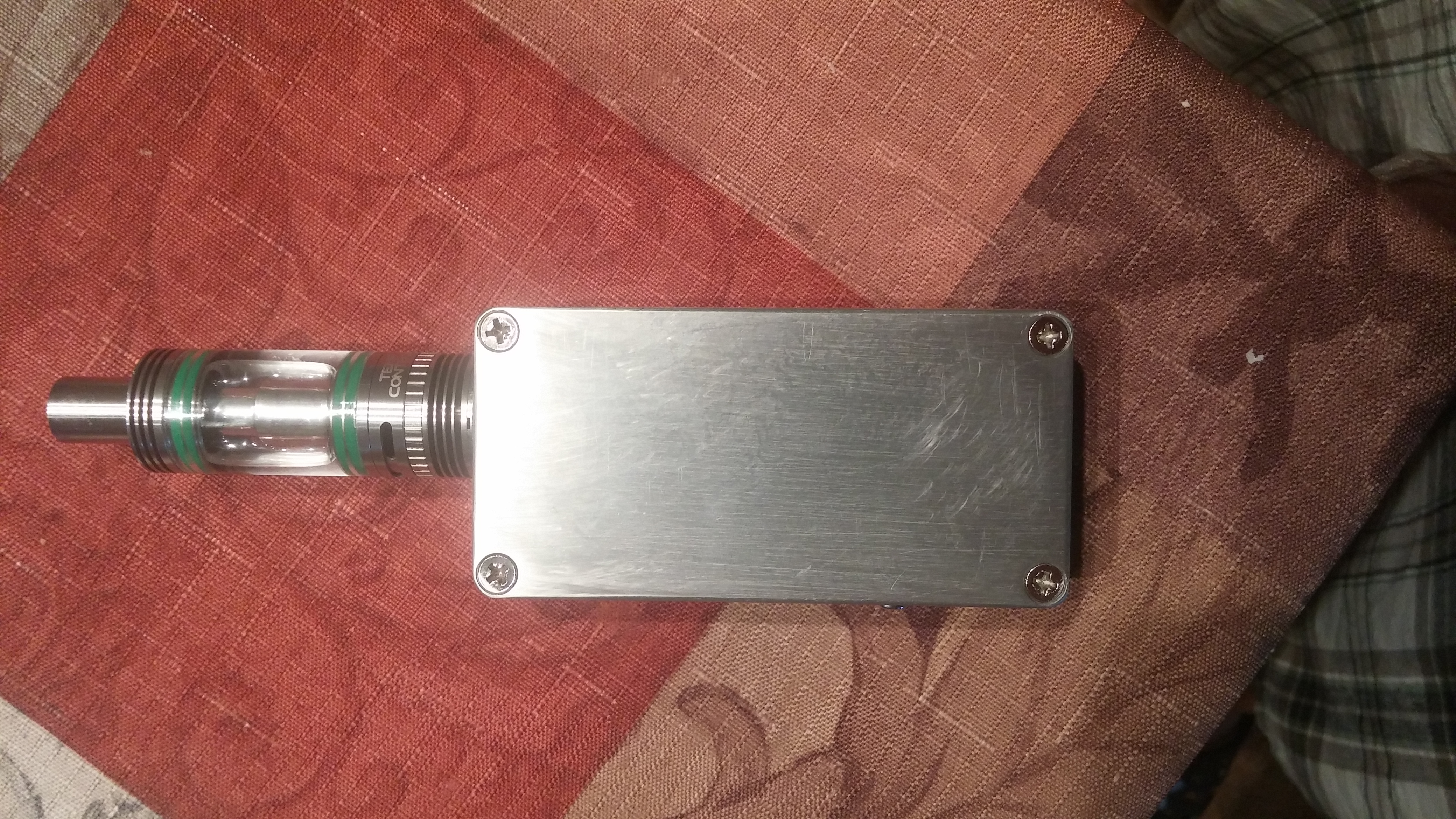

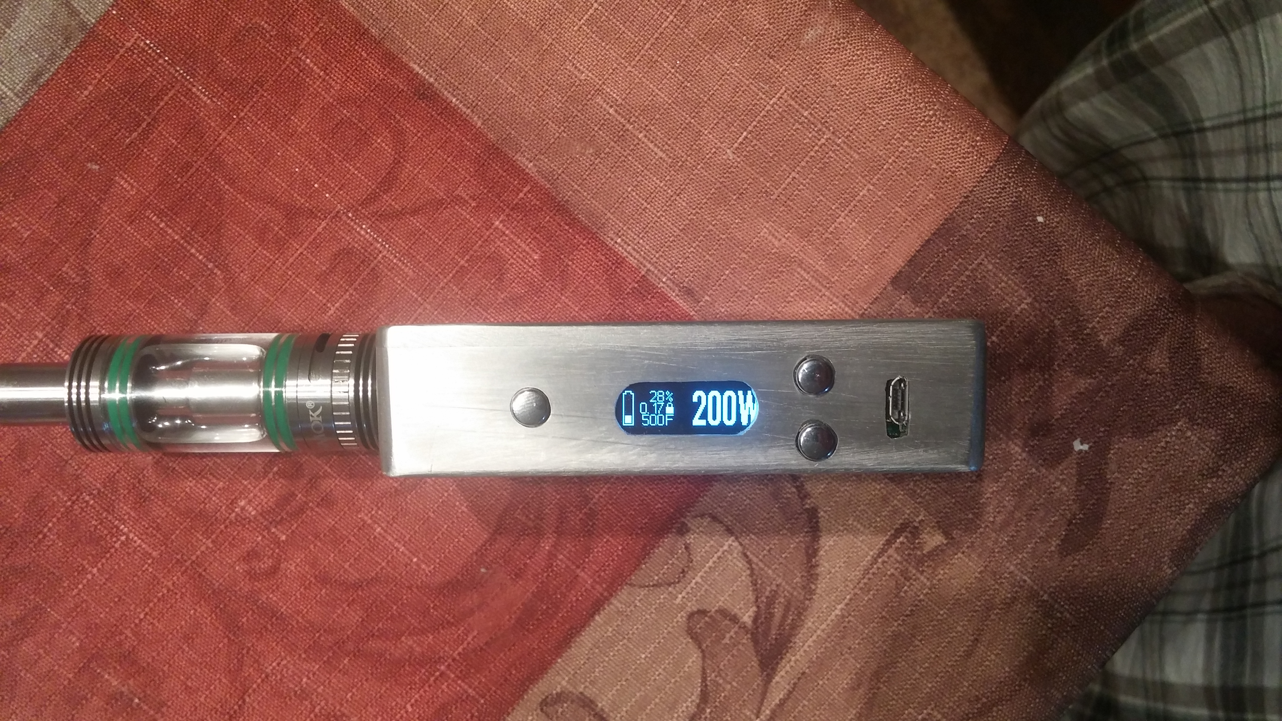

antyac2108 Posted July 19, 2015 Report Posted July 19, 2015 Just finished it last night it's a 1590A with a shapeway's front cover. I have a 0.06 Clapton NI200 build in right now and it's awesome!!!!
Always_Jonezen Posted July 20, 2015 Report Posted July 20, 2015 That is a nice box. What size battery were you able to squeeze into it?

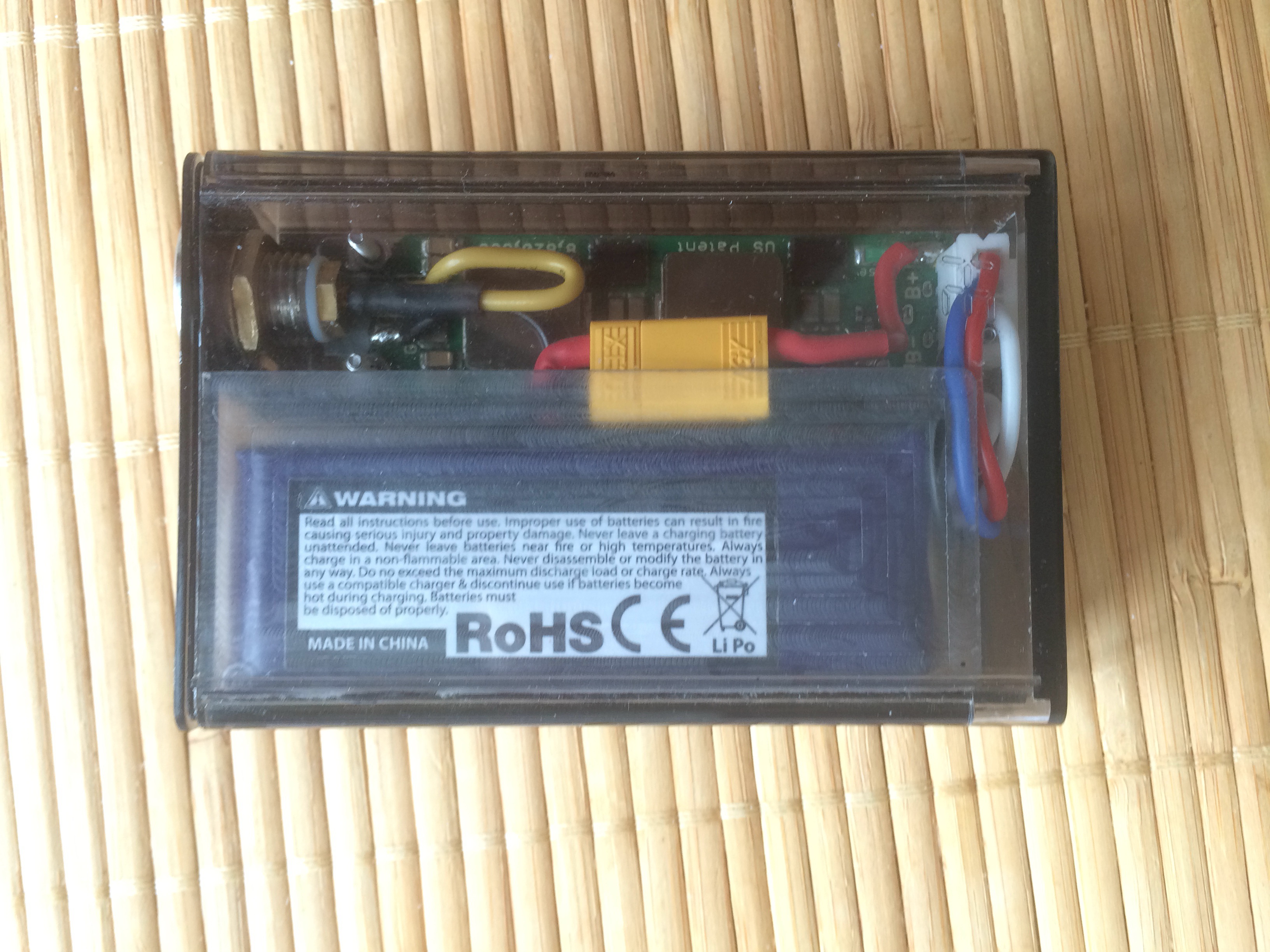

Always_Jonezen Posted July 20, 2015 Report Posted July 20, 2015 Here is my first try Hammond 1590g, I messed up on the Usb hole. I will be making some more, I have 5 more boards coming tomorrow hopefully.
VapingBad Posted July 20, 2015 Report Posted July 20, 2015 Always_Jonezen said:Here is my first try Hammond 1590g, I messed up on the Usb hole. I will be making some more, I have 5 more boards coming tomorrow hopefully.Well done, but it looks like you have the thin & thick wires in the wrong places, the thickest is normally for the output not the battery.
adski Posted July 20, 2015 Report Posted July 20, 2015 I had the chip mounted in a different box with a bigger battery where all wires were 14awg. Switched to the 950 nano battery and didn't bother upgrading the wires as I think john on here said they were good enough as they are silicone coated.
VapingBad Posted July 20, 2015 Report Posted July 20, 2015 adski said:I had the chip mounted in a different box with a bigger battery where all wires were 14awg. Switched to the 950 nano battery and didn't bother upgrading the wires as I think john on here said they were good enough as they are silicone coated. I wasn't talking about your mod, but about the one in the post I quoted

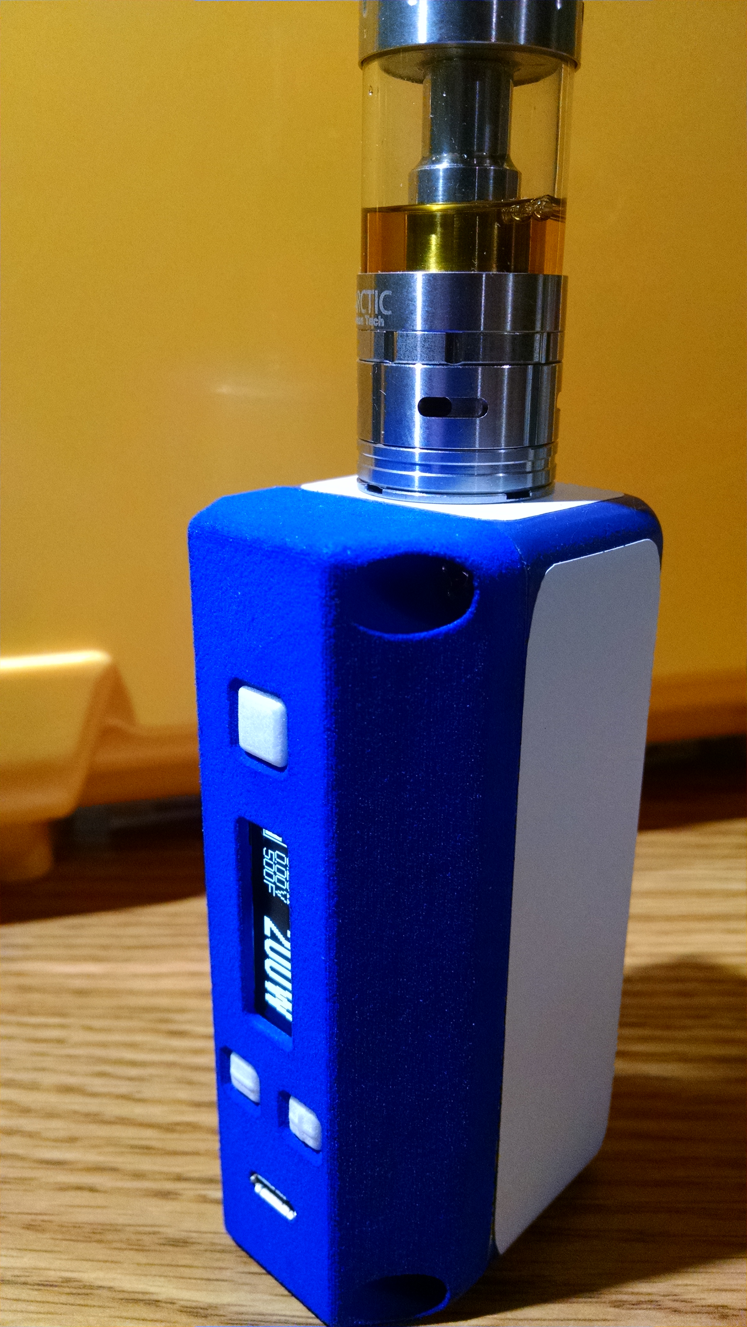

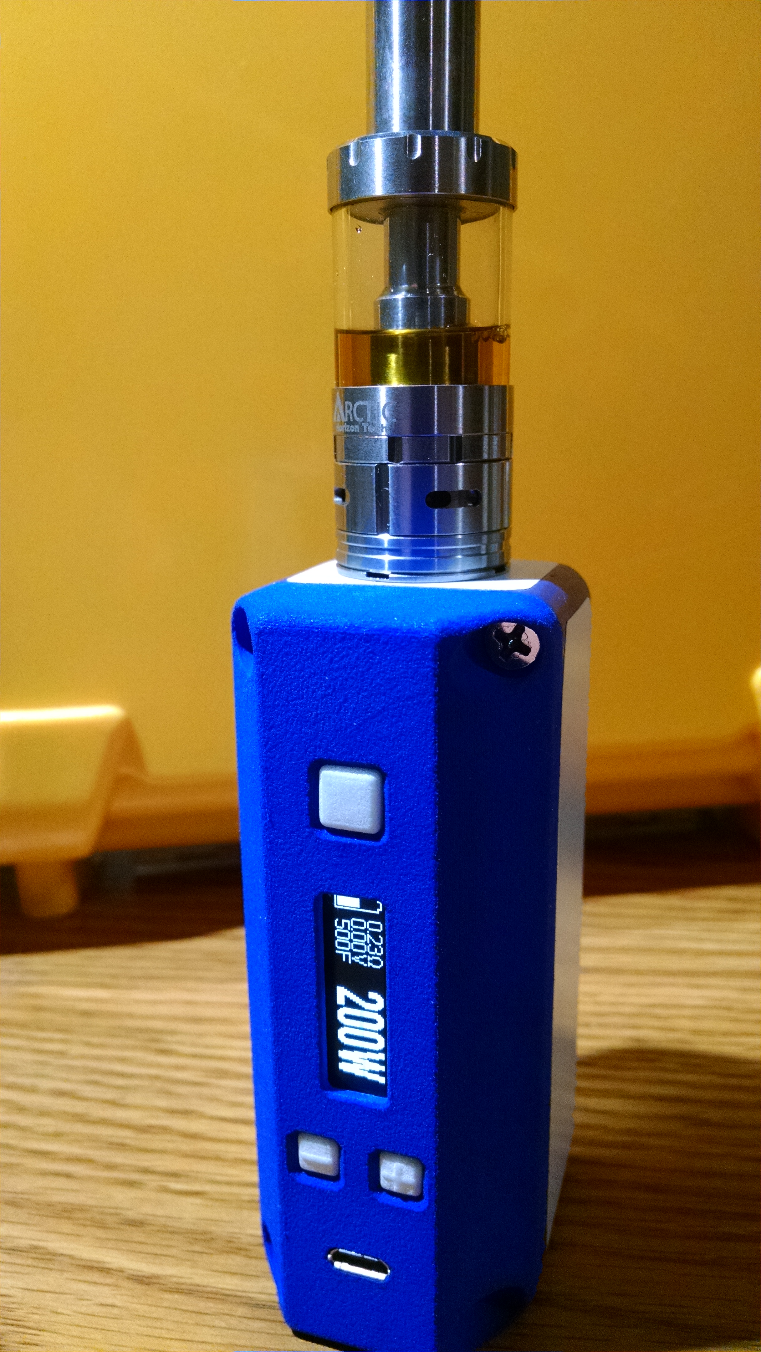

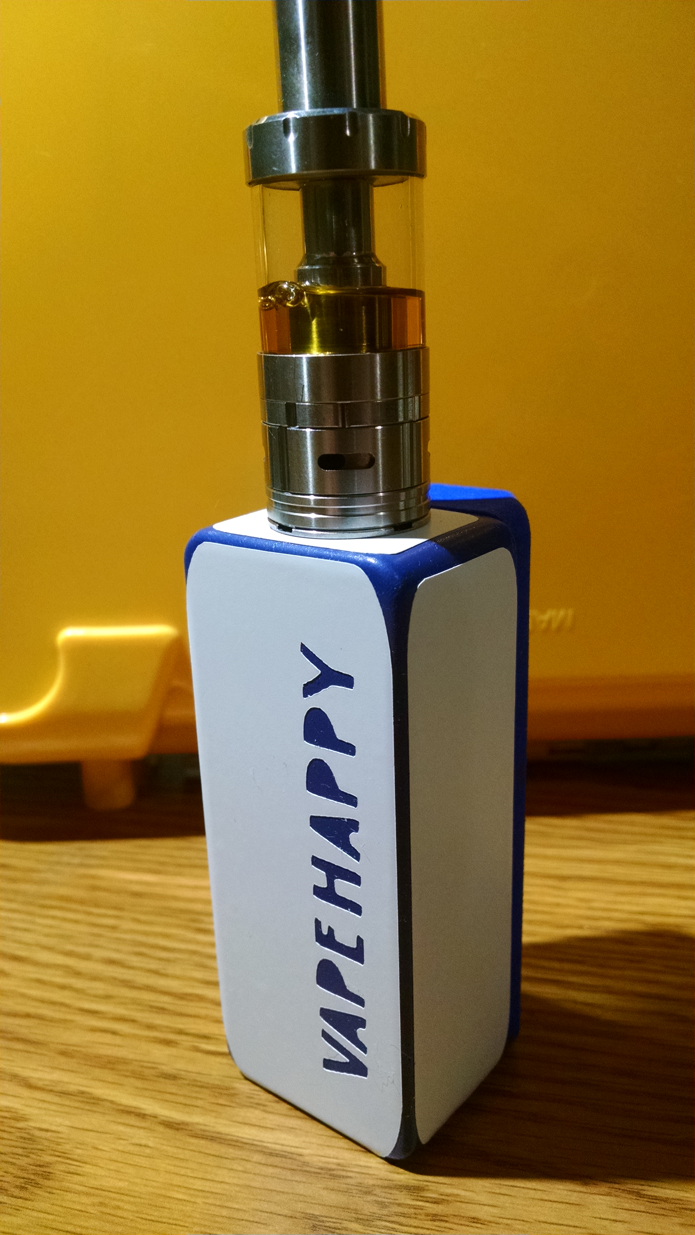

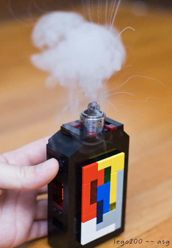

asg Posted July 21, 2015 Report Posted July 21, 2015 I posted this over on ecf in the dna200 thread, but figured it belonged here as well:Finished this mod a few days ago, just got around to taking a few pictures. Meet the lego200: Wiring inside is 12 gauge to the 510, 16 to the battery. The extra XT60 in there is between the dna200 and the 510, since I wanted things to be modular (this being lego and all). The 510 is from fasttech, basically a varitube clone. Battery is a Turnigy nano-tech 1000mah 3S 25~50C. Everything else is lego including the button actuators, chip holder, screen mount. No glue, only a small bit of double sided tape to hold the screen. The only cut into the lego was for the 510 (a hole for the threads, and a recess for the top plate.The style plates attach onto the side. So far I've made the two seen in the pictures, but I will likely make a few more. And I need to find some mounts in black. The grey ones stand out when the plates are off (they are completely hidden when they are on though).Been using it at about 50W mostly, 410F - 430F, preheat set to 200W 1sec. Vaping great. Now I just need to keep myself from ordering more dna200's.
adski Posted July 21, 2015 Report Posted July 21, 2015 Love that orange screen. I might have to steal that idea!
