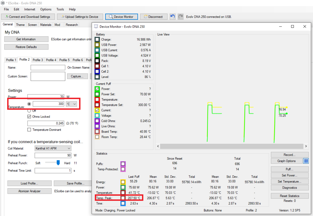

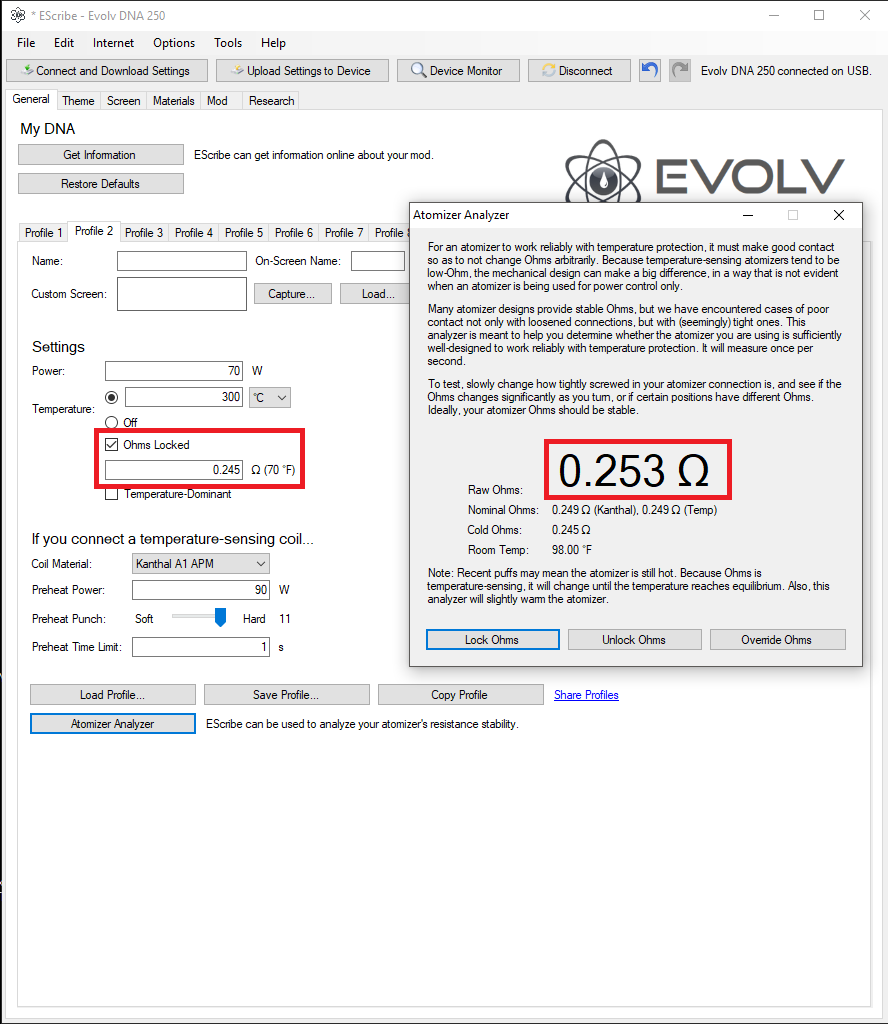

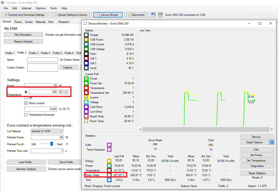

Theo Posted June 23, 2017 Report Posted June 23, 2017 (edited) it's not working for my mods i've try it to 3 devices Reuleaux DNA200, Drone BF 166 (DNA250), VT75 Nano but no luck last try with the drone EDIT finaly i got it to work i locked lower resistance than the atomizers real one and keep the set tempeture above the maximum that the device manager read It works perfect every single time i hit the fire button with all of my 3 dna devices Edited June 23, 2017 by Theo

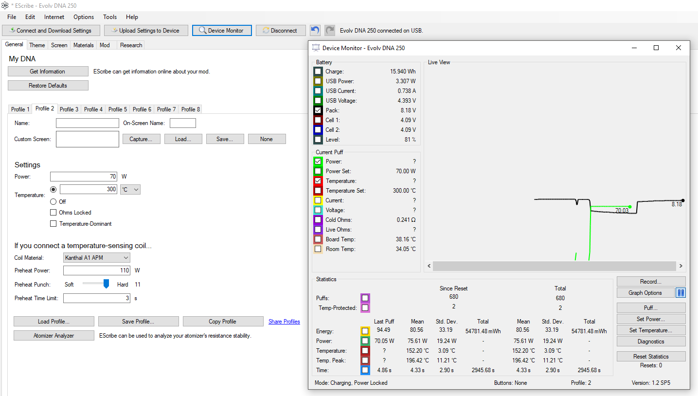

Jadegrsx Posted February 18, 2018 Report Posted February 18, 2018 Does this still work for DNA250? I tried to do it on my therion166, and seemed to let me set it up in escribe, yet there was no change with the slight delay to fire, with preheat 25 watts higher, and punch 11
