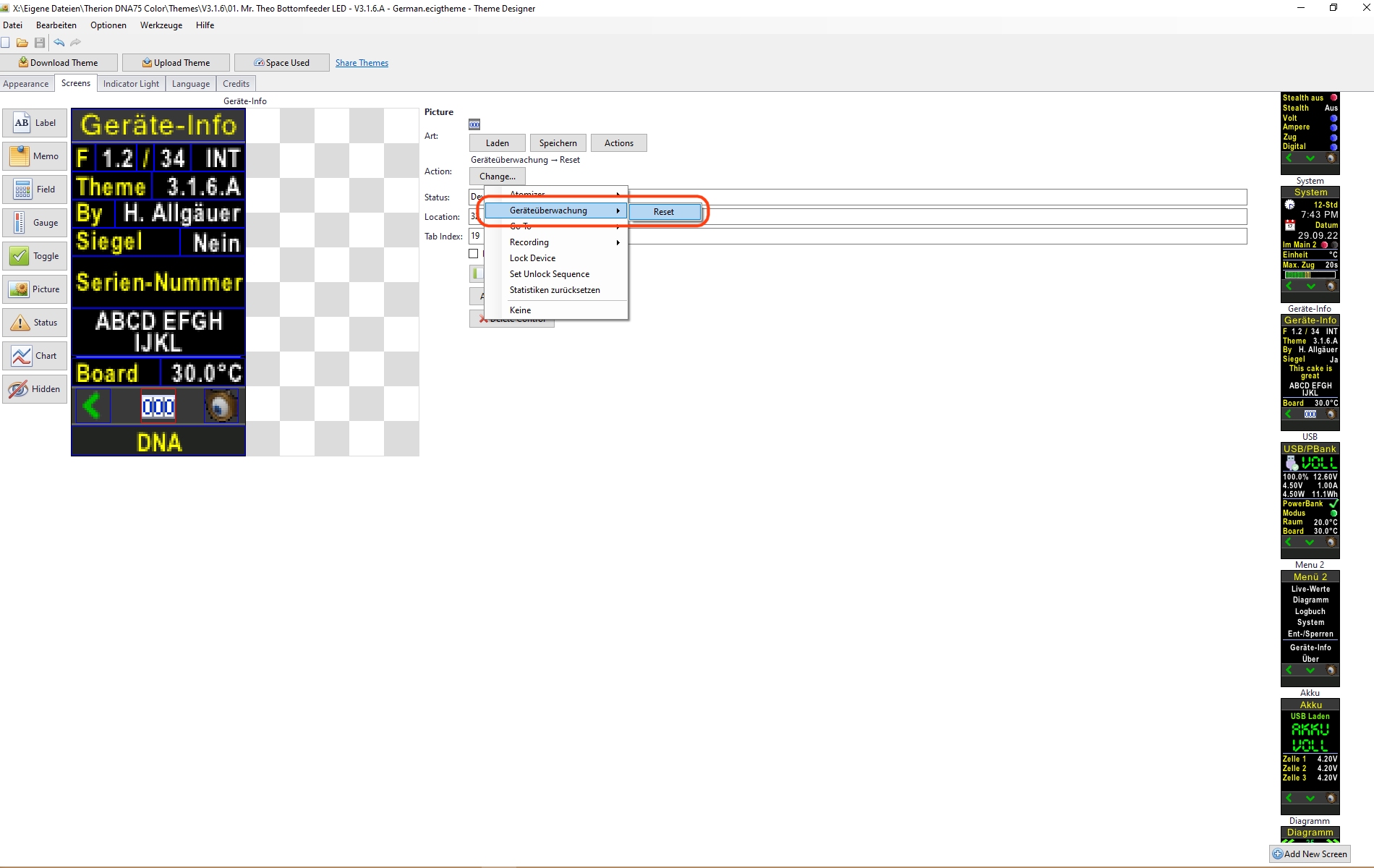

Hi my friend, I found two kinds of possible resets in the Theme Designer First: "Action" - "Geräteüberwachung" -> "Reset" (means "Action" - "Device-Control" -> "Reset" or some like similar in english) This is the one, I have talked about and what seems to me is doing nothing when using this function. The second is the "Action" - "Statistic-Reset" - that works and sets visible the Statistic-Counter back to zero. -
