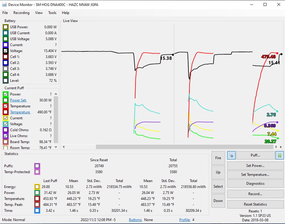

Well if you increase power, you increase voltage, resistance (with TC material), and temperature too, so they all go hand in hand. When you decrease power, you decrease voltage, resistance, and temperature. So when you increase warmth, you are warming the coil faster. Of course, once you hit the max temperature setting, it isn't allowed to go higher and power will drop to keep the temperature from going higher. And you can't say like one bump up in Warmth is 10 watts more power. Nor can you say it is 10° warmer. As it isn't calculated that way. As it is based on a percentage of the power setting looking at the Device Manager. There could be other factors in play in the algorithm. As I don't have the source code and I am sure it is a trade secret anyway. But you can see the effects in the graph. And that is what is important.
The power and temperature didn't change? What were you changing? Warmth? It only has an effect when playing within Replay, just like @Wayneo said. I figured I am going to have to do it for you. Here is Warmth set in the middle, then full, and then off. Maybe you don't see a difference, but I sure do. It gives it a boost in power in the beginning the puff. The higher the warmth, the higher it applies more power. When off, power is flat without any extra power at the beginning of the puff.
Do what we have been saying. Run EScribe's Device Manager and change whatever you are curious about and then see how it changes your vape right on the screen. Or are you insisting we do it for you?

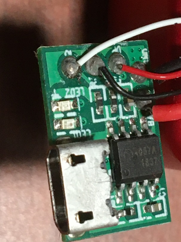

Yes, it sure looks like it @Wayneo and pin 14 too.
Some people just put the wires through the holes without soldering. As long as it is making a connection and you don't bump it, should be ok. I wouldn't try updating the firmware though. One slight intermittent connection might brick the board. But other things besides uploading settings should be fine.
You shouldn't need the two thick black and red wires to be connected. They are just for charging and not needed for EScribe.

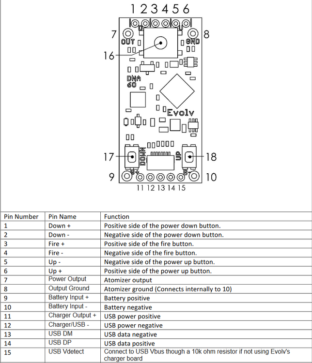

The USB board, the three wires on top. White goes to 15, red goes to 14, and black goes to 13 on the DNA board. The thick black goes to 10 and the thick red goes to 9. 11 and 12 on the DNA board isn't used.
That USB board looks like from a SXK BB. It would work if it was connected correctly to a DNA60.
