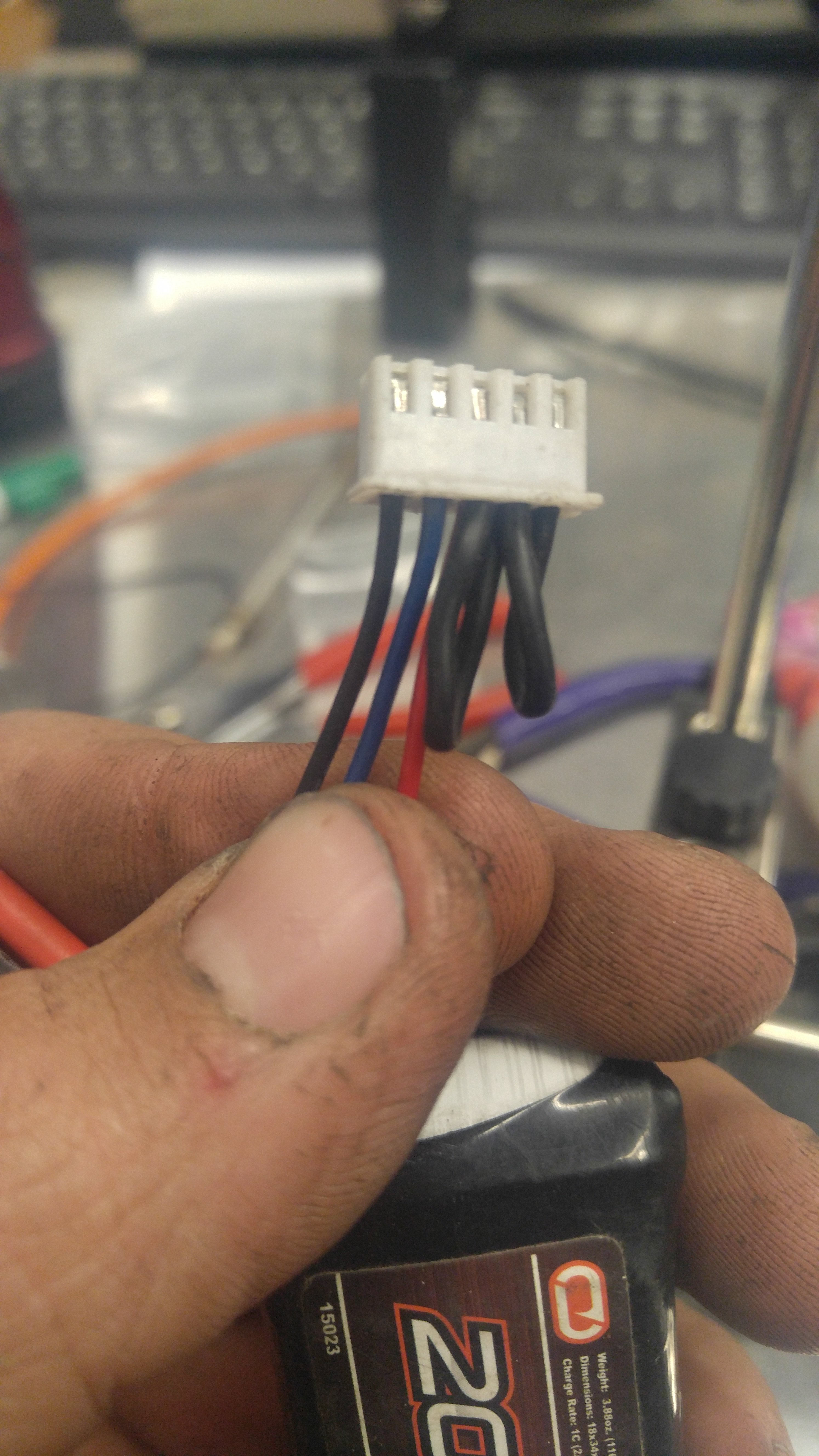

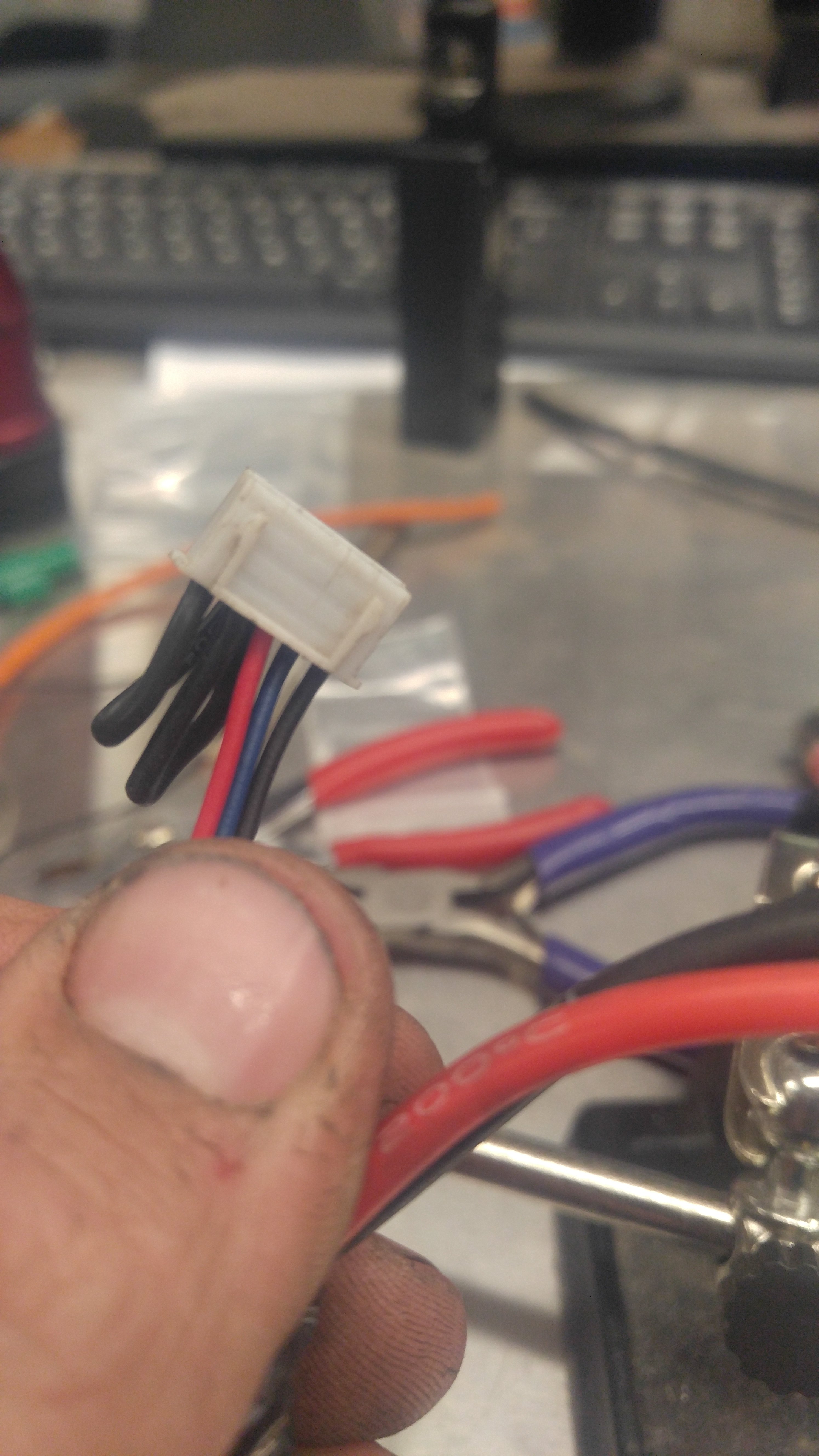

I just put a 4s plug on a 2s batt, then soldered the wire for cell 4 to the pin of cell 3, and the wire of cell 3 to the pin of cell 2 of my battery. Works fine on the mod, and seems to work fine with my venom pro rc charger. Also, de-solder 1 connection and put 2s jst back on, then pack is back to stock.
The diagram on the data sheet tells you to bridge the last cell in you batt cofiguration with the remaining balance terminals on the board
I'm going to put a 4s balance plug on my 2s batt and tie cells 3, 4 to the cell 2 wire, so I can swap to 3s or 4s at any time
