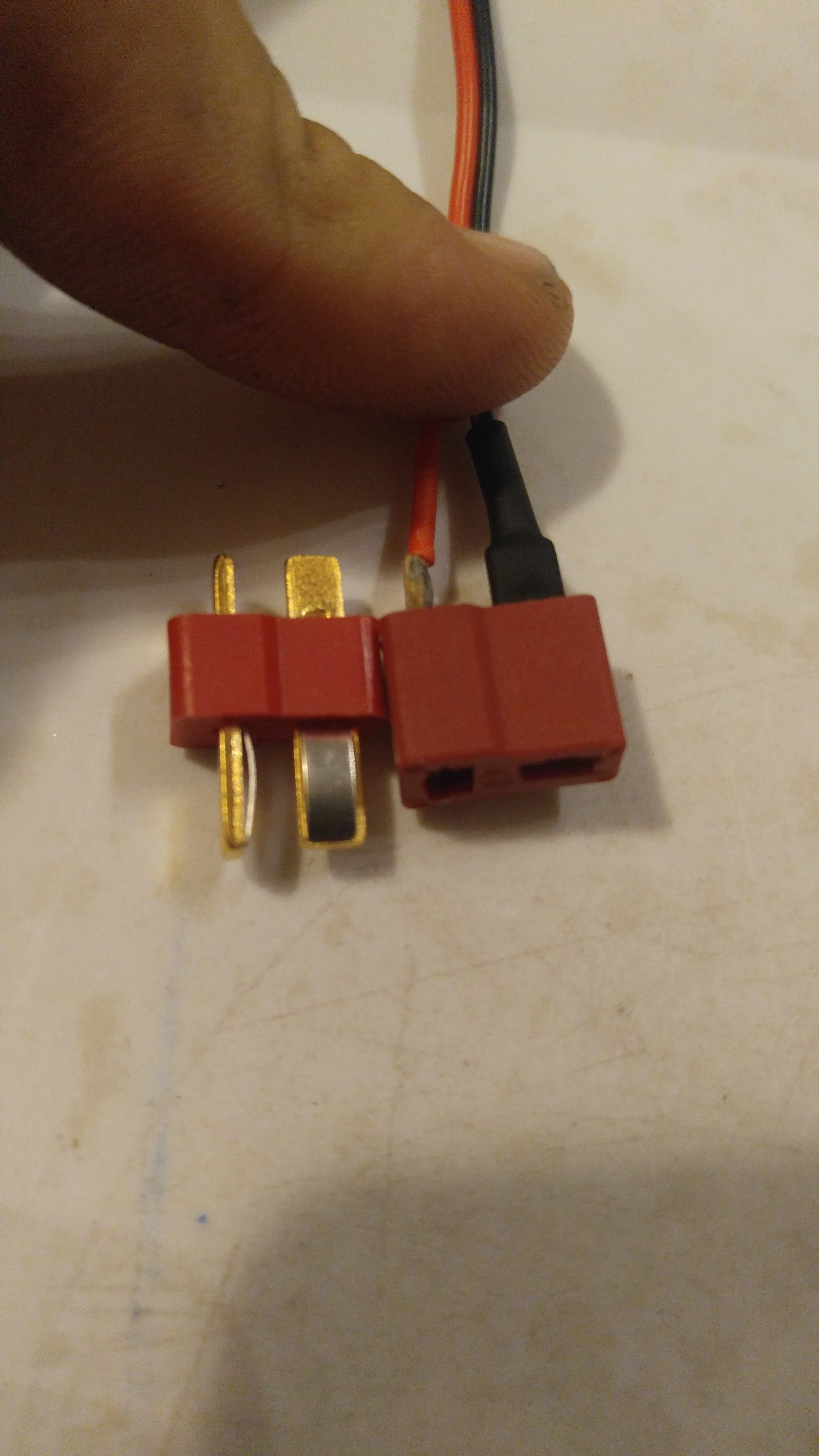

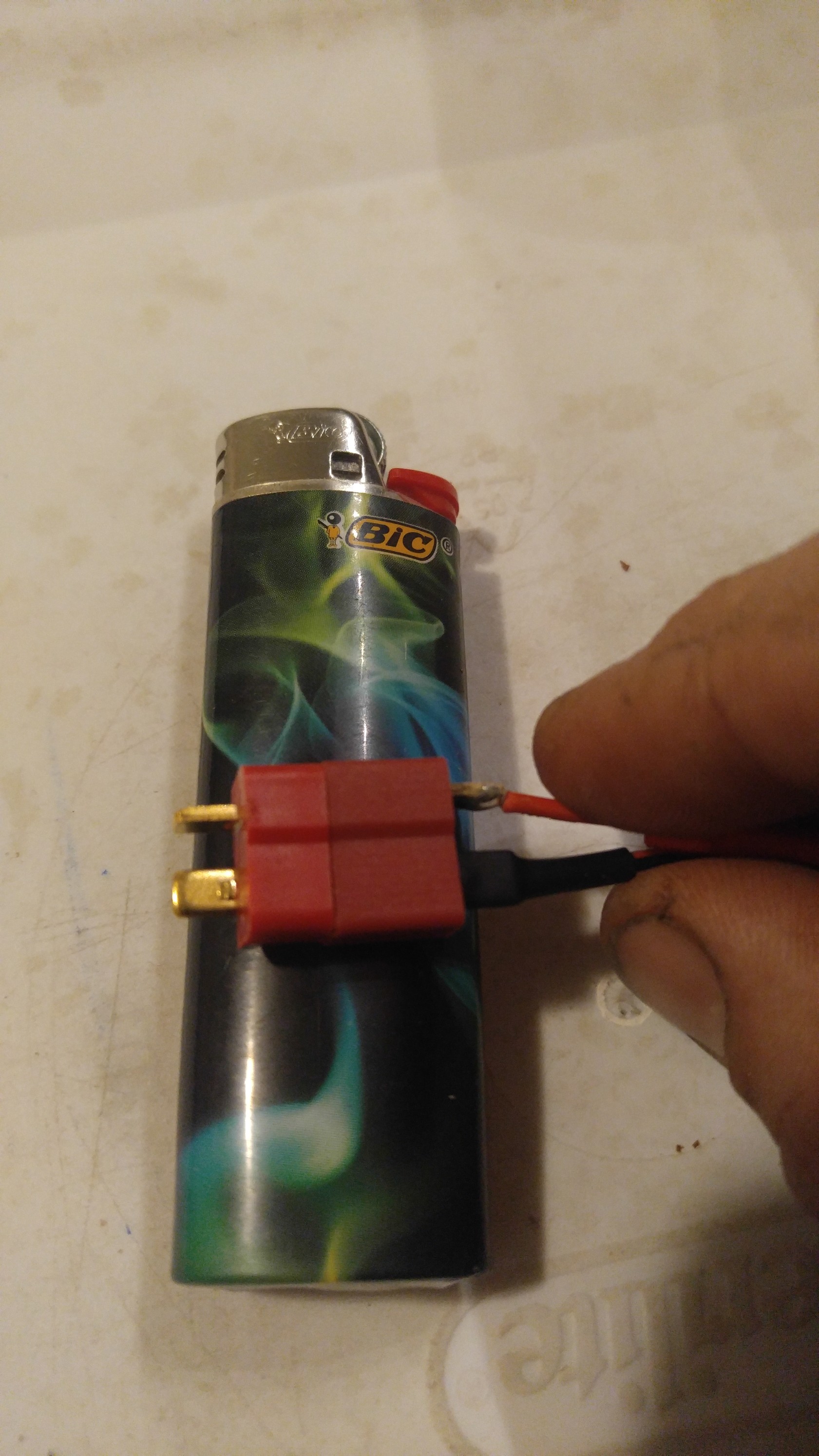

  11. So I started getting this sorted out, and there's definitely not enough room in the silo-950 case for the dean's connector, now looking at bullets with short wires to point up and loop back down
