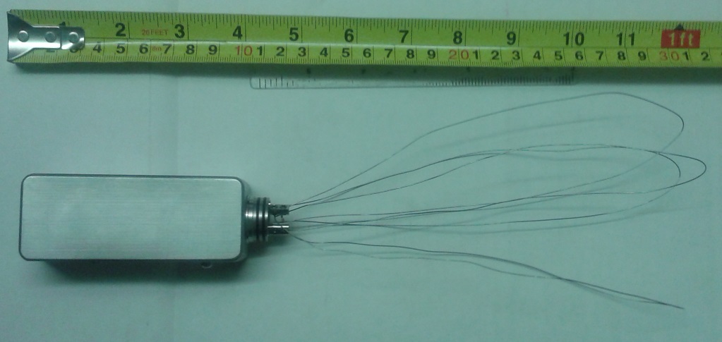

  9. It depends on the wattage you run the test at, at 40 W this with 4 parallel loops of 0.5 mm Kanthal was fine, I suspect it could handle a fair bit more. Just don't leave it unattended and if it is getting too hot stop.
