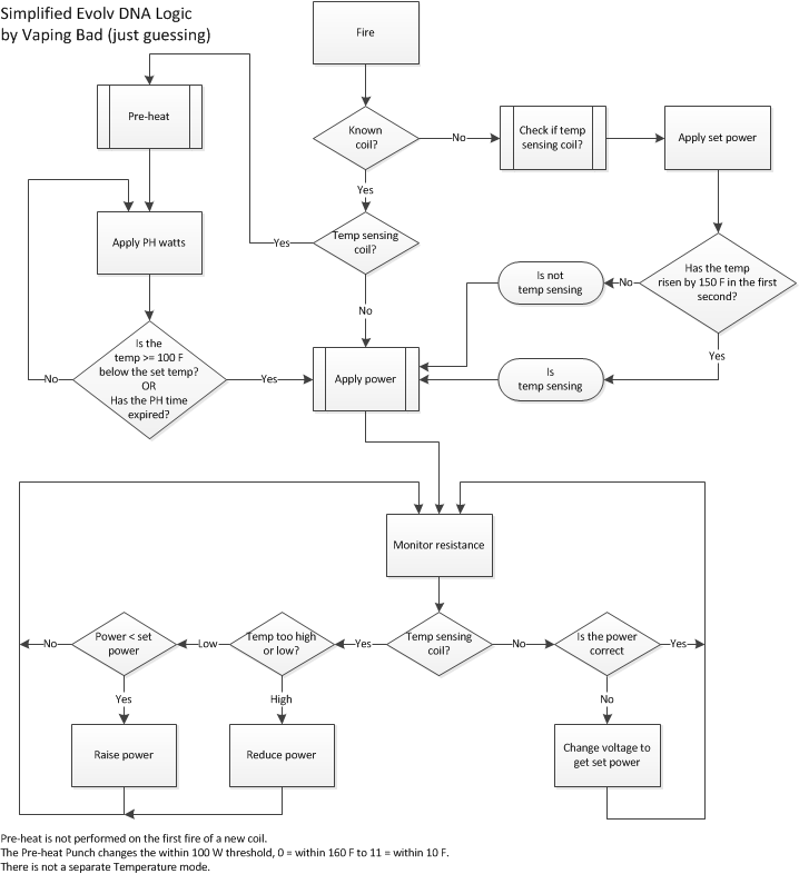

Technical explanation of preheat?
VapingBad replied to josh's topic in EScribe, Software and Firmware

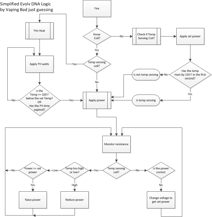

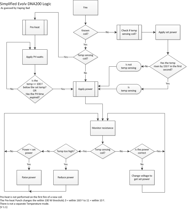

I have just spotted an error on the temp limiting section the decision "Temp too high or low?" should just be "Temp too high?" and the "low" path should be "No" and the "High" should be "Yes". I will change it and repost. -
Hey VB.. you spying on me through my web cam?? I was working on the exact same thing last week while trying to explain to a friend of mine how the DNA works. I must admit yours is much better laid out than my first effort, great job mate [/QUOTE] You may think that, I couldn't possibly comment -
Try them out in device monitor and see, you should see the pre-heat stopping quicker with the punch lower, but there are so many variables you may need to adjust power and temp to make the plot easier to read. -
Power = heat, then that heat is applied to something and depending on many things like it mass and it's current temperature the temperature will rise. EG 100 W for 1 s into a small single coil would get to a higher temp than in big dual coils. -
Punch is how "aggressive" or close to you set temperature it will go and maybe how quick it will ramp up. The PH will increase the power up to the PH power setting until the time limit is reached or the temperature reaches the threshold set in the Punch, whichevery happens first. The default threshold was 100 F below your set temperature on the 40 and looks the same on the 200. -
