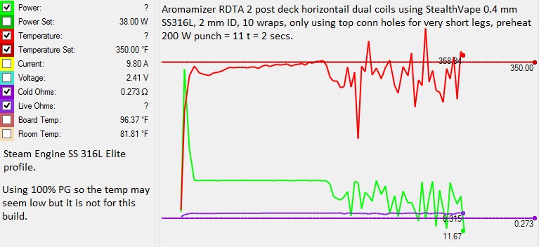

Until the 200 get the update to improve ss I find the best approach is to use preheat to get to temp and set the wattage to maintain the temp just below the limit. This show that for the first half of the vape, then I let it go above the limit to show the difference. When the update comes you will get a smooth line like the DNA 75 with ss.

Turn the temp up and or use a coil with more contact area, ss is the hardest wire to get used to temp limiting so trust your senses and experience as a vaper to home in on the settings that suit you. Just for completeness insufficient airflow and wicking both cause the temp limit to cut in.
