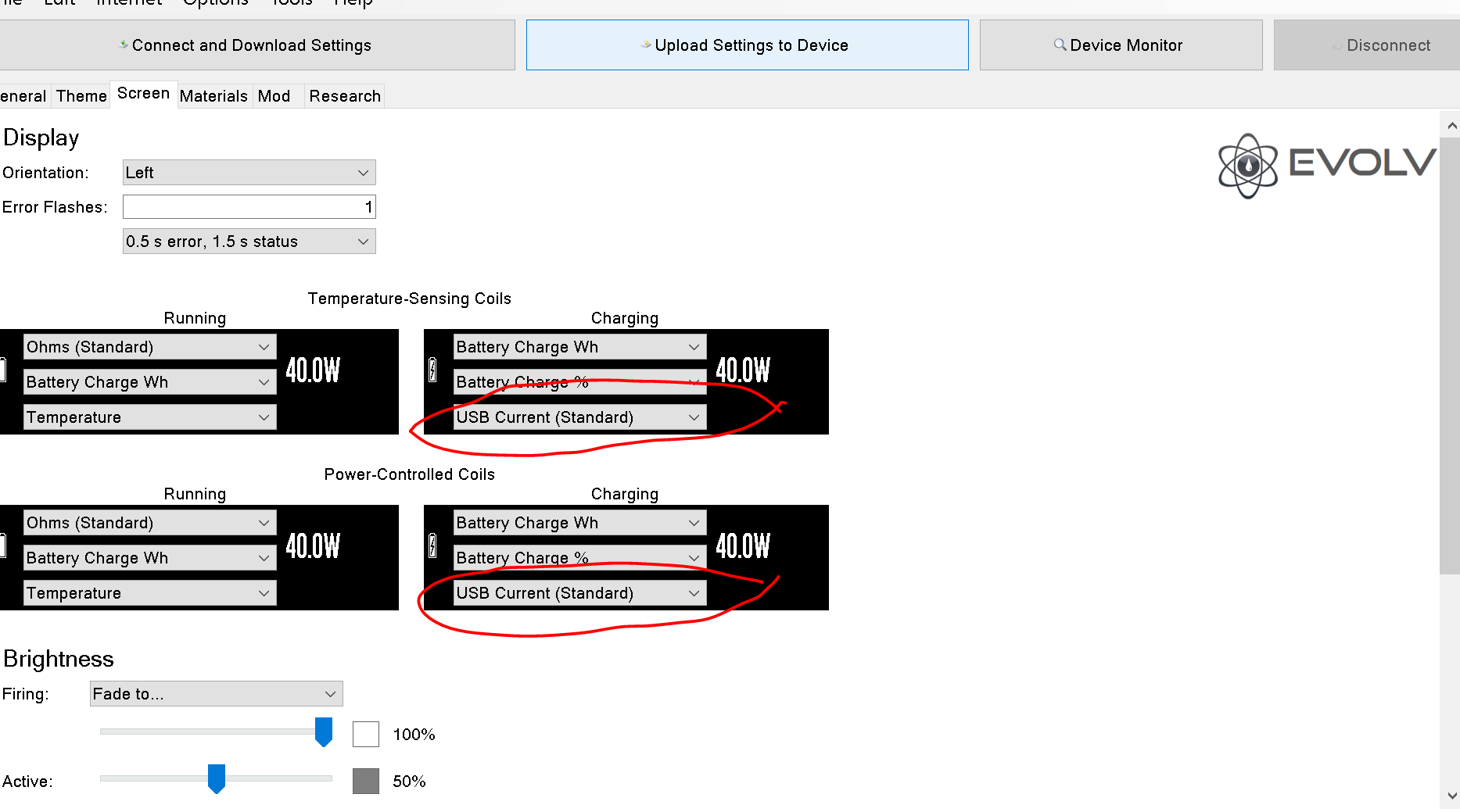

welcome rabidka! your dna 133 is not charging the batteries? is that your problem? you have everything set correctly in escribe and the wiring appears correct as well. one area that concerns me is, it says you're drawing over 3.082 amps from the USB. USB current when connected to escribe should not be over 0.5 - 1.0 amps. (depending on the type of USB port, i think) what does the dna 133 mod screen say the USB current is? if you select "USB current" under "screen" tab in escribe and "upload to device". what does mod screen say, how much USB current? i hope you can understand what i'm trying to say.
