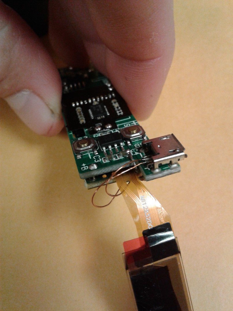

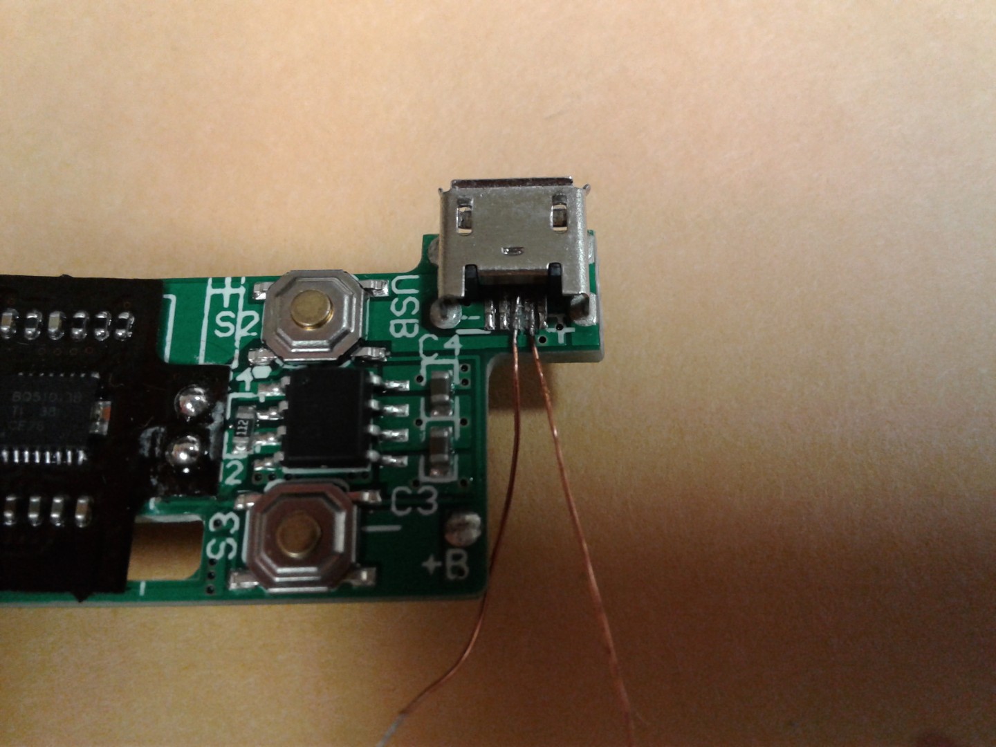

  8. i soldered very thin enamel coated copper wire directly to the usb data+ and data- pinouts. the 2 amp charging, QI wireless charging, reverse battery buzzer, etc. all work.
