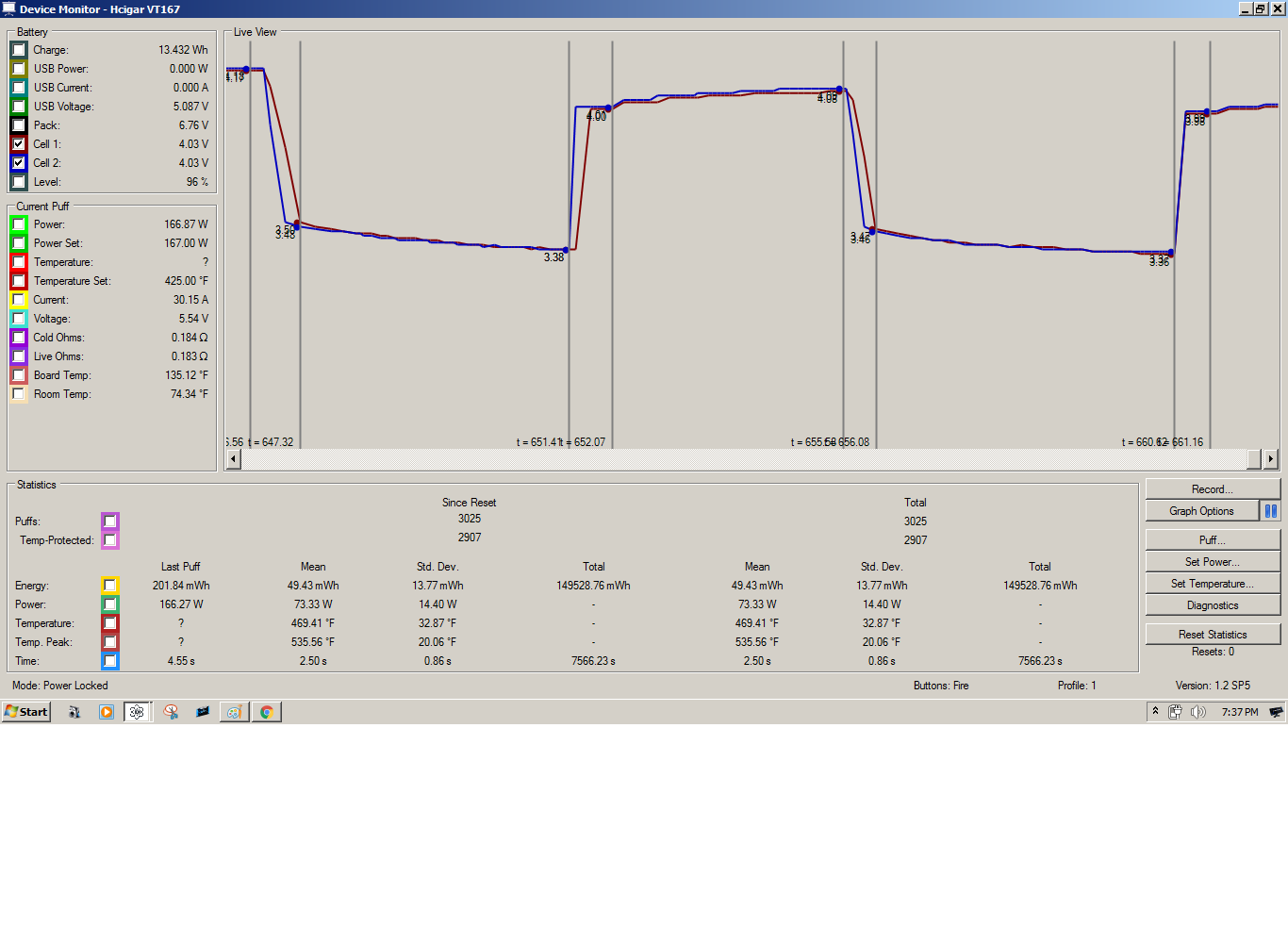

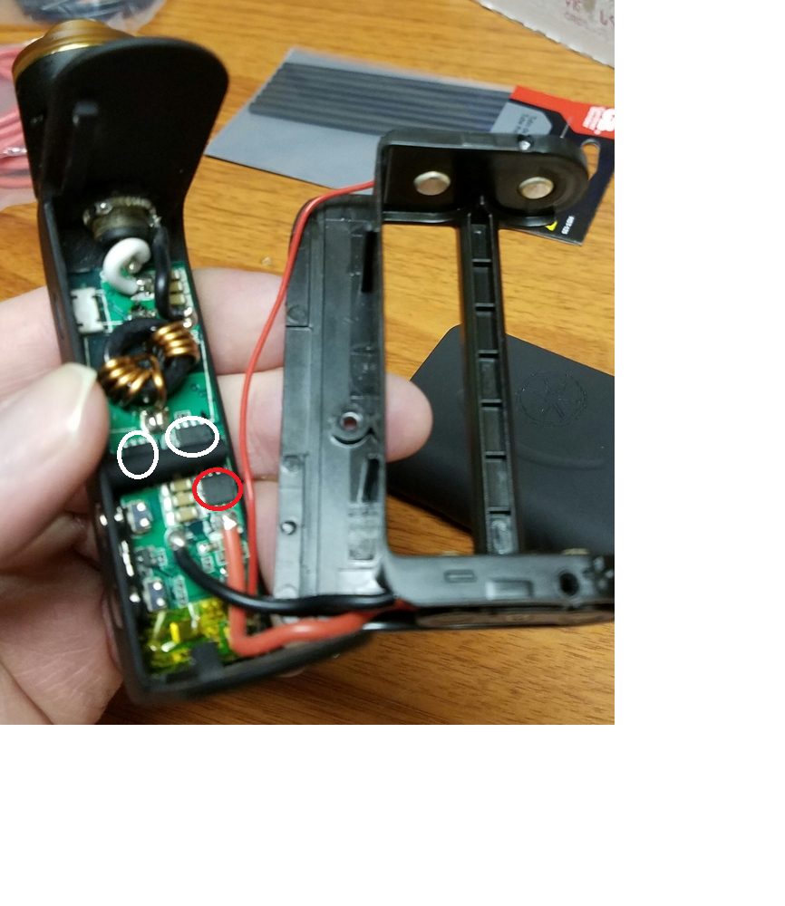

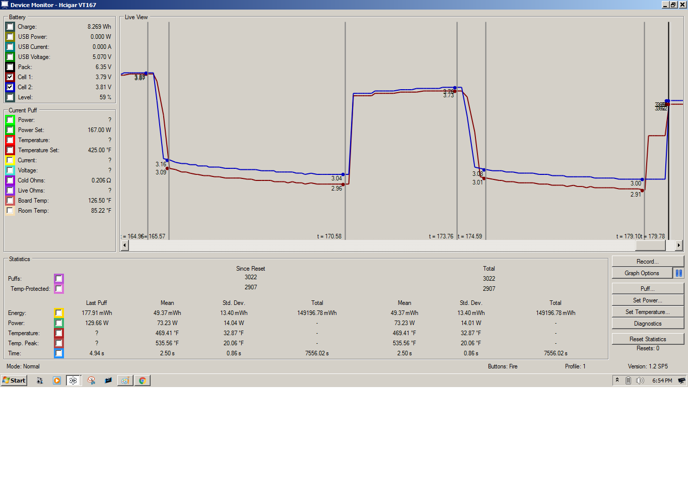

the mosfet circled in red is the reverse batt protection. the 2 circled in white are switching mosfets responsible for converting the battery voltage into usable atty voltage. looking at your pic, it's a synchronous buck topology. same as the DNA 200/250. except the DNA has 2 inductors (coil thingies) and 4 switching mosfets. this is what gives the DNA 200/250 a 97% efficiency rating and lets the board run cooler at high wattage. it's super hard to see your solder joints in you DIY 250 from those pics. i'm not expecting you to rip it apart, but it you may want to closely inspect your joints to make sure they're solid. i always double check my joints with a lighted magnifying glass. you'd be surprised at a joint you thought looked fine with just your eyeball holes, only to find out it's super sketch up close and under magnification. obviously the way you wired it is fine, it IS working. when you get a chance, post a screenshot of DM with the batt sag (make sure only cell 1-2 boxes are ticked. DM tends to run faster with less boxes ticked. at least on my garbage PC.). here are a couple shots of DM using my DNA 167 using 2 yr old sony vtc4 (3.8v resting) cells at around 120 watts. here's with charged vtc5a's at the full 167w
