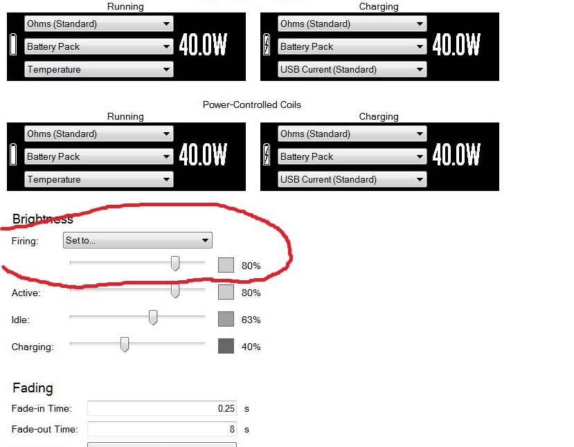

  1. Well it appears not to work, I can get it to only display 0's, thought a first it was full charged so I ran it down some and still 0's
  2. Gee I had to look, it's there under the screen tab in the charging fields. It took a moment to switch from temp to current on the mods's screen but it works. It does't show device monitor though only on the mod's screen.

  9. A couple things besides something wrong with the board. Have you tried using a different cable? In EScribe, device monitor, diagnostics tab there is the ability to set, turn on/off charging...can you check that it is set to charge? Also is battery set to LiPo and not power supply?

  17. To me #6 - 11 on the list are candidates for the Hana 200
  18. My laptop has 3 usb ports, one is integrated with an eSATA port. With a power only cable I got .5 amp with one, .8 amp with the other and 1 amp from the one that's integrated. With a data cable it's .5 max on all three. Oh, I checked the cable using a 1 amp wall wart and it can due 1 amp OK.
