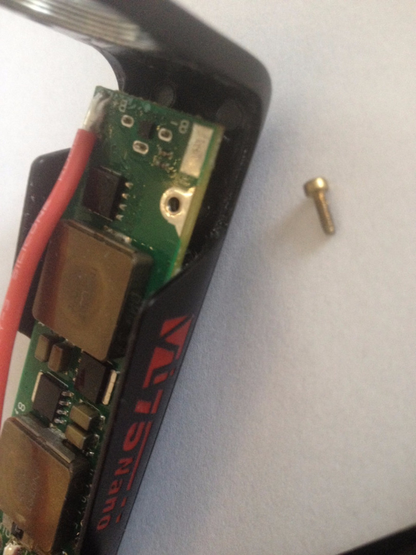

There have been issues with other devices that utilize the same type of battery setup as yours, screw on cap on the bottom, where the ground is transferred to the board via the device case & loose board mount screws are causing problems...
