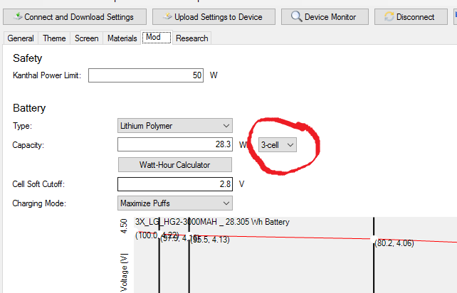

Device monitor is showing 3 cells & that is a 2 cell device. Try going into the 'Mod' tab in Escribe & set the device to 2 cell in the battery settings...then upload to device....see if that gets it working

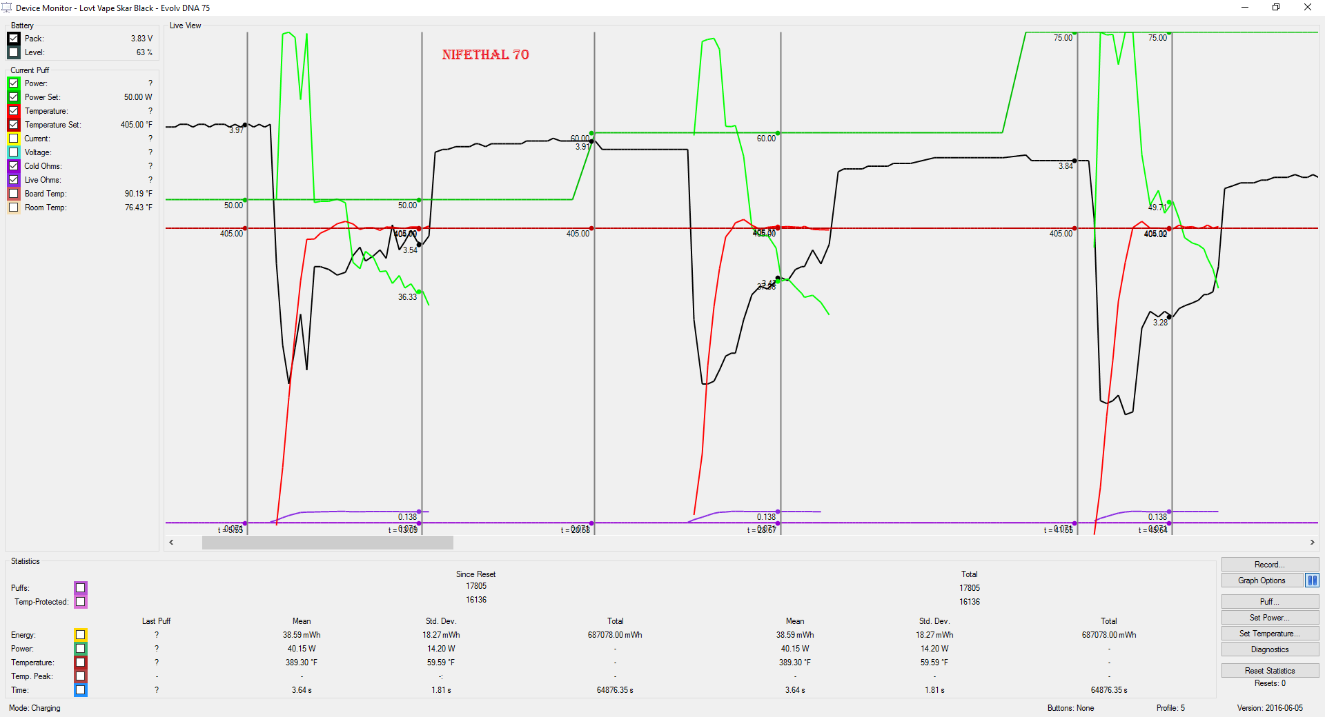

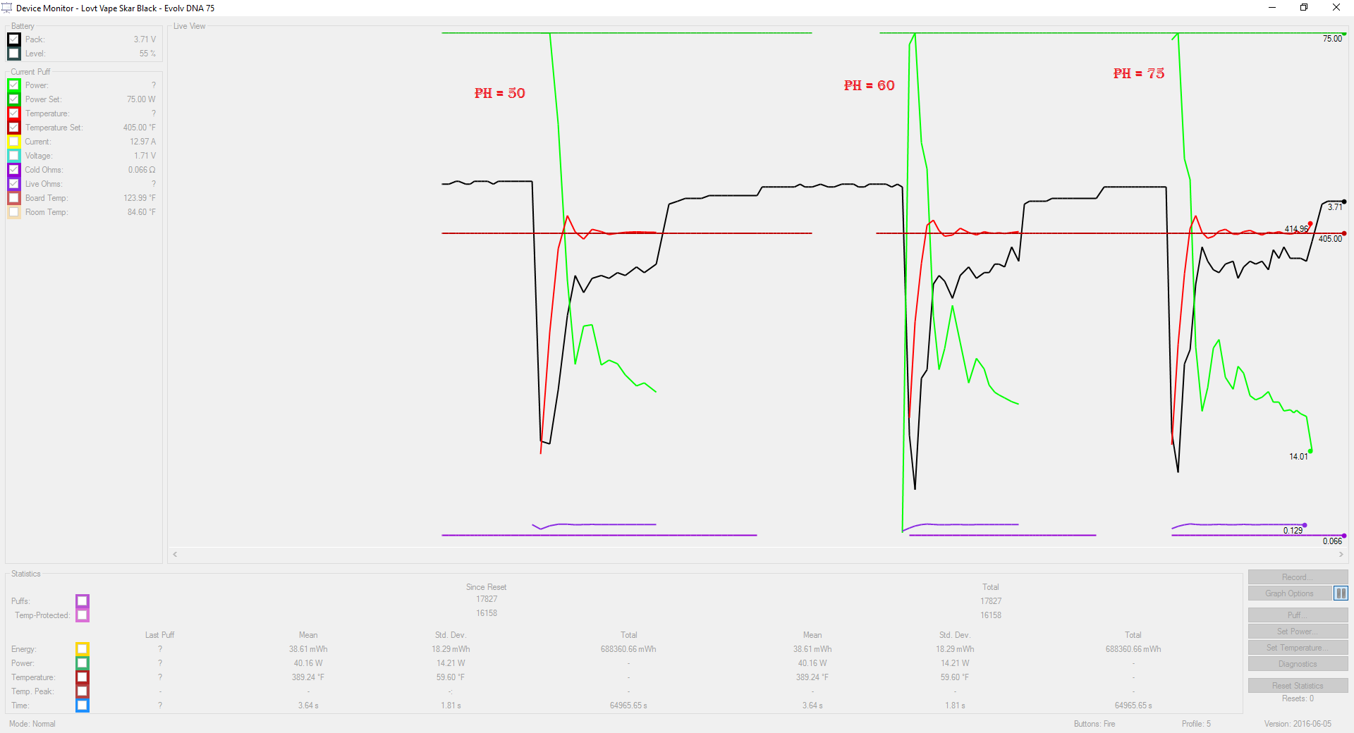

That's probably true with 316L, but I have found that with Nifethal 70, which I use exclusively & which has a much lower resistivity than SS, if I lower the SET power below the preheat power, it takes slightly longer to reach temp. On the these screenshots, the preheat in all puffs is set at 75...but I could be missing something & it wouldn't be the first time... The last screenshot is changing the preheat power settings... CHANGING POWER (WATT) SETTING CHANGING PREHEAT POWER SETTING

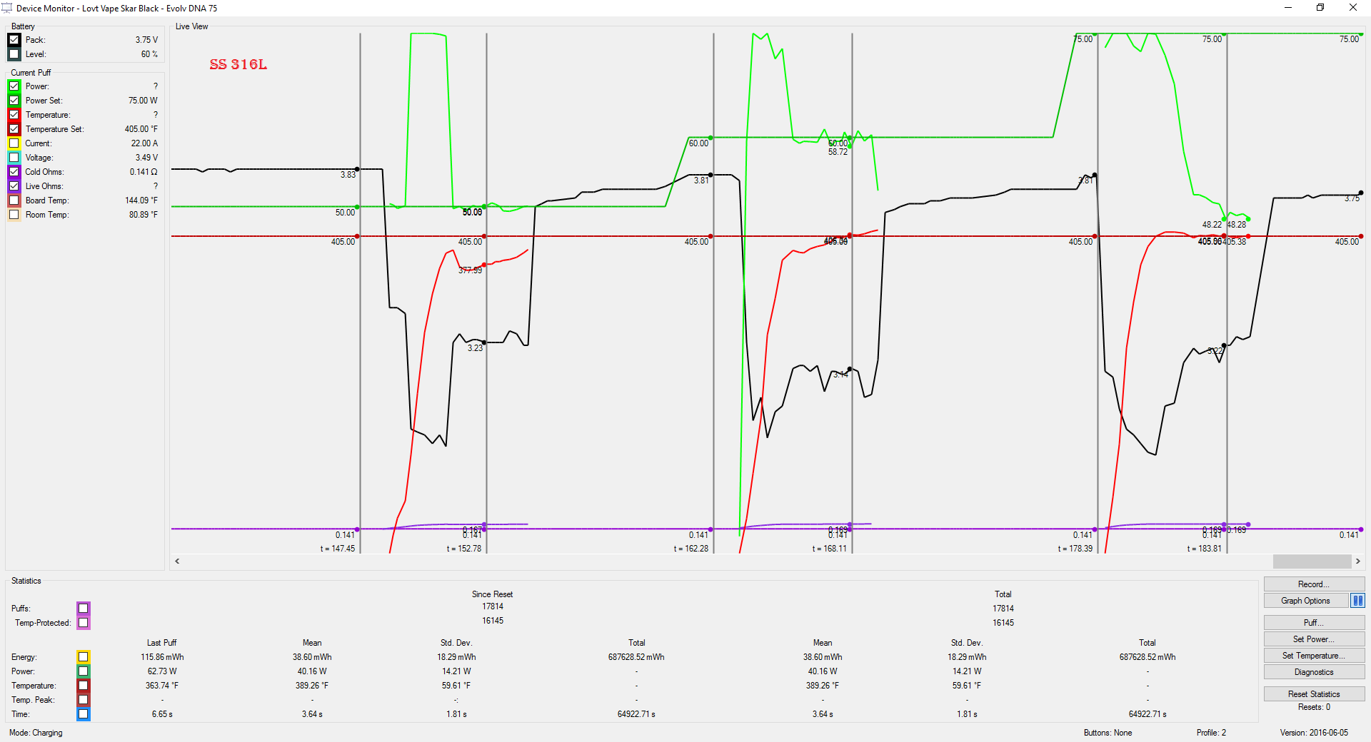

And when you get a chance, what I was asking for, as @Wayneo so pointed out, was a screen shot of the wire profile/settings for the 316L in the 'General Tab'...power,punch, yada yada...
If you look at the screen shot you posted of Device Monitor, you can see the live ohms, while firing, are fluctuating, which usually means there is some sort of connection issue. I would double check you screws as well because metal can expand & contract & cause the connection to become loose...along with cleaning
