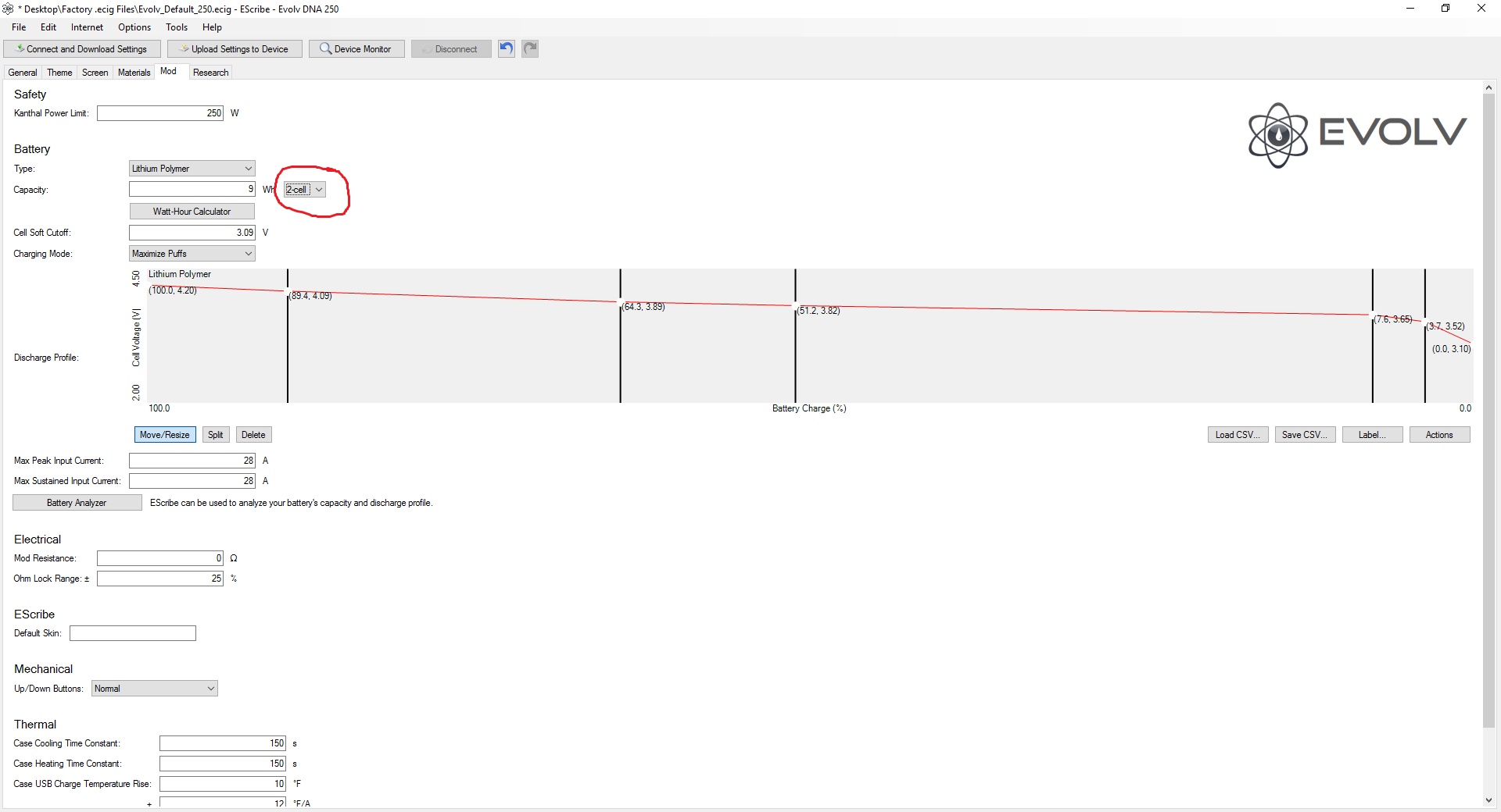

In the mod tab, set your 'Cell Soft Cutoff' to 2.8v...looks like you either have a weak cell (#1) that is hitting the cutoff, or you have a battery connection issue....might want to try a new set of batteries & keep them married...

Device Monitor is showing 3 cells when it is a 2 cell device..in the 'Mod' tab, make sure it is set for 2 cells & upload to device... see if that helps...
