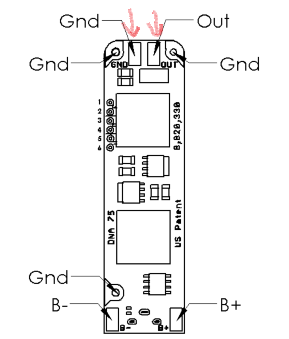

  15. If you have a meter & seems you will have it open, if you screw an atty onto the 510 connector, check for continuity between the 2 wires where they connect to the board...if no continuity is present, then the issue is on the 510 connector side....if continuity is present, then the issue is board side...

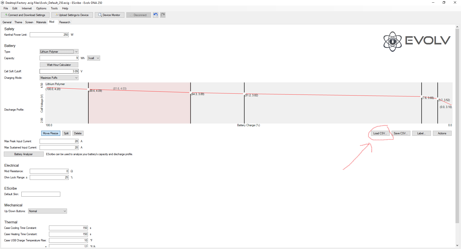

  21. I was looking over your screen shots & notice that you are using the Advanced User Interface...have you done any calibrations on the device yet? Go to 'Options>User Interface' & select 'Manufacturer' & then post another screenshot of your Mod tab... I don't think LV sends out those mods with the 'Mod Resistance' set & it is really important for proper TC...
