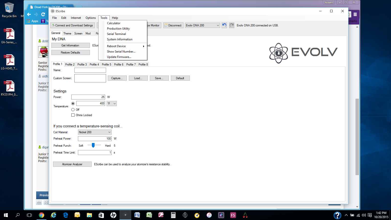

Try running EScribe and click on TOOLS/Update Firmware. Open the folder in the popup screen and pick the firmware
