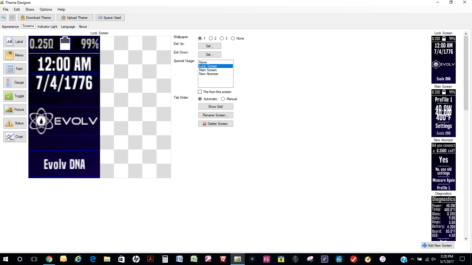

I believe you will find that Theme Designer for DNA200 is different than Theme Designer for the 75 Color.. here is a screen from the 75 Color Theme Designer....
You really should have a DNA75 Color board to use the features in Theme Designer for the 75 Color.... when hooked up to a DNA 200 you can't get to this screen (as far as I know)..... I set the increments using a DNA75 color board as seen here and the increments will change by 0.2 watts.
