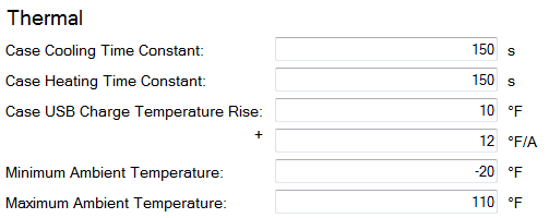

DNA 60 can't really use Thermal meaningfully, because the charging is off-board and it doesn't know much about it. The defaults should work well enough. How good is the heat sinking on your mod? The DNA 60 is a small board (half the size of DNA 75), so it gets hot, so it needs good heat sinking. Also, do you run into this in normal usage? It should be fine with how people typically vape. Certainly in testing it can get very hot. Your screenshot shows 132F, not 200F?
