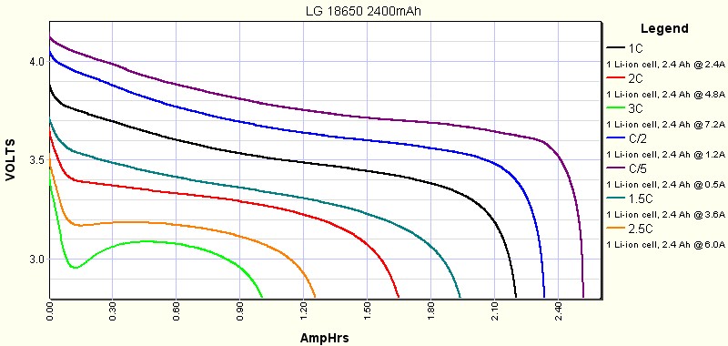

DNA devices have a Weak Battery feature, where as the battery voltage sags due to inability to deliver the desired power, it will lower its demands until the battery can meet it. So, a lower current battery may appear to work. It may, however, begin to show Weak Battery at a higher percentage of charge. This isn't a failure on the device's part -- the battery just can't deliver. (As an aside, many people lower their Soft Cell Cutoff thinking it will give them more battery life. This is lowering Voltage 5-10% to increase Current hours by 2%. Nobody is vaping Current. Power is Voltage x Current.) A good, high current battery will cost $7-8 these days, while a lower current battery will cost about $5, and a horrible battery will cost about $3. So up-front a high current battery will cost about $3 more each. Keep in mind, though, vaping is a fairly high power pulsed load for a battery. Let's look at two batteries... (1) Samsung INR18650-25R is a 2500 mAh battery, and will give you 2400 mAh at 30A. (See page 9 of the datasheet I've attached: INR18650-25R-datasheet.pdf) It's a power tool battery. (2) I found this on Google Image Search for 18650 battery. No idea what battery it is, but judging by the appalling current, it's clearly prehistoric. Probably $2 on eBay these days: If you vape three of these in a DNA 250, you might get 60W, and you'll get under half the rated capacity. This is rated at 2400 mAh. And that's not wrong. It's just a flashlight battery. When you vape up near a battery's limit, it's going to be generating a lot more heat. This is lost power. The battery may also have reduced cycle life, meaning it will lose the capacity it does have more quickly as the year goes by. So you'll have to get a new one sooner, and then you haven't saved money. Underspecified batteries are a false economy. For vaping, you want a power tool battery, not a flashlight battery. For a DNA 75, by the way, due to it being 1-cell instead of 3-cell, the battery needs to deliver three times as much current for the same power setpoint. So for 75W (or 75W preheat at a lower power), you need a really good battery.
