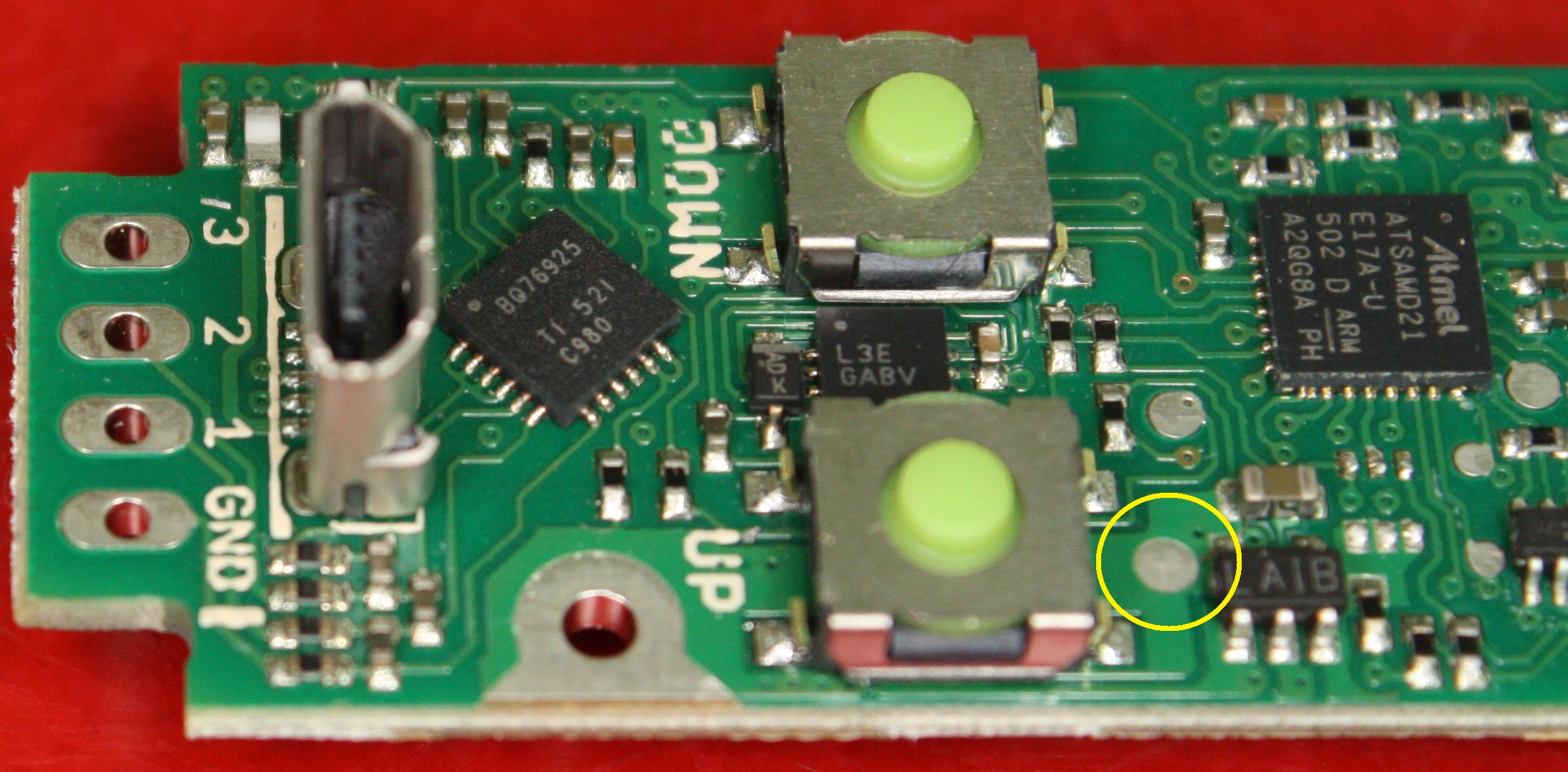

  12. Well that isn't wild. What is your core voltage reading? (see circled pad)
  13. Wow, 1.534V! What is your battery reading? (With a multimeter.) Against the case... Mm, doing that would definitely pop the fuse.
