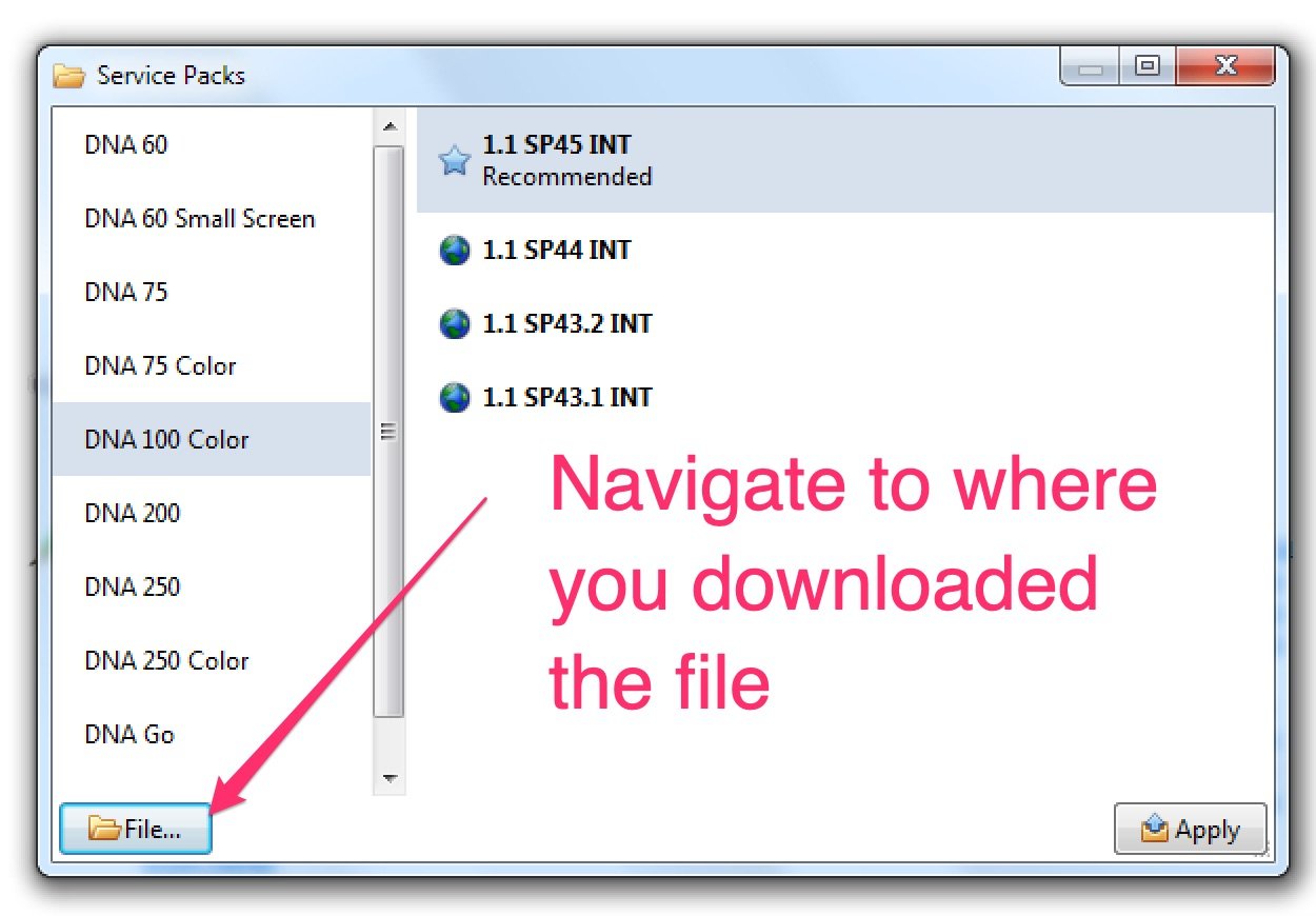

Wayneo Posted August 25, 2021 Report Posted August 25, 2021 OR, even easier, TO ME Start escribe, then Tools -> Apply service Pack Then Navigate to where it is right now, by clicking on the folder at the bottom left. Then Apply, over on the right 2
Wayneo Posted August 25, 2021 Report Posted August 25, 2021 @AngeloS, Seeing as you're brand spanking new, and I don't know what's on your mod.With mod unplugged install SP27 on your PC. It's ~55Mb. That will install the full escribe suite. Found here https://downloads.evolvapor.com/SetupEScribe2_SP27_INT_ServicePack.exe Plug in mod, you should hear a sound that your PC sees the device, then start escribe. Ideally you'll see a message there's an update available, click that. Update firmware to SP45 as shown in the graphic above. Click "Apply" Then install this new update. There's no need to worry, escribe always makes backups of its config every time your mod is plugged in and you start escribe. Yes, you can always go back and restore from any of them escribe suite SP numbers and mod firmware updates SP numbers are always different. 1 1
