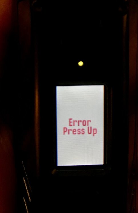

nibo Posted February 9, 2019 Report Posted February 9, 2019 Hello, I own a new Triade Mod from Lost Vape. I do get the message „error, press up“ after some minutes of not using it and pressing the fire button. I have choosen a standby time via escribe of 15 minutes. So when I put the mod away after vaping and I want to fire again after eg 5 minutes, the message comes up. I have updated the mod too, but still the same issue. Hope somebody can help me.

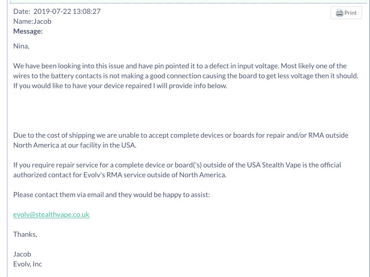

nibo Posted July 22, 2019 Author Report Posted July 22, 2019 Now I have a final answer. Not really satisfying, but an explanation.
Wayneo Posted July 22, 2019 Report Posted July 22, 2019 What's not to like @nibo The soldering to their board needs repairing, and being in the EU, you've been given an EU authorized repair shop. Probably cheaper shipping for you, less customs and duties issues? No? 1

lordmage Posted August 4, 2019 Report Posted August 4, 2019 On 7/22/2019 at 3:33 PM, Wayneo said: What's not to like @nibo The soldering to their board needs repairing, and being in the EU, you've been given an EU authorized repair shop. Probably cheaper shipping for you, less customs and duties issues? No? so does @nibopost above mean i should send my device in for repair if sp38 gives me the press up error paranormal 250C i have to sat on sp33 as noted above to not experience it
