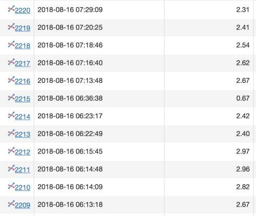

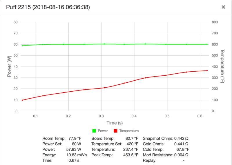

Wayneo Posted August 23, 2018 Report Posted August 23, 2018 (edited) @retird and @SirTimmyTimbit and @joeblowma I can attest to what Joe wrote. I'm using a modified evolv theme. On my mod, I'm TC only. Around 5% of the time, usually around .7 seconds, all power to the mod is cut and Temp Protected shown on the screen. From my 1st pic, look at 'Peak' Temp value, although it's not displayed by the graph. The 510 soldering has been checked. I've been using this atty for months with no issues on regular DNAs (75, 200, 250). Temp set at 420F, Peak temp 453F shown below. The second image (puff 2215) shows before and after successful operation if you look at the puff times. I don't think any of you guys are crazy. The power, once the coil is coming up to temp, never lowers, so if the puff were to continue, It would overshoot. Edited August 23, 2018 by Wayneo Move text around 2
