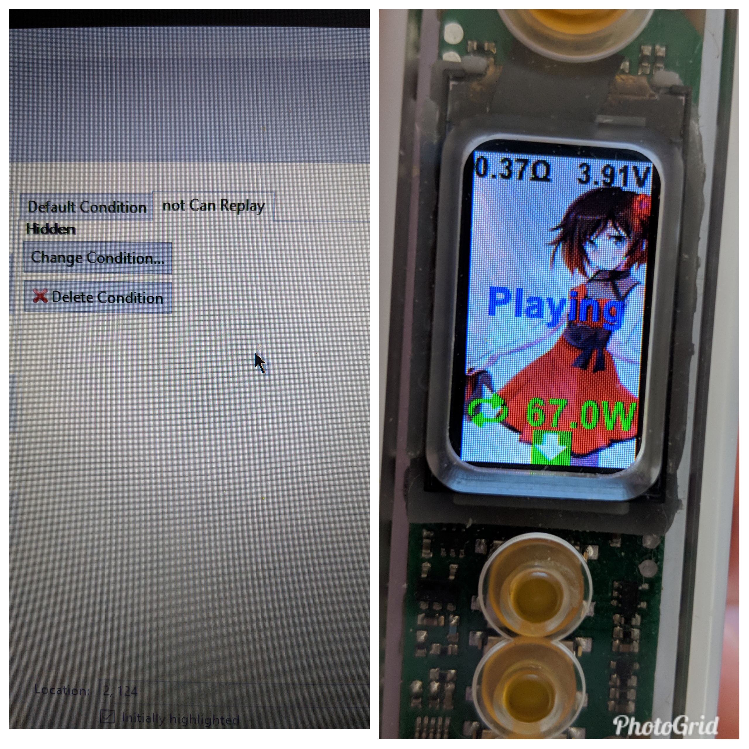

T.A.Nettles,V Posted April 29, 2018 Report Posted April 29, 2018 Have I gotten this to work correctly on power mode? I didn't think it was possible, I just went back to my watts profile and noticed the icon was visible, so I clicked it and it worked! (Little green loop icon to the left of the watts)
Kresell Posted April 29, 2018 Report Posted April 29, 2018 3 minutes ago, T.A.Nettles,V said: Have I gotten this to work correctly on power mode? I didn't think it was possible, I just went back to my watts profile and noticed the icon was visible, so I clicked it and it worked! (Little green loop icon to the left of the watts) It's easier if you used the default theme and change the Name to Replay too.
T.A.Nettles,V Posted April 29, 2018 Report Posted April 29, 2018 I went through that yesterday.. added the replay features to my own theme. This isn't a Temp Sensing profile.. I realize now that the toggle is hidden only when "Not Can Replay NOW" is the condition, not "Not Can Replay", but if it's set to the latter, I hit it and it seems to be working

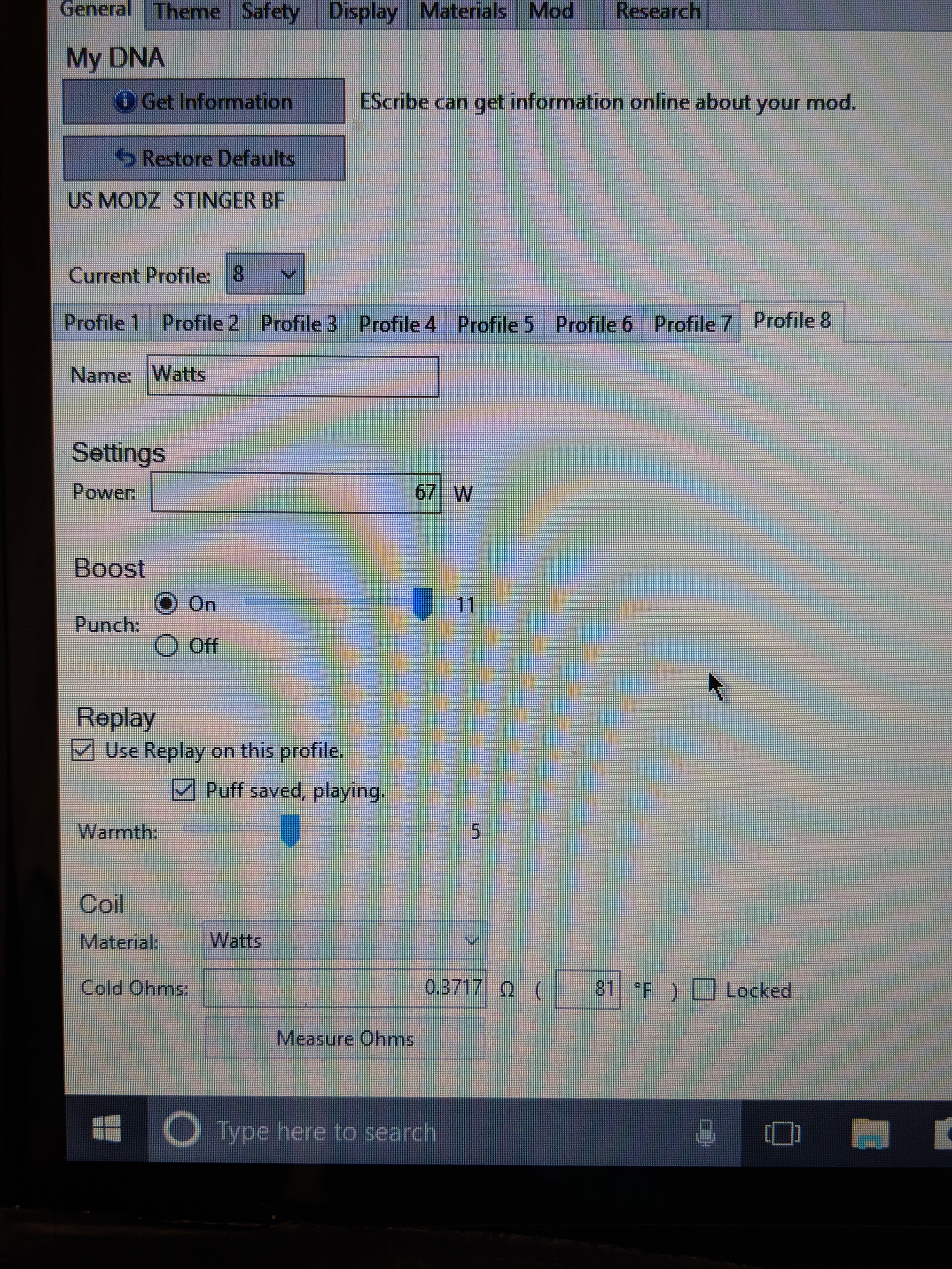

Rburke2x Posted April 30, 2018 Report Posted April 30, 2018 I can't get Replay to work on my 75c. I've updated everything and gone to profile 8, clicked the "Replay" options but after applying to my mod, all I see is an empty black box under my Wattage and above the "Settings" on my screen. Can anyone help me?
Jonski Posted April 30, 2018 Report Posted April 30, 2018 35 minutes ago, Rburke2x said: I can't get Replay to work on my 75c. I've updated everything and gone to profile 8, clicked the "Replay" options but after applying to my mod, all I see is an empty black box under my Wattage and above the "Settings" on my screen. Can anyone help me? What wire are you using ? 1
Rburke2x Posted April 30, 2018 Report Posted April 30, 2018 59 minutes ago, Jonski said: What wire are you using ? SS316
Jonski Posted April 30, 2018 Report Posted April 30, 2018 5 minutes ago, Rburke2x said: SS316 And the mod sees the atomizer and reads the ohms right ? What happens when you take a puff ?
Rburke2x Posted April 30, 2018 Report Posted April 30, 2018 6 minutes ago, Jonski said: And the mod sees the atomizer and reads the ohms right ? What happens when you take a puff ? Works as usual but I don’t get the Replay option, either to save puff or to replay.
Jonski Posted April 30, 2018 Report Posted April 30, 2018 Sorry for asking all the obvious question . You updated the mod to the latest firmware ? you are using the Evolve default theme ? What atty are you using ? , I saw some saying they were having trouble if it had a catch cup or beauty ring .
