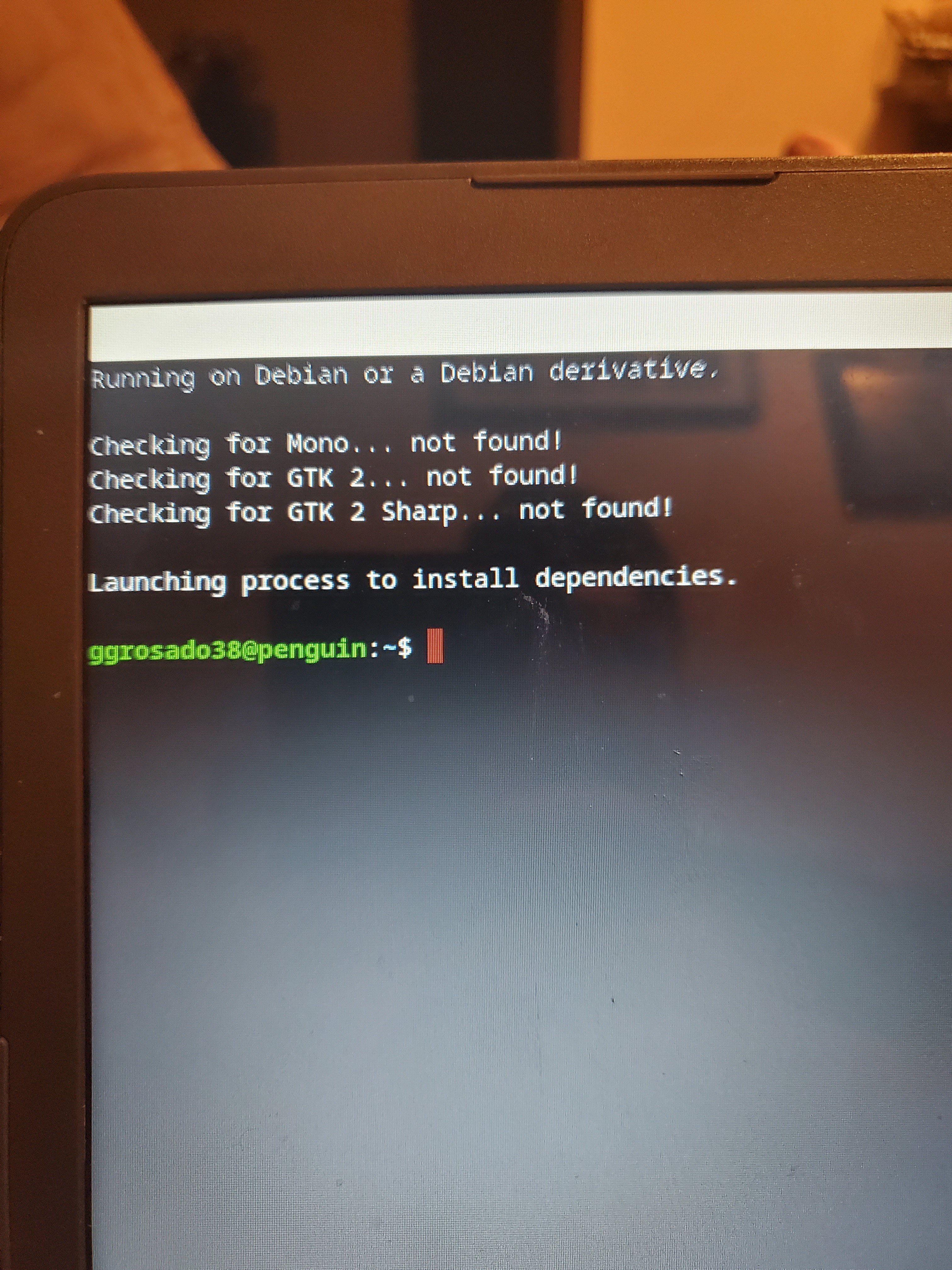

Podunk Steam Posted April 19, 2020 Report Posted April 19, 2020 (edited) 17 minutes ago, Gilbertrican90 said: I'm on debian does that make a difference As I've mentioned I'm no Linux guru, I'm trying to install on Linux MX and it's Debian based so maybe? it seems the terminal is where I keep bumping my head. IDK, I input "apt-get install SetupEScribe2_SP19_INT.run" and I get this Reading package lists... Done Building dependency tree Reading state information... Done E: Unable to locate package SetupEScribe2_SP19_INT.run E: Couldn't find any package by glob 'SetupEScribe2_SP19_INT.run' E: Couldn't find any package by regex 'SetupEScribe2_SP19_INT.run' Edited April 19, 2020 by Podunk Steam

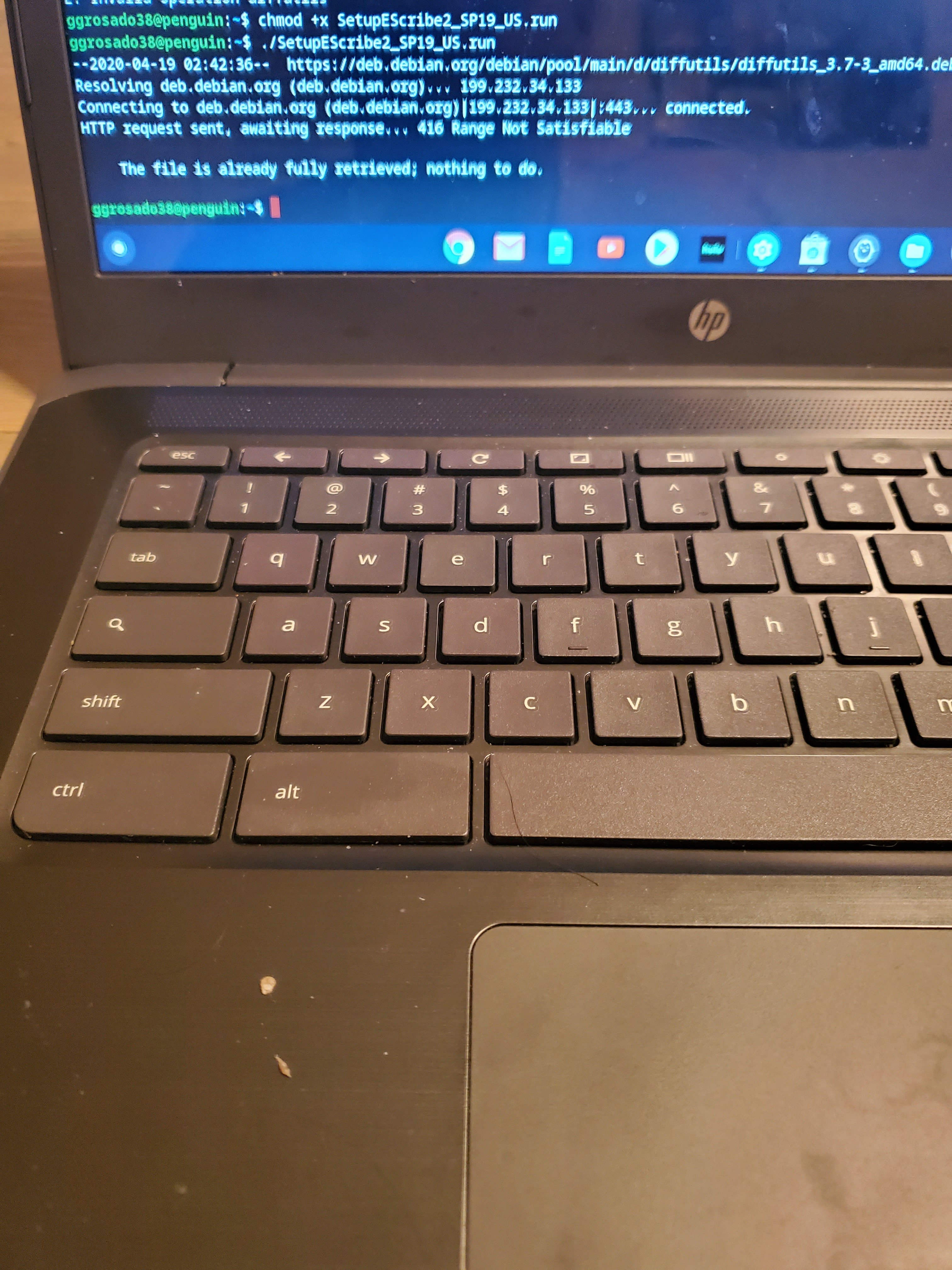

Ak89 Posted April 19, 2020 Report Posted April 19, 2020 (edited) It has been a while since I used escribe on Linux, but if I remember right the *.run file is a script to install. You wont use apt. (Unless something has massively changed) It can be used for any missing dependencies, but not for the actual install. Try using "chmod +x" on the file then running it as an executable. Edit: I used minus x instead of plus x. Edited April 19, 2020 by Ak89 1
Podunk Steam Posted April 19, 2020 Report Posted April 19, 2020 (edited) 18 minutes ago, Ak89 said: It has been a while since I used escribe on Linux, but if I remember right the *.run file is a script to install. You wont use apt. (Unless something has massively changed) It can be used for any missing dependencies, but not for the actual install. Try using "chmod -x" on the file then running it as an executable. Thanks! I've given the file executable permission but I'm just not doing well with the command verbiage and such. I've tried a few conbinations with your suggestion with no luck as of yet. Edit: I'm also logged in as Superuser at the moment. Edited April 19, 2020 by Podunk Steam
Ak89 Posted April 19, 2020 Report Posted April 19, 2020 As long as the file does have executable permission it should work to run it. If you are in the directory that the file was downloaded to, try "./SetupEScribe2_SP19_INT.run" (If that is what it is called: Linux is case-sensitive with everything. Not sure if your disto supports it, but tab-complete usually helps avoid simple typing mistakes) If that doesn't work, log out of the super user account. I know early on with the Linux releases there were issues and the script will error if it has superuser (or sudo) rights. As an alternative, if you are running a desktop environment, navigate to the folder (with dolphin or whatever file manager exists) and simply double click the "SetupEScribe2_SP19_INT.run" file. If executable permissions are set, it should start a gui of some form.

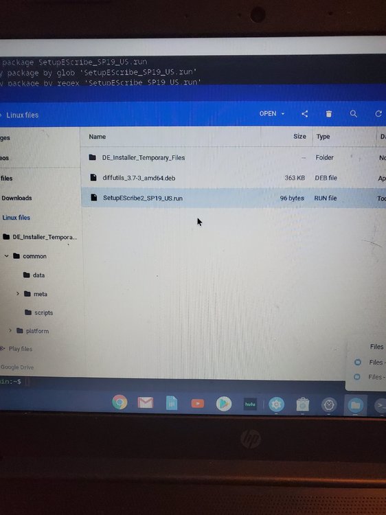

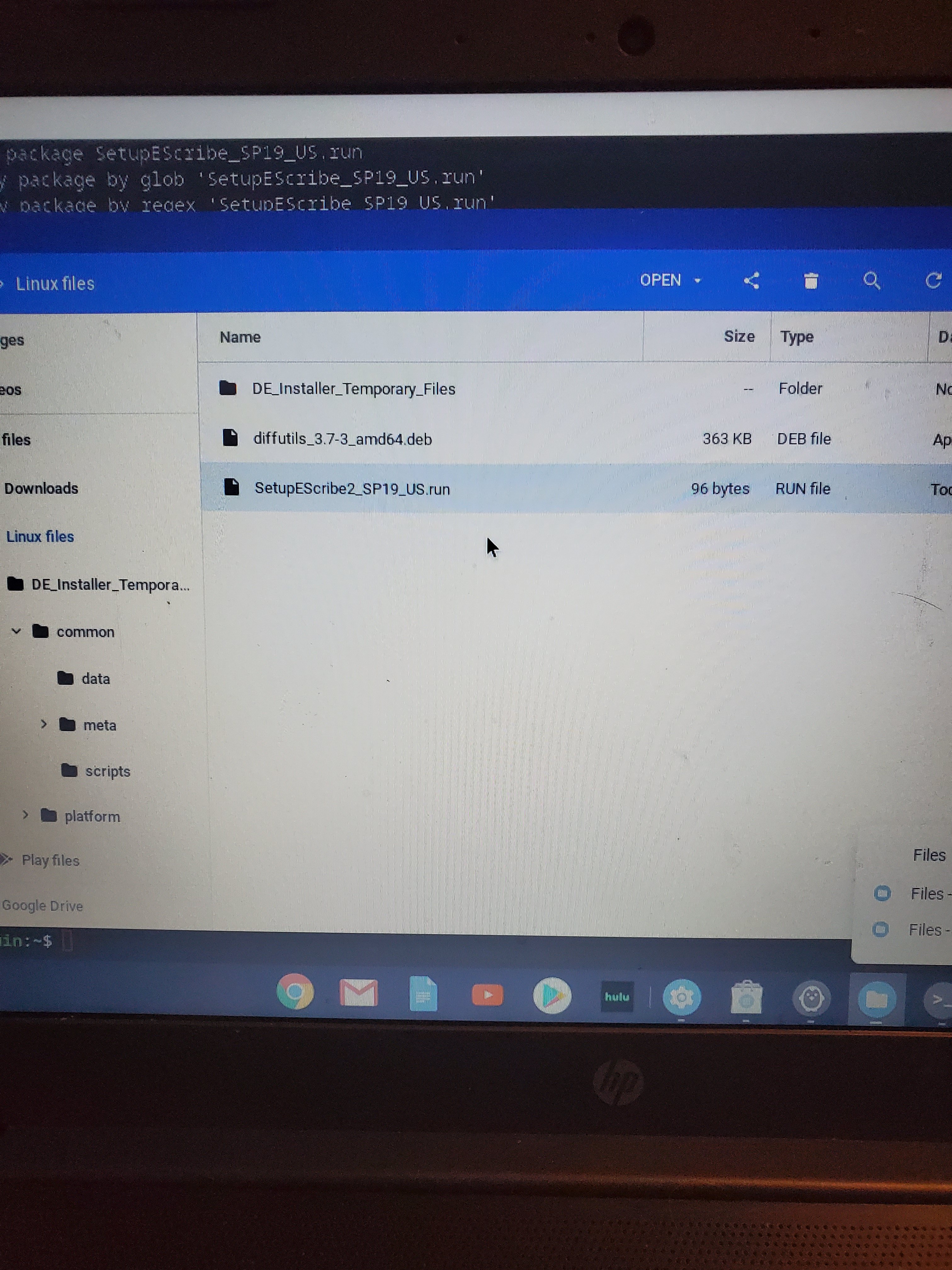

Gilbertrican90 Posted April 19, 2020 Report Posted April 19, 2020 And I have these files in my linux folder. I don't know if it means anything
Ak89 Posted April 19, 2020 Report Posted April 19, 2020 @Gilbertrican90 You may be fighting a losing battle. Linux beta on chrome book may not support usb devices. See: https://support.google.com/chromebook/answer/9145439?hl=en @Podunk Steam Linux MX has a desktop environment so terminal may not be needed at all. Right click the escribe file. Look for a permissions tab, and check for a box (or something) referring to making it executable. My earlier post about chmod requires "+x" not "-x", I mistyped and didn't catch it until I posted. It was edited immediately, but you may not have been notified... The notes you are seeing are due to permissions on the file. If it was downloaded with a su account it requires root permissions. Download the file in your standard user account to give yourself permissions to the file, and make it executable in whatever way you find easiest. (permissions can be changed as it is but it would be tricky to type everything required on my phone)
