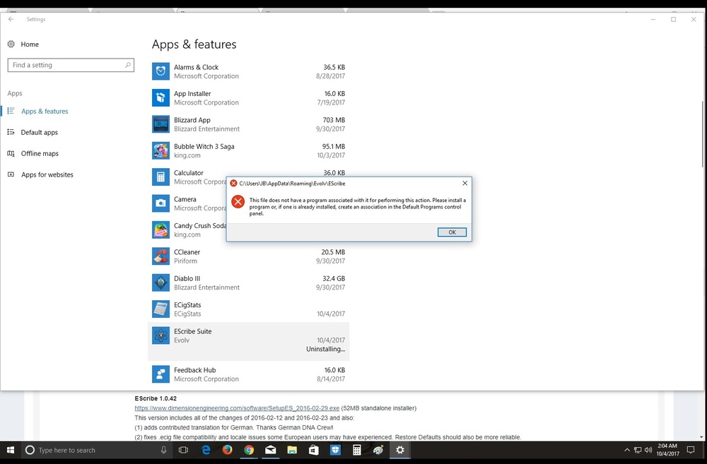

This is getting ridiculous.  Seems that the Service pack keeps updating and won't let me use an old version.  But I can't uninstall Escribe and can't even find the folder since it's under the appdata sub folder.  I'll be majorly pissed if the DNA75C mod isn't recognized when I receive it this week.

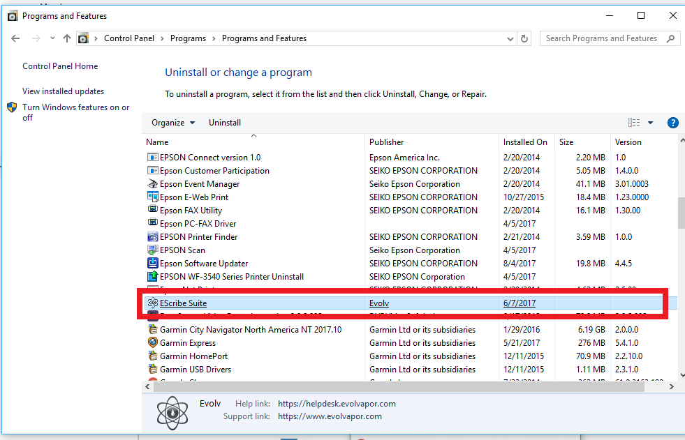

That worked using Control Panel to uninstall Escribe.  I didn't realize that Control Panel was still there, I thought the "Windows Settings" function had replaced it.
Oh yea, click off Automatic updates, doh!
Still, version 1.2 SP3 doesn't connect with those three mods.  Just so frustrating because I have used Escribe in the past with my SDNA75 mods and it does recognize one Therion BF but not the other.  Same USB port and cable will connect with my other mods and the ones not connecting to Escribe are connecting to Windows 10.
