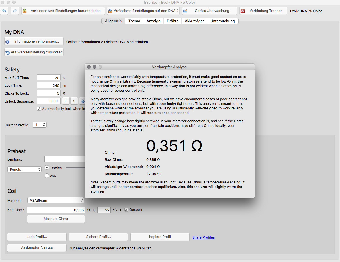

Lowbytes Posted July 13, 2017 Report Posted July 13, 2017 Hi James Beside the wrong room Temp ( seems to be 4°C too high) working accurate for me Flash E Vapor V3 - 0,37 Ohm V2A Clapton Coil manually has to be set to 0,335 reading coil resistance constant 0,351Ohm at ambient temp 27°C (real room Temp is 23°C)

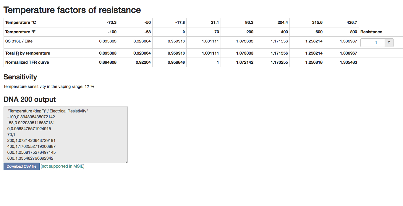

ndb Posted July 13, 2017 Report Posted July 13, 2017 For the benefit of whoever else might get tripped by this, after I sent my .ecig files to @James, he came back with a resolution that he allowed me to share here: Quote Whoa... on both of these, you don't have a standard Evolv SS316 curve. SS 316L... This is clearly based on a TCR given the number of points. I don't know if it is more wrong, but try copying SS 316 from Available Materials (that's the Evolv curve) and using that. Granted, 316 is not graded electrically, so there is always some variation (this is one of Stainless's chief problems), but... SE-316L-TFR... Which mod did this come from? We should let the manufacturer know. In fact, I should make the software give a warning on upload for this case. If the lowest point in the curve is 68F, if it ever reads lower than 68 F, it is going to give Temp Protected. This is incredibly likely as there is electrical noise and during the split-second start of firing there is a tendency for the Ohms to sample slightly low. Our curve has points at -100F and 0F as well. I imagine folks might think "nobody vapes that low, it doesn't matter", but it *does*, as the range of the material curve defines the range of Ohms it will allow. Basically I was using a steam-engine curve for 316L that was, for some reason, missing the lowest -58F point so that the curve started at 68F (maybe something got screwed up when I downloaded the csv and imported it in escribe, I don't know). This caused noise-induced errors to the measurements performed during the initial phase of firing to fall below the minimum allowed temperature of 68F, hence the temp protect error. Replacing that TFR curve with the stock 316 that comes with escribe did indeed solve the problems. Now, using the stock profile is not mandatory, the important thing is to be sure that the curve starts well below what we consider the minimum ambient temperature we'll be vaping at, to avoid initial lower readings to be considered "out-of-range". I'm not sure I've thanked James enough for finding this out... ;-)

Lowbytes Posted July 13, 2017 Report Posted July 13, 2017 vor 5 Stunden schrieb ndb: For the benefit of whoever else might get tripped by this, after I sent my .ecig files to @James, he came back with a resolution that he allowed me to share here: Basically I was using a steam-engine curve for 316L that was, for some reason, missing the lowest -58F point so that the curve started at 68F (maybe something got screwed up when I downloaded the csv and imported it in escribe, I don't know). This caused noise-induced errors to the measurements performed during the initial phase of firing to fall below the minimum allowed temperature of 68F, hence the temp protect error. Replacing that TFR curve with the stock 316 that comes with escribe did indeed solve the problems. Now, using the stock profile is not mandatory, the important thing is to be sure that the curve starts well below what we consider the minimum ambient temperature we'll be vaping at, to avoid initial lower readings to be considered "out-of-range". I'm not sure I've thanked James enough for finding this out... ;-) Then something went wrong with the download or with uploading it to the DNA75C The steam-engine TFR Curve is complete with all needed temp points
