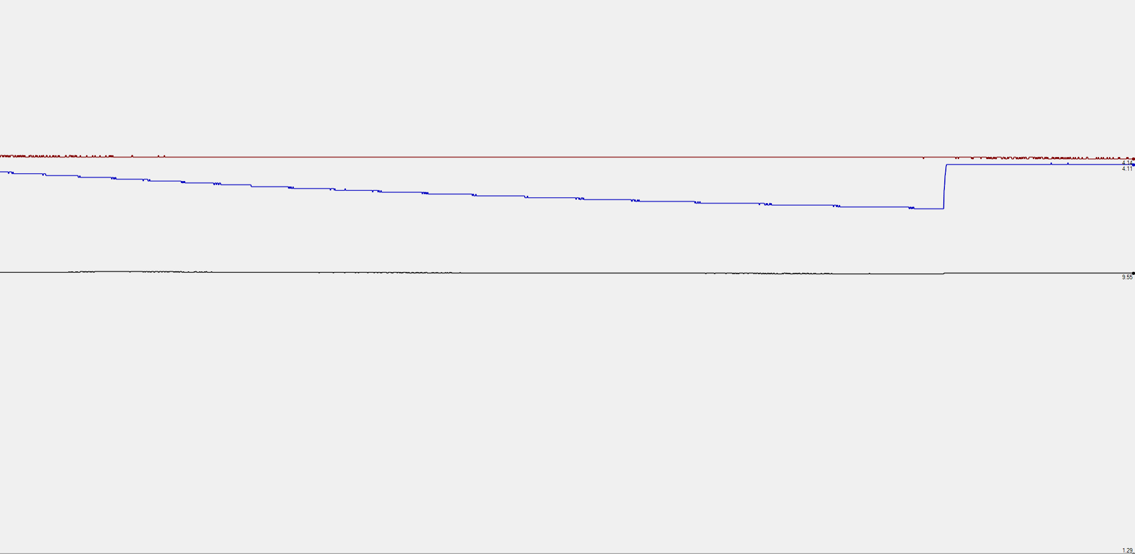

FloridaBill Posted August 4, 2015 Report Posted August 4, 2015 [CODE]If you charge it and it comes up, but then drops, I would suspect a bad pack.[/CODE]Cell 3 won't charge. Currently reading 4.19V, 4.19V, and 1.30V (cell 1,2,3). That's with it setting on the charger since my post 2 hours ago, charging display off, no tank attached.I am beginning to suspect a board issue. Cell 3 has now "stabilized" at 1.3V. During the time it was gradually dropping (even though it should have been charging), I noticed the USB current was very low, somewhere around 0.020 A and dropping as the charge on cell 3 dropped. Now that cell 3 is steady at 1.30V, the USB power and current are both showing zero (USB voltage is showing 4.766V).UPDATE: The drain is now affecting the other 2 cells. Current readings are 4.17. 4.12 and 1.29 (cells 1,2,3) (7/29 firmware)
KTMRider Posted August 4, 2015 Report Posted August 4, 2015 Sounds like a resistor for the balance port was knocked off. I had a similar issue with my first mod. I have a lipo checker and charger that both showed the battery pack was good but cell 1 on Escribe was at 1.9v. A closer inspection of the board showed one resistor was knocked off slightly (not completely off) and that was enough to show 1 bad cell. I had a 2nd board so I swapped it out and it worked perfectly. I would try to work with Evolv. I'm still trying to get a replacement screen from Hana and they seem to respond only once a day and it's usually "have you checked to see if your MOD is not in Stealth mode?" or "would you like to send it in for our technicians to look at it?" when I told them I already fixed it and just need a replacement screen. I'm not a fan of Hana so far.

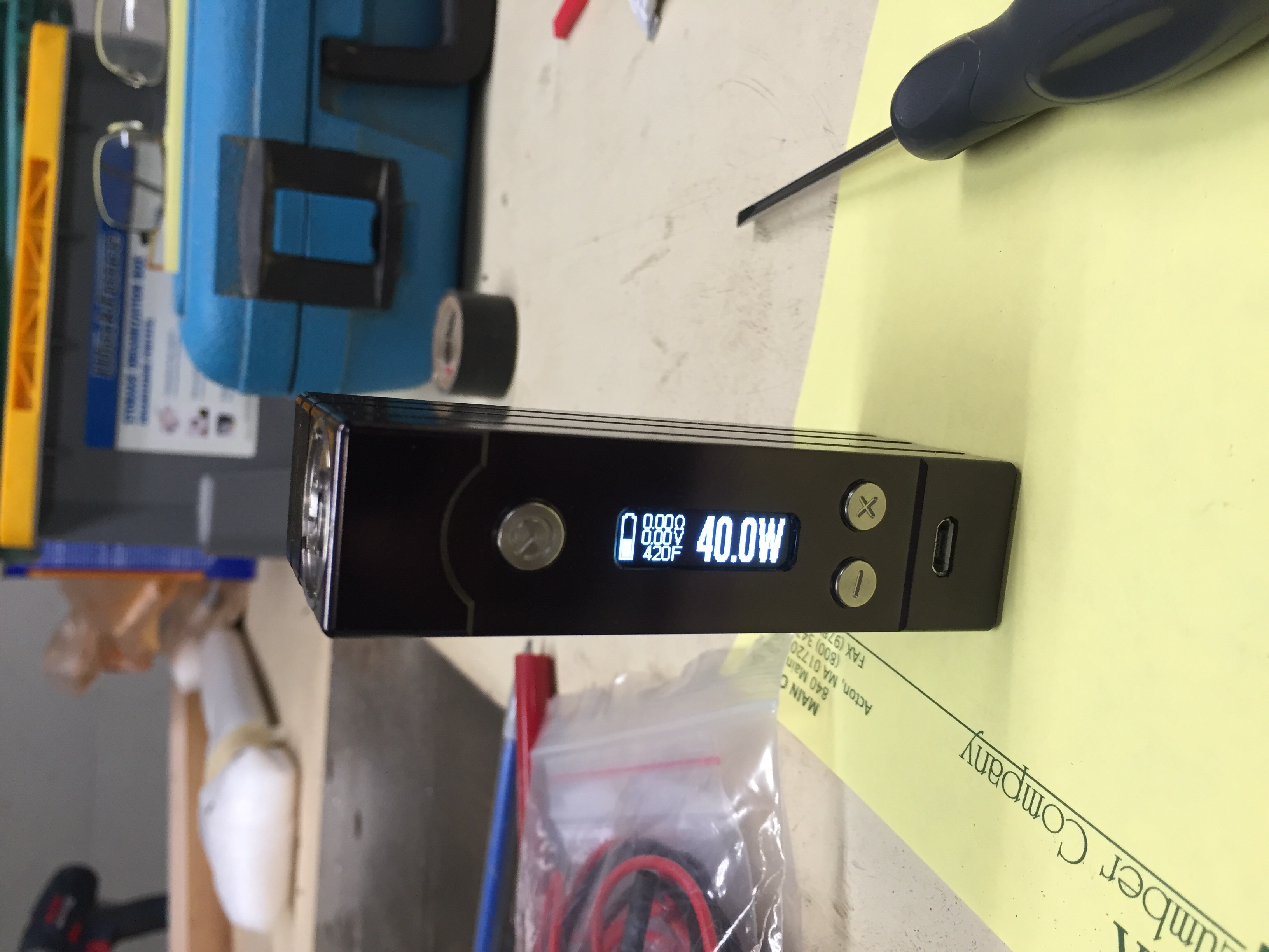

Tomr1088 Posted August 4, 2015 Report Posted August 4, 2015 Yessss. Fixed my screen with one from another board that just arrived. Also added bullet connectors I took out of an xt30. Was a tight fit but in the end it wasn't much different space wise as the jst. Hopefully now there's no issues. Also lined the side of the lipo against the board and 510 with some thick rubber electrical tape.

FloridaBill Posted August 4, 2015 Report Posted August 4, 2015 Yea, definitely looking more like a board issue. Even more puzzling, looking at the attached chart (2400 sec time frame) you will see that cell 2 was doing a long sustained drop and then suddenly jumped back up.
