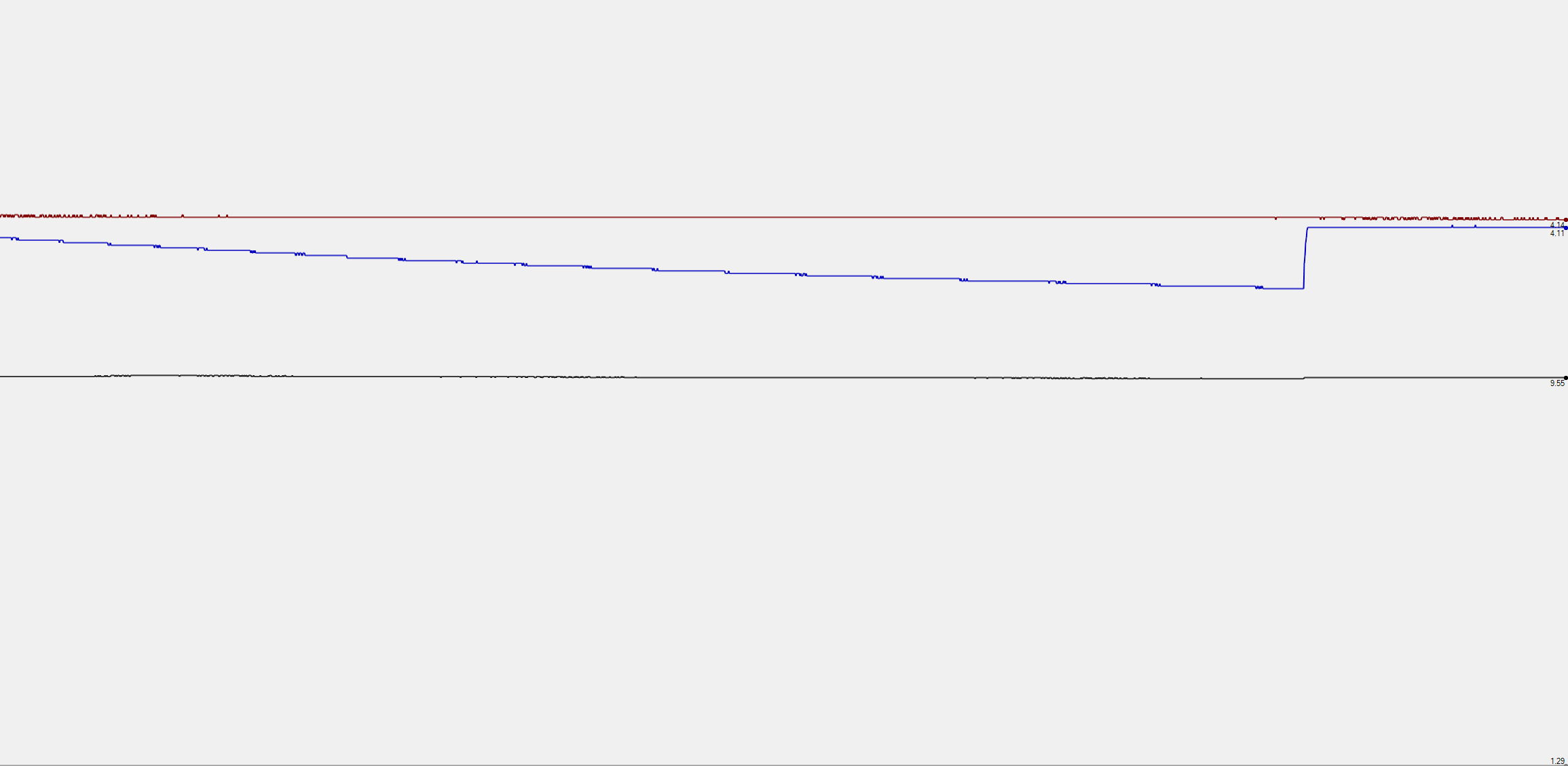

  3. Yea, definitely looking more like a board issue. Even more puzzling, looking at the attached chart (2400 sec time frame) you will see that cell 2 was doing a long sustained drop and then suddenly jumped back up.
  4. [CODE] If you charge it and it comes up, but then drops, I would suspect a bad pack. [/CODE] Cell 3 won't charge. Currently reading 4.19V, 4.19V, and 1.30V (cell 1,2,3). That's with it setting on the charger since my post 2 hours ago, charging display off, no tank attached. I am beginning to suspect a board issue. Cell 3 has now "stabilized" at 1.3V. During the time it was gradually dropping (even though it should have been charging), I noticed the USB current was very low, somewhere around 0.020 A and dropping as the charge on cell 3 dropped. Now that cell 3 is steady at 1.30V, the USB power and current are both showing zero (USB voltage is showing 4.766V). UPDATE: The drain is now affecting the other 2 cells. Current readings are 4.17. 4.12 and 1.29 (cells 1,2,3) (7/29 firmware)

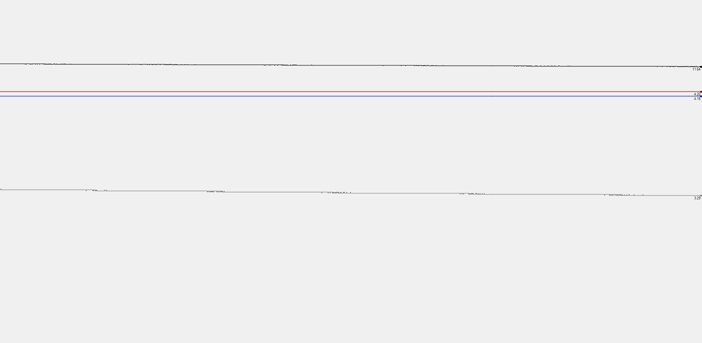

  5. I also am having an issue with my Hana V200. Yesterday I went into EScribe and changed the battery capacity from the 8Wh setting that it had arrived with to 10.545. This morning it seemed to have lost some power overnight, so I connected it to the EScribe Device Monitor and discovered that cell 3 is discharging by itself. I did both a soft and hard reboot from EScribe but neither fixed the problem. Currently I am showing cell 1 at 4.20V, Cell 2 at 4.16V, and Cell 3 at 2.75V. I sent an email to service@hanamodz.com about an hour ago and am awaiting a reply...bummer, as I was really liking the V200. Below is a chart from Device Manager showing the steady drain on Cell 3 (bottom line).
