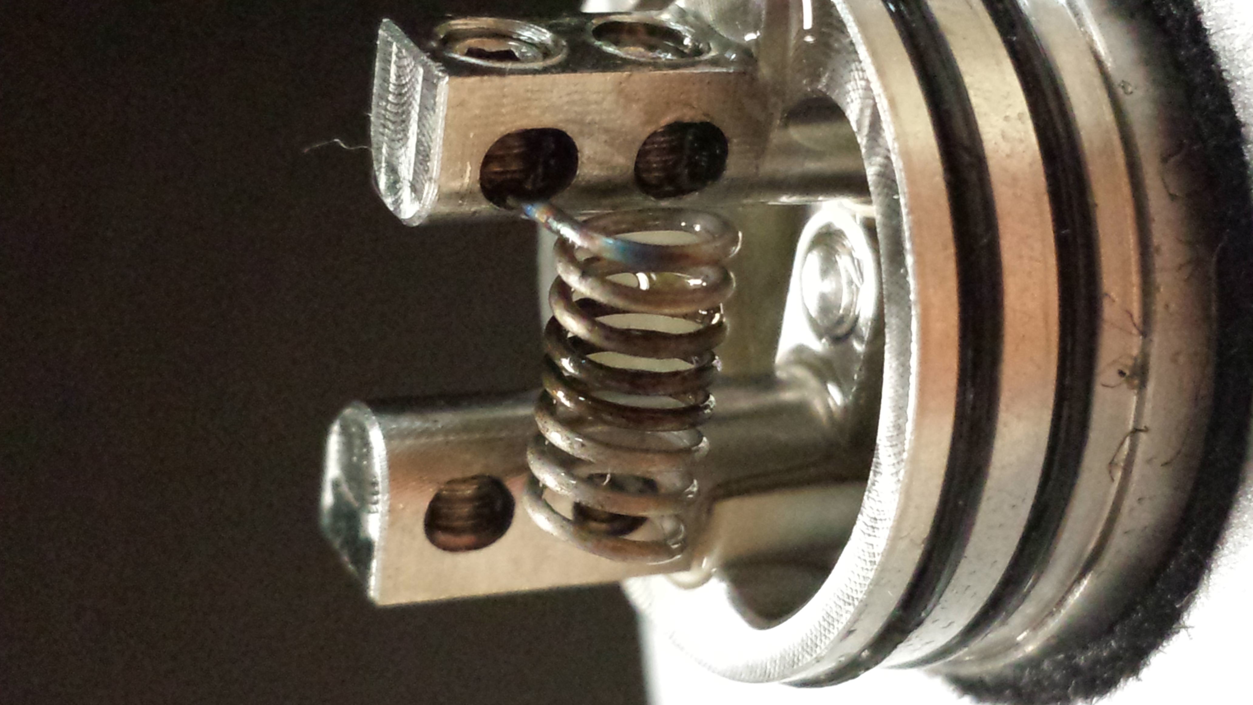

RunsWithOtter Posted December 15, 2015 Author Report Posted December 15, 2015 Chunky - It's fine. Thanks for the post anyway. Haha3dge - The coil is spaced. I may try snapping a picture of it and throwing that on the first post too. Nothing is shorting out on the edge of the well or the barrel either. I've tried 2 different builds that were slightly different and set up CSV files for them each time with the same result. If I turn my temp over 400 running 65 watts, it will not hit temp.Edit -I've done a little digging in forums, and the problem may be my atomizer. I'll try it on my velocity to see if I get a different result. I just wasn't ready to take the build out of it yet.

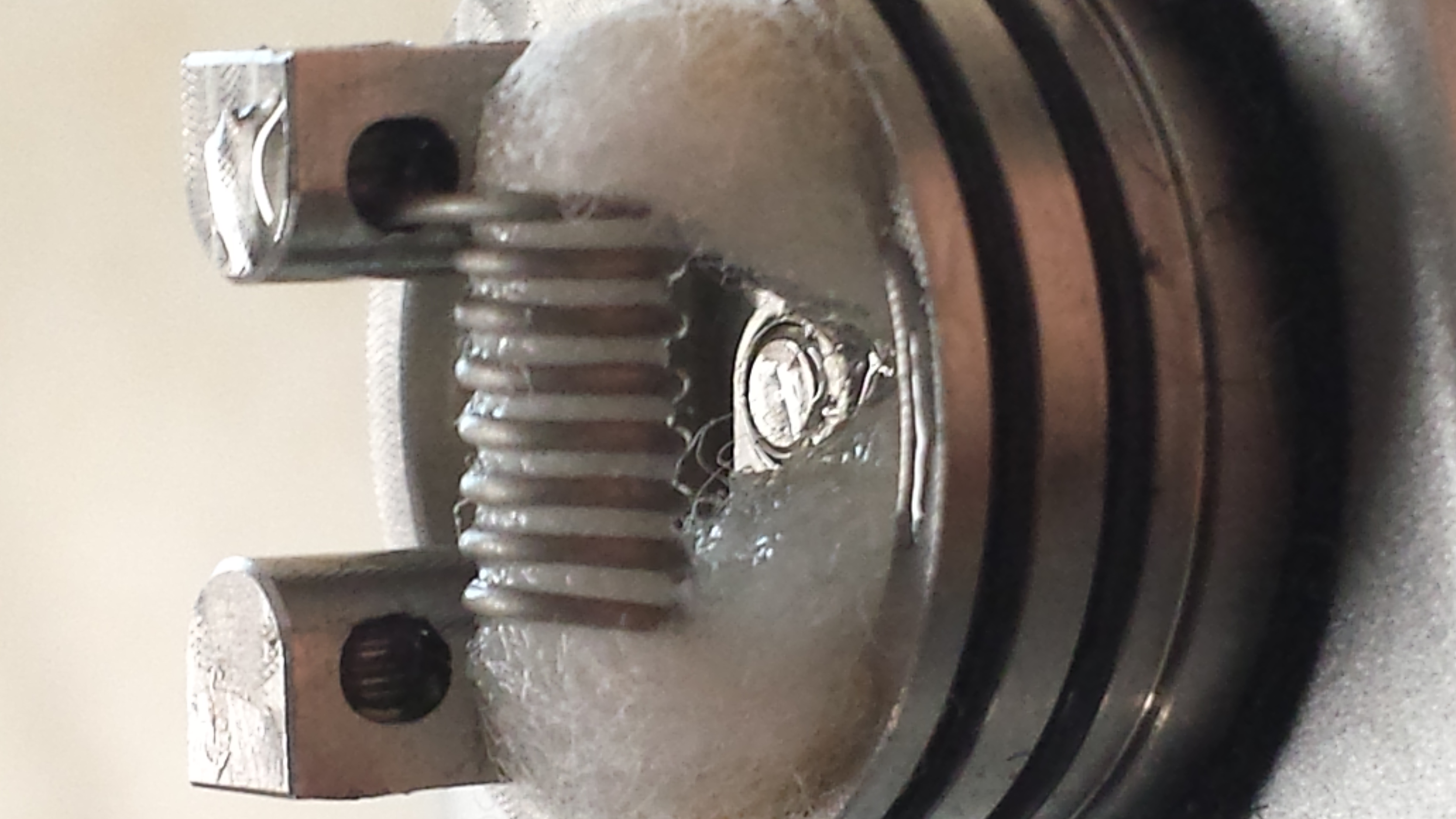

RunsWithOtter Posted December 15, 2015 Author Report Posted December 15, 2015 Fresh built coil on my velocity. My previous attempts have been on my mutation, so I'm hoping this resolves my issues.Lightning Vapes Grade A1 Titanium, 24g 3mm 8wrap single coil. Came out to about .225 which is .015 off of what Steam said it should be.Made a CSV profilehttps://gyazo.com/60c3f8cce0dc9a20ce3fd5145e5381b2Loaded it to my Escribe and uploaded the setting to my device. I also turned my preheat down to 100wattshttps://gyazo.com/2d2d672dbc13e49f4d813a74cb2b96a15 second puff 350 degrees, 65 watts.https://gyazo.com/354053544ff17f31f9058d804365e85a5 second puff 450 degrees, 65 wattshttps://gyazo.com/dea3030a4d23017a0cda9bf6d7610d29same setting, rejuiced my cotton. 5 second puffhttps://gyazo.com/32c42427e6d8cd86135a624add51144dIt's safe to say I'm getting the same result off of my velocity as I am my Mutation.
RunsWithOtter Posted December 15, 2015 Author Report Posted December 15, 2015 I pulled my cotton and it appears hot spots may be my issue. I'm burnt out from all the attempts I've made at this. I'll try again at another point. Also, sorry for triple posting. The mobile version won't allow me to edit my previous post. The Share/Reply buttons cover up the edit button.

black lace Posted December 15, 2015 Report Posted December 15, 2015 I know what your saying but the last shot shows bluing from a hot spot and it aint working properly an if ya can smell burning cotton its gone over 450, way over, moor like 750 for a coulor of blue, may have only took an initial 1 second burst of 100 watt and its destroyed the metal or something, id do one moor build, switch off preheat, set to 430 temp start at 18 watt and build it up until its kicking clouds, do you remember kanthal tutorial building with short pulsing a new coil with a weak battery kind of thing.. if it goes bonkers again and over heats like, doesn't come up to temperature but gets hot spots and blueing burning cotton,, that's a short,, like its arking but on a smaller scale, when you unspool your wire do you stretch it straight between a few pairs of pliers, this may damage the wire, it may also be crap wire.
RunsWithOtter Posted December 16, 2015 Author Report Posted December 16, 2015 That's why I'm posting everything I'm doing to see if anyone has any insight into what is going wrong. I posted the picture and said I was getting hot spots, and I'm aware that burning cotton at 450 degrees isn't right.
bmclaurin Posted December 16, 2015 Report Posted December 16, 2015 I little blueing is normal with Ti wire, as long as you're not getting oxidation (white spots). In my experience, Titanium works fantastically well with the DNA 200 and most but not all of my atty's. The Velocity is one that plays very nice though. I recommend a very slight pulsing of the coils at low power setting before wicking to work out any hot spots. Turn the lights down low so you can see a very faint dull red glow but no more. Depending on the coil, somewhere around 10-20 watts is about right for this. Just pulse it lightly for maybe a second or two at a time until a little bit of heat starts to build up. Contact coils work fine but spaced coils are slightly less prone to problems. Sometimes just reinserting the post that you wrapped it on and willing it around a little is all it takes. Also, after heating, obviously check the tightness of your leads in the post. This simple technique works practically every time for me, even with contact coils, fused claptons with TI cores, etc. Good luck.
RunsWithOtter Posted December 16, 2015 Author Report Posted December 16, 2015 Thanks for the pulsing advice. I'm hoping hot spots are just my issue. I've done 3 or 4 nickel builds this way and never had hot spots, but Ti seems to be different. I'll give it a shot tomorrow.
Spector NS5 RD Posted December 16, 2015 Report Posted December 16, 2015 i pulse all my ti coils. i cup my hand over them to see when then they start to glow a very dark red from the inside out. i strum the coil or coils with a screwdriver till sed coil is doing so evenly. 10-12 watts max, when pulsing. you make em glow and when they cool they're a light powdery yellow, you killed your ti coil. blue red and golden are the safe colors i've been taught to look for after pulsing. your device monitor graphs look good to me tho? this past month i have retired all my ti coils and am now building with nife48/52 you can fire it in wattage or tc mode like ss but with a higher tcr (more stable than ss) than ss. love it. predictable easy to work with high resistance per foot, which makes it great for dual coils. check it out.
