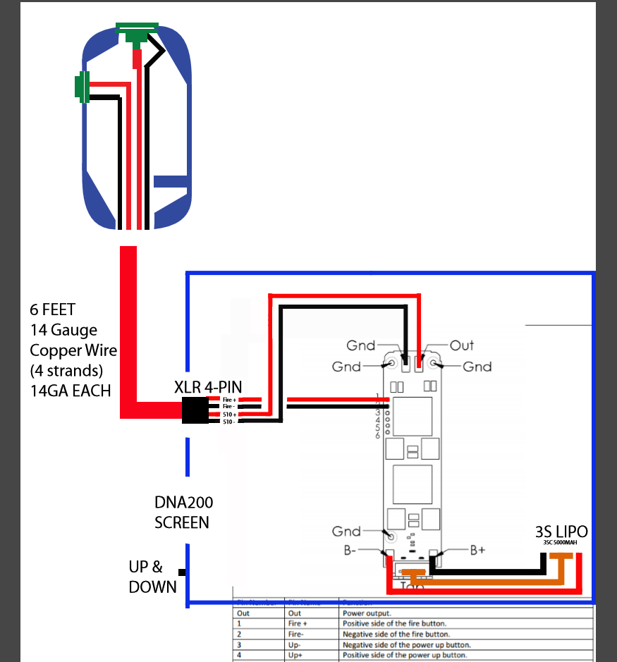

hey everyone, in the works of a dna lunch box with a hose to the 510... lots of grueling research has already been done...
My question is: Ill have 6ft power + and power - going from the chip to the 510... using 14 gauge copper wire. wire resistance is about .02 ohms.
Will this work? or will it cause problems??

Seriously, I think you are way too light on the wire gauge.  I use 12 gauge INSIDE my mods to minimize resistance and at six feet I'd be looking at eight gauge or heavier.  That's what makes remoting the board from the atty a little impractical.  Heavy enough wire is too physically stiff and heavy, even high quality silicon wire.  Then you have to consider the added weight, and stiffness of something to encapsulate all the wires so you don't end up getting tangled up.  Don't forget the added resistance of the XLR connector as well when figuring out the total for remoting like that.
I'm not saying it can't or won't work, just that accuracy of TC will probably take a major hit.

About two years ago someone online know I was vaping an ejuice that they were interested in. It was a menthol watermelon I think. And they wanted to know if the watermelon or the menthol was stronger at 50 watts. My highest wattage mod back then was only 20 watts. So I used my variable power supply to power a coil I made for my RDA and ran the voltage and amps until they both multiplied to 50. Which is 50 watts. And I had taken a vape. It worked and vaped fine. But my leads were only 18g, 12 inches, 10v, 5A. And I believe those leads were a bit thin for the job. And you want to push 10 times more amps than I did.

If I were you I would put the board in the hand set as the battery wires can be thinner, Nick on here (formally DogMods) made a 4 or 5 handset setup using a power supply.

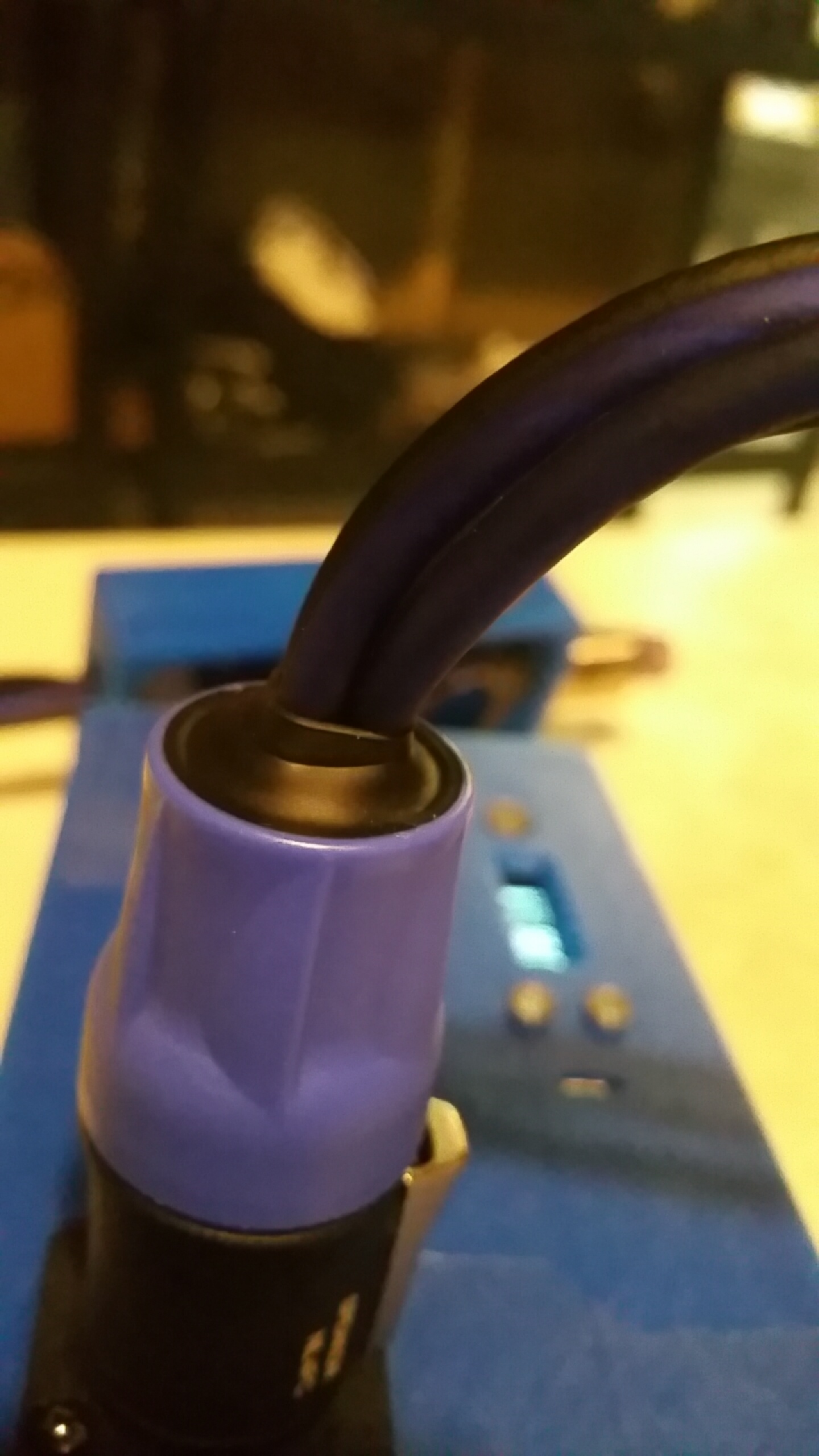

working out some kinks still, but everything is functional!
Temp control works, but isn't really what the device is meant for.
Entire wire and connector resistance = 0.05 ohms.
- changed the settings accordingly.
This is simply a beta unit to see what kind of hose length I could achieve before stressing the battery, chip or connector too hard.

Fair play to ya, youve got building skills, you did what you said and it certainly is different and looks like a good vaping tool.. nothing better than building your own, well done our mate.. (("Just be careful you dont get the cord wrappedvround yer neck lol":,))

The hose actually is quite flexible and hangs nice without taking either of the boxes off the table.
- I am thinking about sheathing the cables to keep em together and give it a more natural flexibility.

The best advice I can offer is to move the board into the handheld unit. Measure the voltage drop over the length of the power wire and adjust the wire gauge to be adequate. I did it this way and would honestly not recommend having the 510 wires that long if you're going for output accuracy, but hey, if it works awesome!
