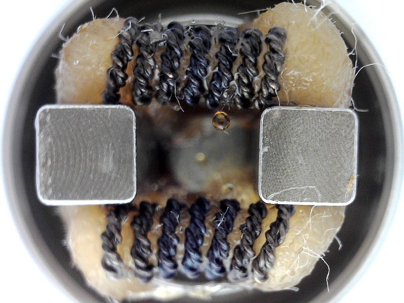

3DClouds Posted June 2, 2016 Author Report Posted June 2, 2016 So i use a Velocity RDA with a single spaced 6 wrap 26 AWG TI GR1 coil claptoned with 34 AWG TI GR1 both wires cleaned with ISO alcohol before wrapping the coil. Velocity is on a VaporShark DNA 200. I have been having issues with my ohms creeping up with use from .35 ohms to about .48 ohms and i suspect it could be my RDA retaining heat from chain vaping and that affecting my base ohms when it rechecks the ohms. The Velocity is a pretty big chunk of SS and it definitely retains some heat once it gets hot. It is enough to throw my temps off by about ~240 degrees F. I had been having issues with temp control not activating but i cleaned and polished my 510 of my RDA and mod to squeaky clean and it worked perfectly at first accurately reading .35 ohms with temp control working 100% accurate but with use it slowly creeped my resistance up to .48. I can feel my atomizer is warm and i think that is the reason for the creep. If i left it set to 420 degrees when it was reading .48 ohms it would max out around ~180 degrees in use. Would there be a way to fix this? Switch to a tank maybe to ensure the chamber is a more stable temp with less SS to get hot/retain heat? The liquid in the tank should help to keep things a stable temperature as well right? Ive been looking for an excuse to buy a Pico RTA but i was wondering if others have been having this issue. Should i just be locking the ohms? I usually don't because I read somewhere it's better not to but i suspect that's highly situational advice depending on what setup you would be using correct? Obviously i could just drop my temps down to 220 but the whole point for me is for it to be actually accurate ohms/temps and I find it difficult to accurately lock the resistance because it fluctuates when i go to press the fire button 5x to lock it on the mod. I wish I could manually set the locked ohms from the mod and not have to use EScribe to do that because 1. I know the correct ohms are .35 but the mod wants to read it as higher than it is because of the temperature of the coil/RDA and 2. I am a primary Mac user and I have to use a different computer for EScribe which is inconvient for me. One day I will BootCamp Windows onto my Mac but I dont have access to a Windows OS to install as of now. I use 2/23/16 firmware 1.0.45 escribe btw if that helps.

3DClouds Posted June 2, 2016 Author Report Posted June 2, 2016 I have yet to cut the legs by over tightening on a TI coil its much better than NI200 in that aspect. I also have a screwdriver with an allen key set I use but those allen head grub screws like to strip before I can get it as tight as I want. It definitely is the screws as I tightened them down and it immediately asked new coil and it was the accurate reading of .35 ohm. I'm definitely ordering those slotted grub screws when I get the chance and that should solve my problems until I can get me a good single coil tank.
