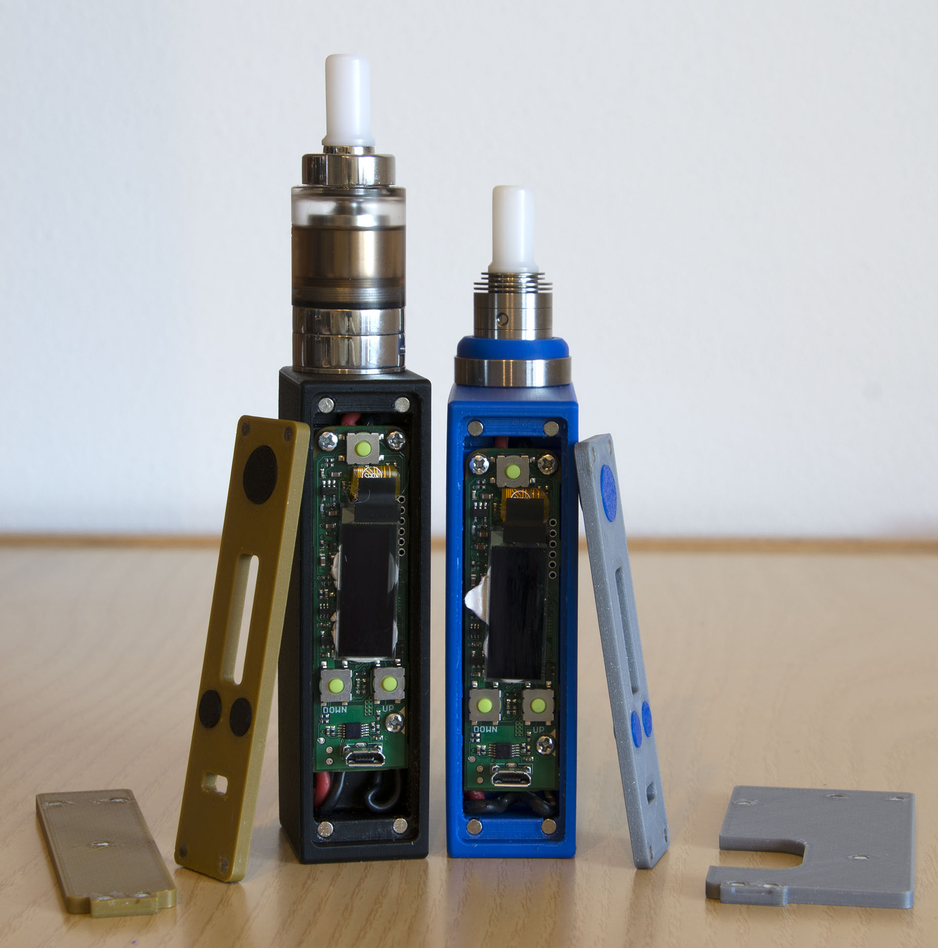

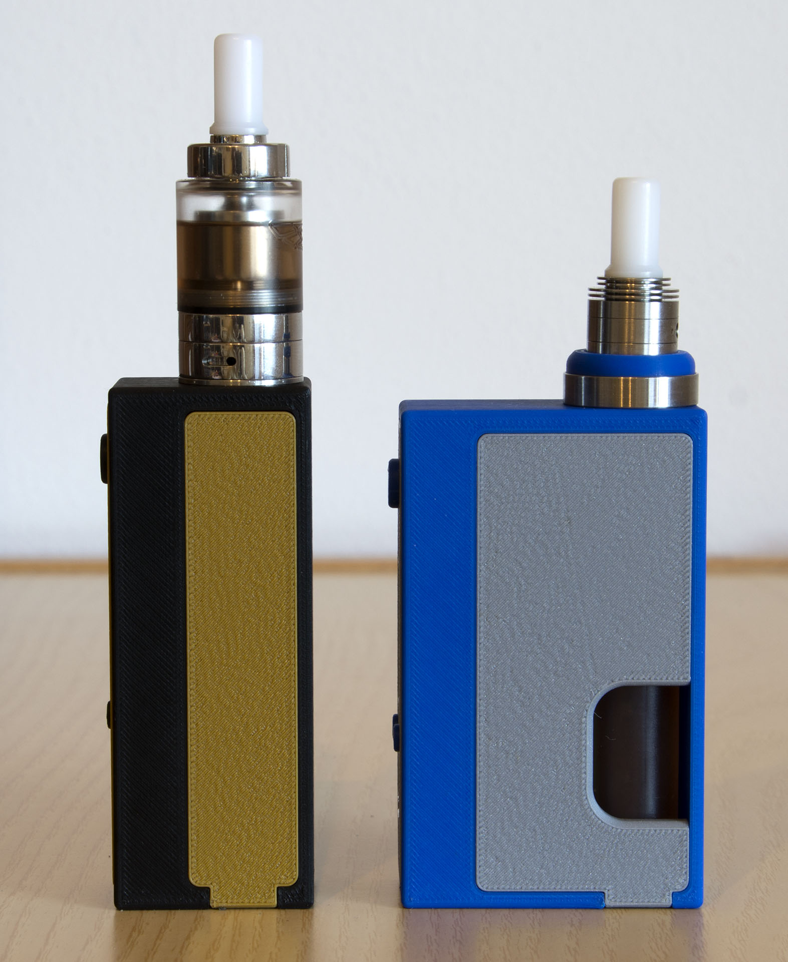

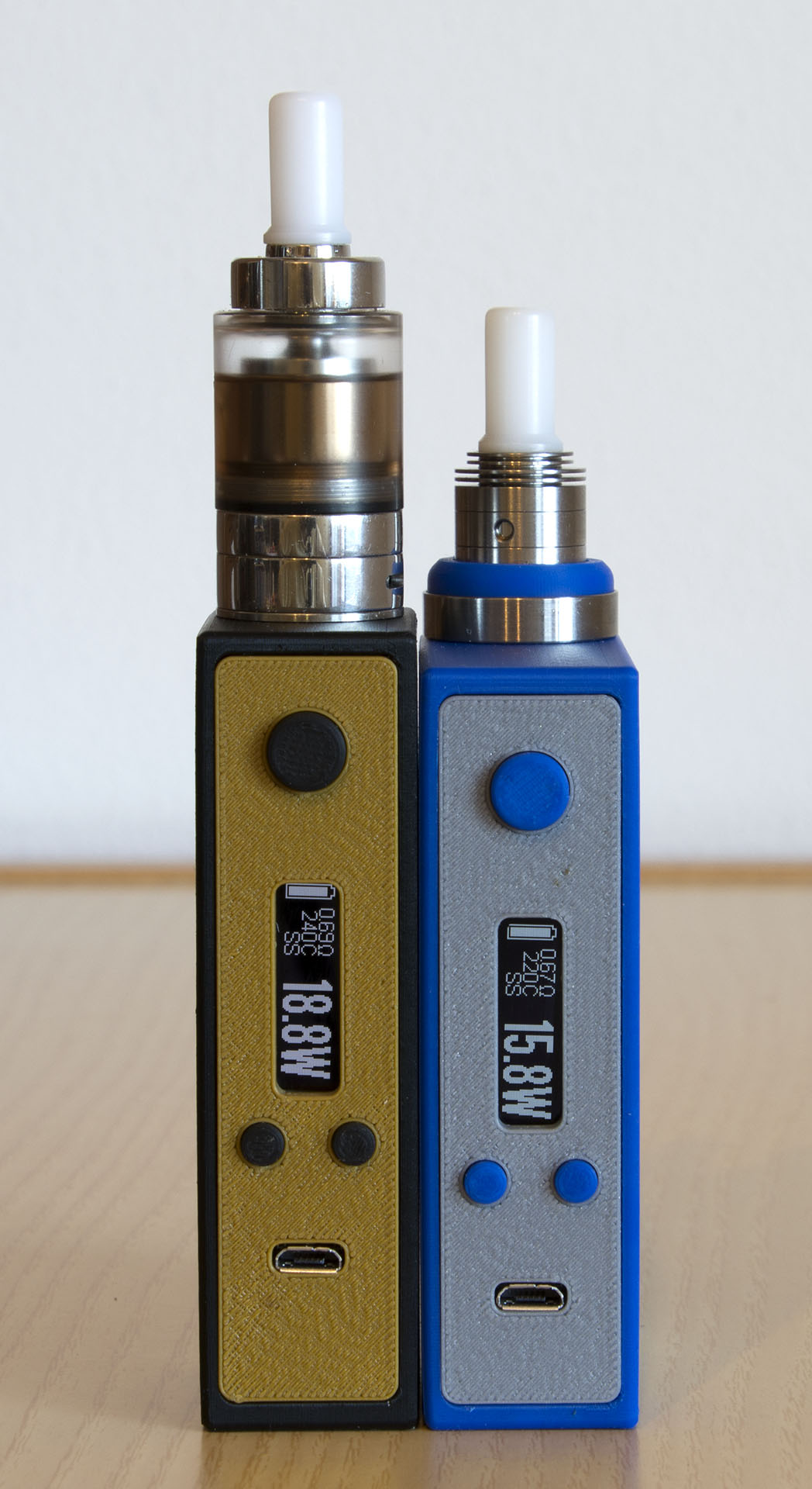

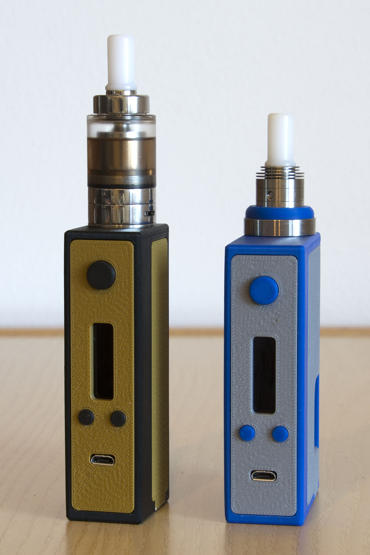

mc0676 Posted May 20, 2016 Author Report Posted May 20, 2016 These are the first two box mod i did with the new DNA75.Box battery: http://www.thingiverse.com/thing:1572914Bottom Feeder: http://www.thingiverse.com/thing:1561386On thingiverse, in each project, u can read some information about size and what u need to mount.I think that are easy to print (in vertical, at 150 micron of resolution) and to mount.I printed all in ABS, 150 micron of resolution. Here all the DNA "full family" (on the right DNA200 2x18650 and DNA200 3x18650).
jrfhoutx Posted May 20, 2016 Report Posted May 20, 2016 That single battery one is pretty sleek looking. I may have to find someplace to print that out. Nice work.
Wayneo Posted May 20, 2016 Report Posted May 20, 2016 They all look fantastic @mc0676. Excellent work. The inside all also look so clean.

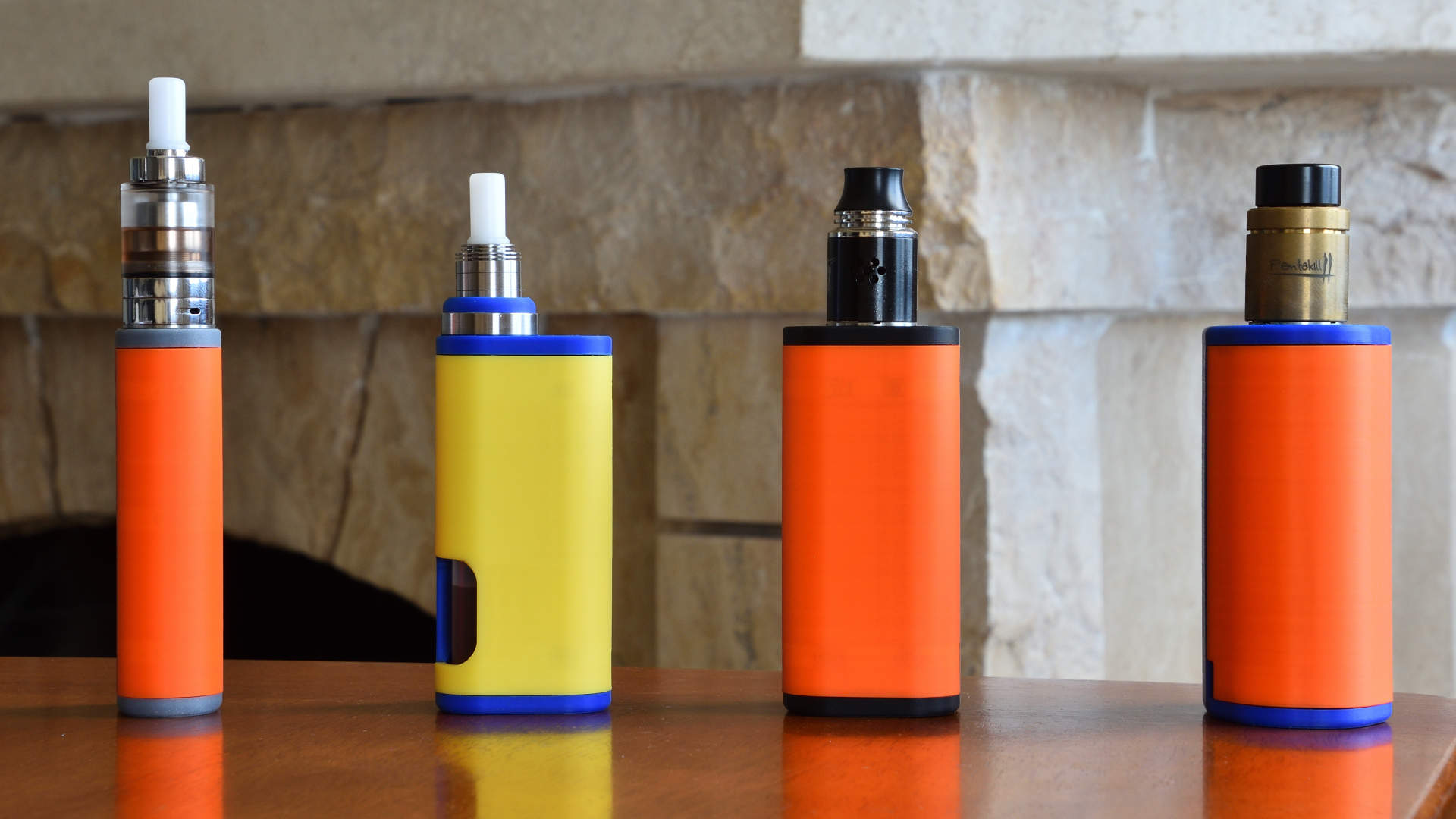

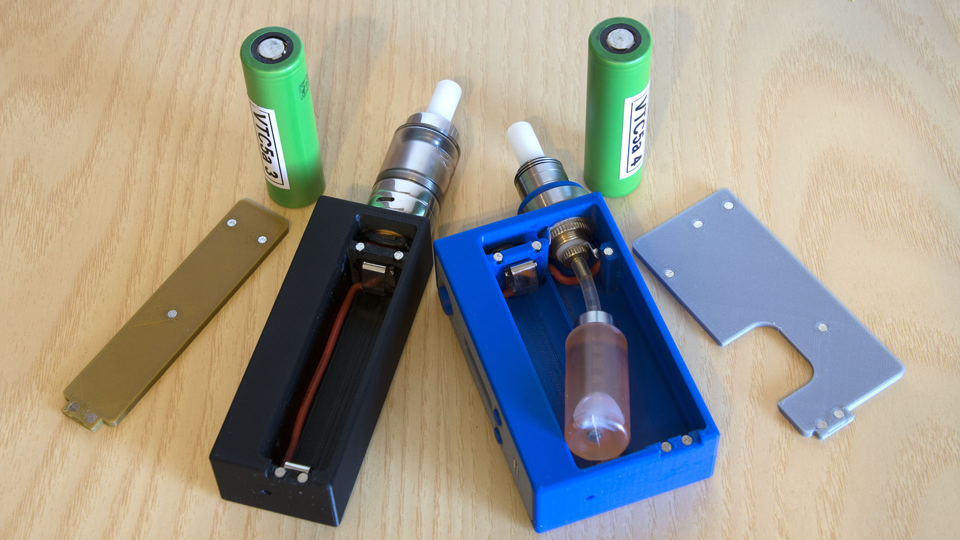

mc0676 Posted May 22, 2016 Author Report Posted May 22, 2016 Thank u.Here the other two in "classic" version.Bottom feeder: http://www.thingiverse.com/thing:1536390 (52x88x25 mm)Box Battery: http://www.thingiverse.com/thing:1535840 (35x92x25 mm)

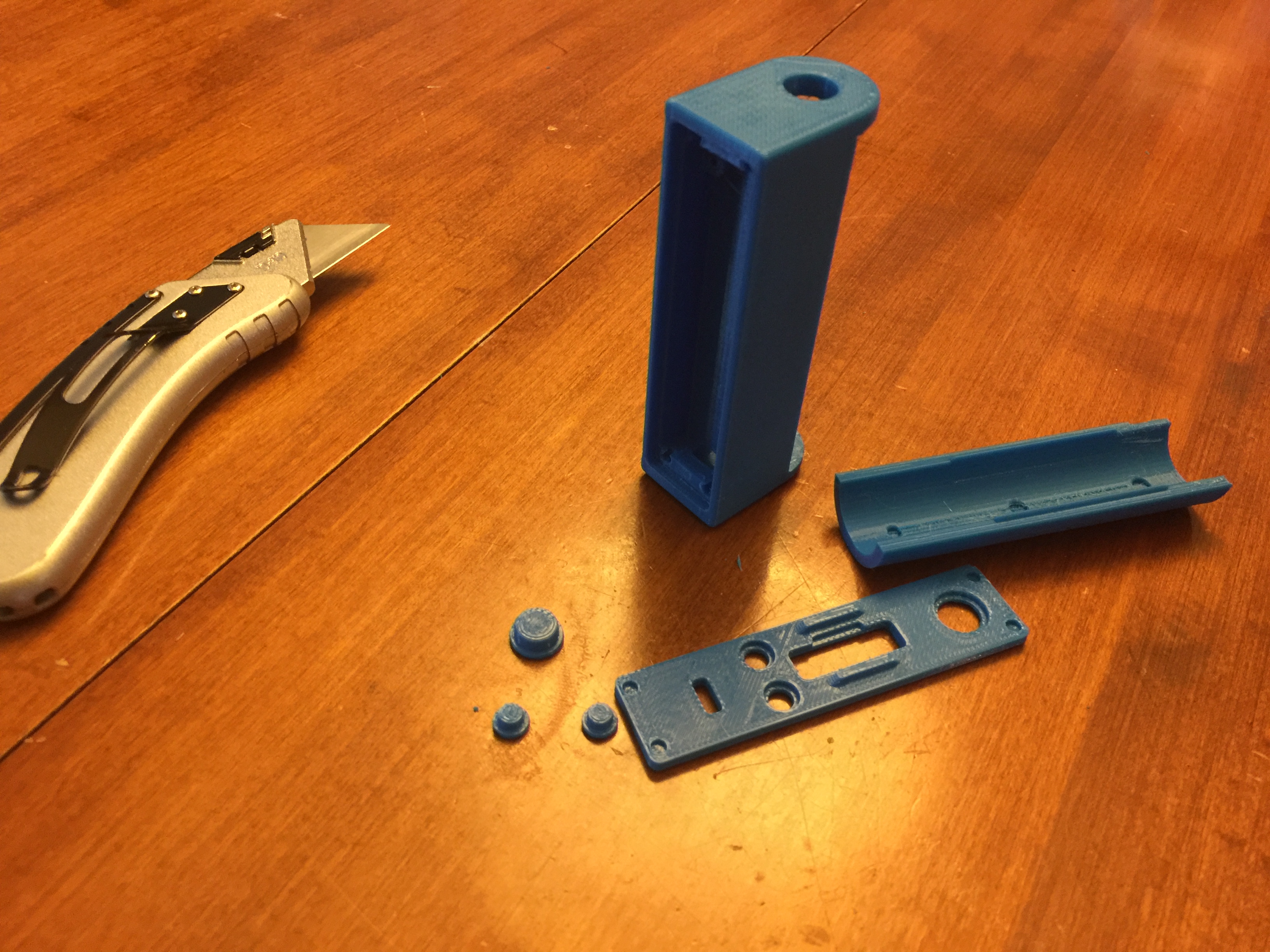

jrfhoutx Posted July 7, 2016 Report Posted July 7, 2016 So I got my first print of your DNA75 (the rounded, single battery, non-squonk version), very nice design. I'm excited to build this out, but I do have questions. How are the battery contacts attached? I thought that maybe there was a slot that I was missing and that was why you used the contacts you did, but after printing, I see no way of attaching the contacts to the case unless I epoxy them in place. Am I missing something? I wanted to test out the printer I'm using, so I printed PLA, 200 micron, 15% infill, in vertical (except for the faceplate, I didn't think the screen opening would do to well without supports, and the software I was using didn't add any there when it modeled the print so I printed the faceplate laying face down). I may make a second print at 150 micron and a higher infill percentage, so that I can see what difference it will make, and to make it a bicolor mod. Here's my print after I cleaned it up a little bit.
