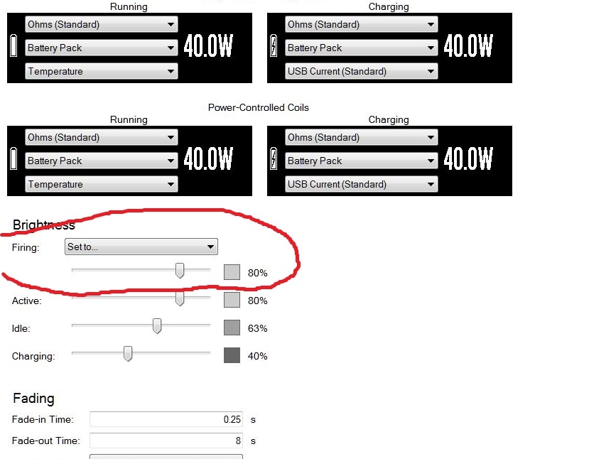

Karsten Posted August 1, 2016 Author Report Posted August 1, 2016 My Lavabox DNA200 screen decided it was no longer going to display whenever firing, regardless of the settings in EScribe (fade to, turn on, off, etc).I also did the 7-clicks on the logo and go to monitor to see if there are any screen disconnects and there are none.Everything else works perfectly.Basically, the screen comes on when you power on the unit. You can navigate the profiles, change temps/watts, you name it - but the moment the fire button is pressed the screen goes dark. As soon as the fire button is released, the screen comes back on.I'm attaching my .ecig file for referencevolcano-900mah-lavabox-preset-files.ecig

VapingBad Posted August 2, 2016 Report Posted August 2, 2016 I checked that in his config file it is set to 100%

Karsten Posted August 2, 2016 Author Report Posted August 2, 2016 dwcraig1 said:Have you looked here?Yes - I've played with all the settings there. Makes no difference.FYI: This unit functioned perfectly for about 6 weeks until the screen blanking during firing started happening.

txmonkey214 Posted August 29, 2016 Report Posted August 29, 2016 Sounds like a corrupted file. Try this: While plugged into escribe, go to "screen", and set all the light settings to 0%. Upload settings to device, soft reset, then go back to screen, raise all the settings to 100%, upload settings to device, soft reset, and see if that makes a difference. Ypu might have to reset a few times, to get the battery level off 0%. If that doesn't work, try it with hard reset. You have nothing to loose, but time.

Karsten Posted August 29, 2016 Author Report Posted August 29, 2016 txmonkey214 said:Sounds like a corrupted file. Try this: While plugged into escribe, go to "screen", and set all the light settings to 0%. Upload settings to device, soft reset, then go back to screen, raise all the settings to 100%, upload settings to device, soft reset, and see if that makes a difference. Ypu might have to reset a few times, to get the battery level off 0%. If that doesn't work, try it with hard reset. You have nothing to loose, but time. Thanks! I'll give it a shot tomorrow morning! I've suspected its related to their implementation/configuration of the DNA200 firmware & eScribe. I included my .ecig file along with the initial Evolv RMA but I don't think they did anything with it. What I got back was either a replacement board that was reprogrammed on the 16th or they just reprogrammed what was in there on the same date. Will post results tomorrow after the test.
Karsten Posted August 30, 2016 Author Report Posted August 30, 2016 Karsten said: Thanks! I'll give it a shot tomorrow morning! I've suspected its related to their implementation/configuration of the DNA200 firmware & eScribe. I included my .ecig file along with the initial Evolv RMA but I don't think they did anything with it. What I got back was either a replacement board that was reprogrammed on the 16th or they just reprogrammed what was in there on the same date. Will post results tomorrow after the test.Initial results:Doing exactly what you described was able to bring the screen back in all instances EXCEPT for when firing - so a major step forward from no screen except when plugged in, bringing me right back to the no screen when firing.At the very least I'll be able to change profiles now!Still wondering what's causing it to turn off while firing though. Maybe when I've got a few hours to kill I'll start from default and change eScribe settings one at a time to see if it makes a difference - although, I've already tried reverting back to defaults and it still goes off when firing (so maybe something in firmware triggered by an eScribe setting that can't be undone w/o reprogramming the board from scratch?)
txmonkey214 Posted August 30, 2016 Report Posted August 30, 2016 Glad it was an improvement. Try this: Go to Screens, and change all the settings for charging and running in both temp and wattage. Reset. Then, set them back where you want them. Reset. Rinse, lather, repeat!
Karsten Posted August 30, 2016 Author Report Posted August 30, 2016 txmonkey214 said:Glad it was an improvement. Try this: Go to Screens, and change all the settings for charging and running in both temp and wattage. Reset. Then, set them back where you want them. Reset. Rinse, lather, repeat!The "improvement" only lasted a couple hours. Now the screen won't come on AT ALL whether charging or not, so it's now in the worst shape yet.Holy crap this is seriously annoying.I went back and re-did the earlier test but this time no effect.Also did a "Restore Defaults", upload, soft reset - still no screen. Reloaded only the minimum necessary settings to fire a NI200 coil to the defaults, re-uploaded, soft reset - no screen. Reloaded original .ecig, uploaded, soft reset, went back and changed screen settings, re-upload, soft reset - still no screens.
