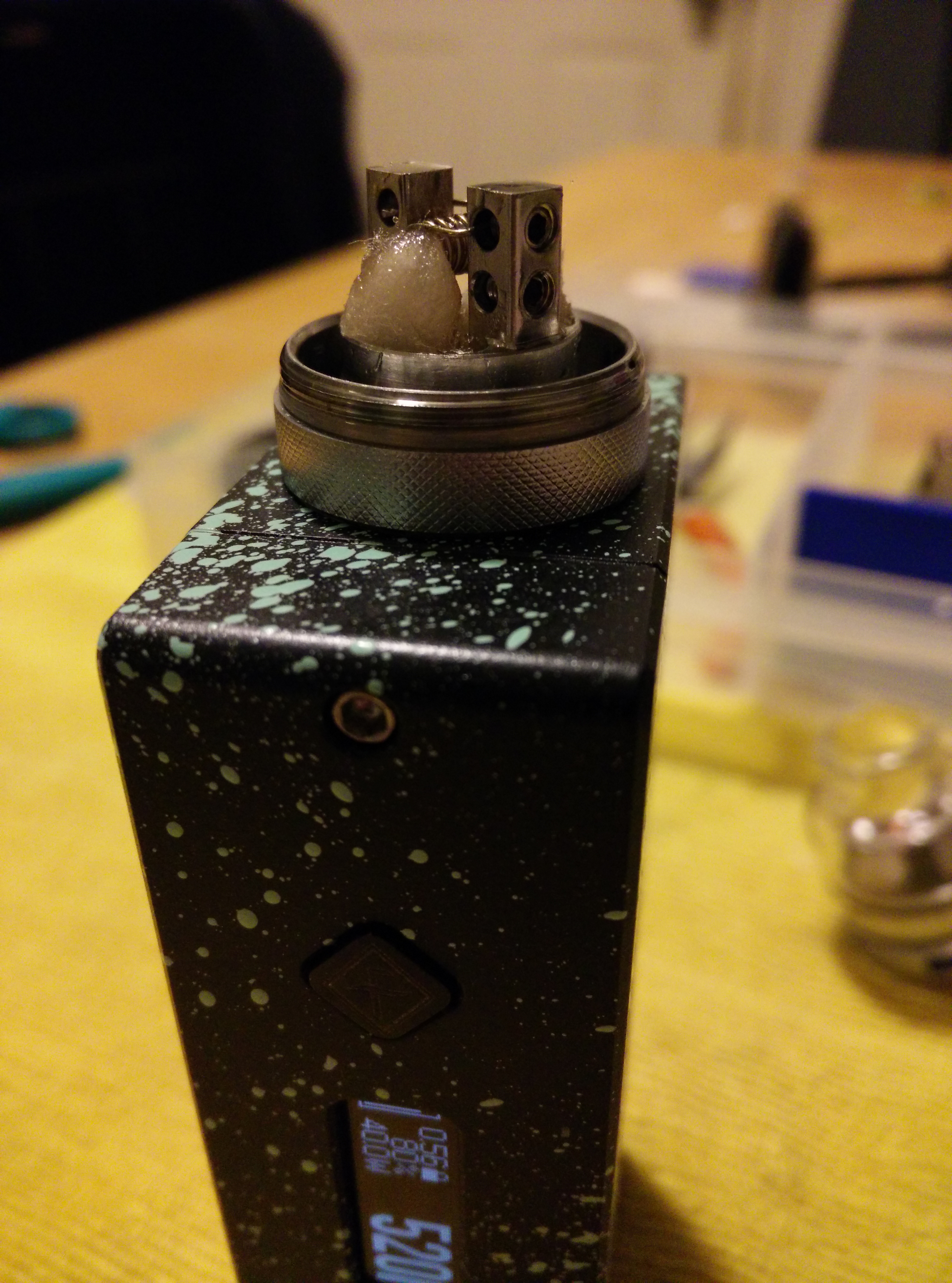

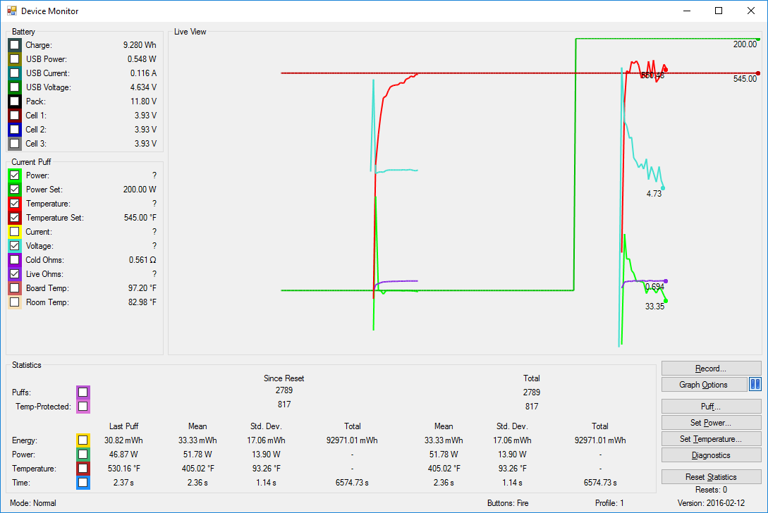

  3. I'm having pretty good luck with this setup so far: Single coil SS316L - 26 AWG 9 wraps (spaced) 2.38mm (or 3/32 drill bit) .5612 ohms (locked) Aromamizer RDTA Preheat: 100w, Punch: 1, Time: 1 first pull was at 40w, second pull at 200w Update: Thought I would add another shot from today (2/17) at 200w with longer pulls. Vape quality is still exactly the same as 2 days ago when I slapped it together and my battery lasts all day now! Couldn't be happier.

  6. Reporting back after slapping together a dual coil build in my Twisted Messes rda. I must say, damn. Thank you for this. I wrapped 20g 316L around 2.4mm 8 times. Reading .08 ohms. Temp control is working nicely so far. Nice smooth climb to 450F (never going much past 350F surprisingly) and completely satisfied with the vape. Haven't done a dry burn test yet but hopefully will get around to it this weekend. Edit: Ohms locked at .08. 450F@50W, preheat=200W, punch=5,time=1s
