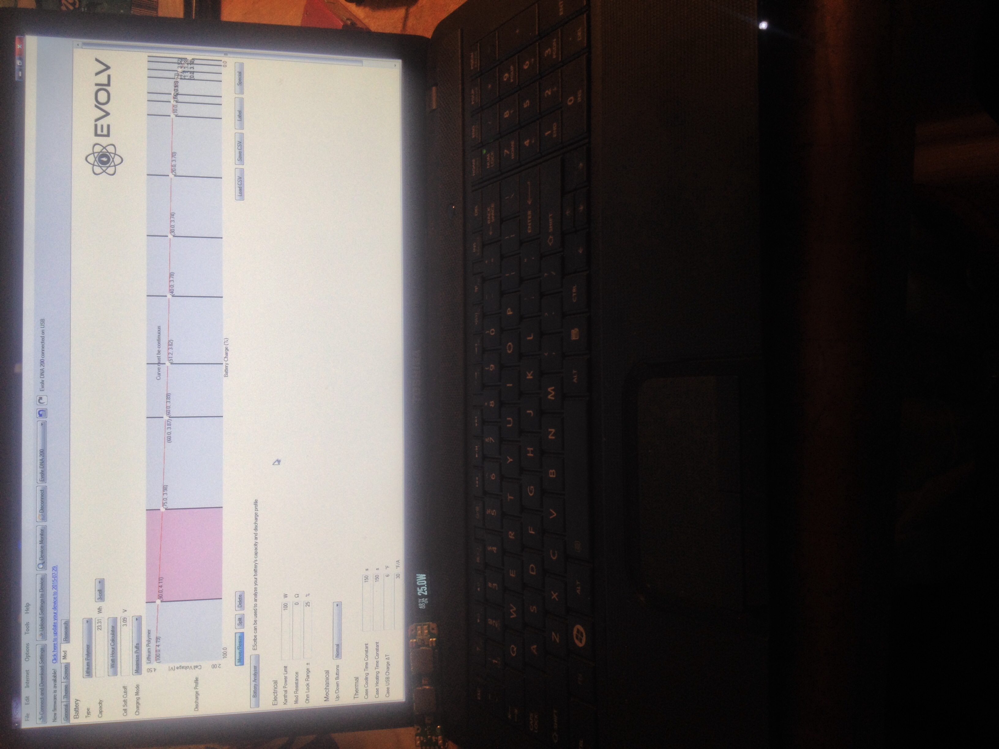

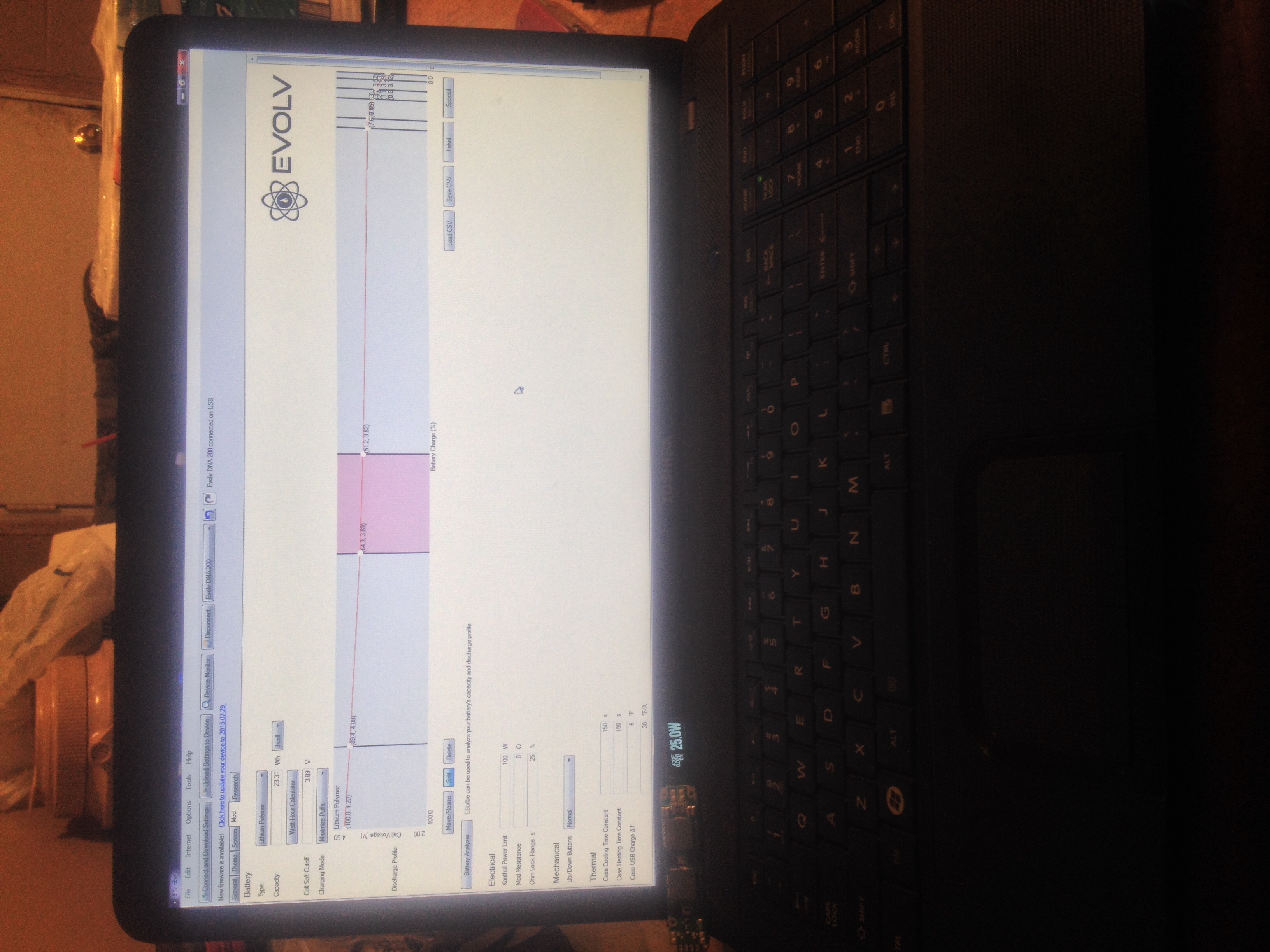

Now the battery profile, there are set points like the first pic if I change/add the set points but keep the curve like second pic will these set points show up on the chip screen? The parts for my mod are still being shipped so I'm setting up the board as much as I can
Laguz75, yes, but your best bet is to set the mod or board up with a power resistor for the output and just run battery analyzer. It will make a perfect curve and give you the measured capacity. We like 50 watts here as the firing power.
