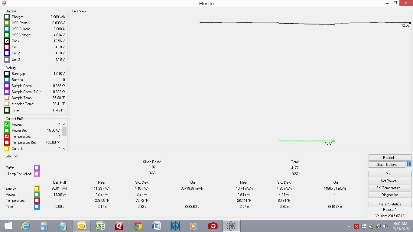

John: I posted a screen shot earlier showing the temp not showing up in escribe during a puff. After multiple hard boots I managed to get the temp to show up normally and then left the device to sit on the desk for over an hour with no activity. Now I get the following behavior....temp shows up but definitely NOT normal. I'd appreciate your help/recommendations.
John: I'm using titanium grade 1 wire with Steam Engine l.csv on profile 2. This is an example of the missing temp data during a fire. If I set up on Profile 1 (Ni 200) with the max temp set at 300 as an example) I also get the same lack of temp data being displayed. I also seem to be getting erratic resistance readings quite often.
