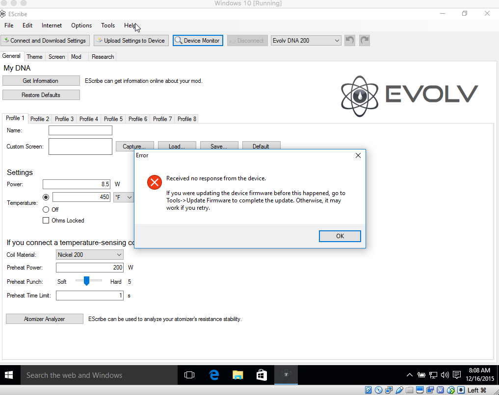

timwalker2k Posted November 18, 2015 Report Posted November 18, 2015 After a few failed attempts with VirtualBox on El Capitan, I finally successfully connected to the DNA-200 using VMWare Fusion.I was initially getting an EEPROM error, and loading/saving progress was very slow. Increasing the VM memory to 3GB and setting 2 processor cores increased the speed and reliability of the connection.The combination that worked for me:OSX El CapitanVMWare Fusion (trial version)IE 10 on Windows 7 (from modern.ie)

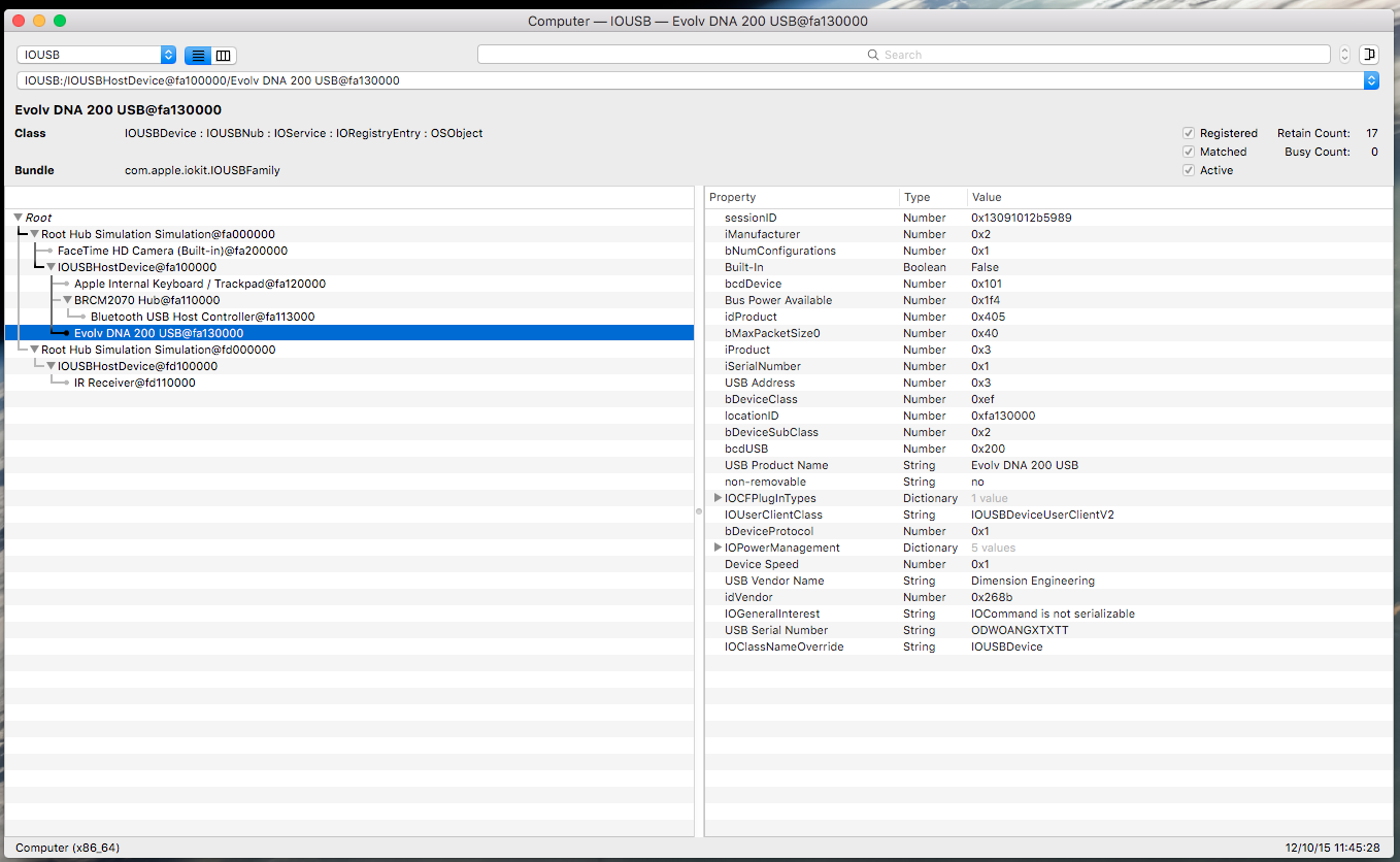

johndoe123 Posted December 10, 2015 Report Posted December 10, 2015 So, I got EScribe running on my Mac... It works fine other than a little distortion with the shading (shadows around buttons looks a little off). I am having some issues with the drivers so right now it doesn't recognize a device so it is pretty much useless. It is just a USB Serial device so I am hoping I can make it work but we will see. I'll update if I get it working. FYI setup is not simple, I will do a write up but for those without command line experience, you are better off using a VM or second partition.Evolv, could you provide any details about your driver?

johndoe123 Posted December 10, 2015 Report Posted December 10, 2015 "The current hurdle is sourcing a USB driver that we can use as the Generic HID Driver we currently utilize is not a viable option on MAC." - I don't think that is actually accurate.James said "I should add that while the Windows serial driver is proprietary, the protocol it speaks is standard USB CDC serial. So Linux will recognize it without a driver. Because the device is composite, the CDC serial must have an Interface Association Descriptor, which makes the serial not work with Mac OS X (no IAD support). But, the HID-tunneled serial will work on every platform."I can send serial commands to the DNA 200 from my Mac without a problem (i.e. "P=100W"). That is super easy and doesn't require any setup as the Mac sees the device as a USB serial device. Plug in the device and run "screen /dev/tty.usbmodemFA132" then type the command you want. From my understanding, IAD support was added to Mac back in 10.7.I am running EScribe using Wine right now on my Mac. I am attempting to get the HID drivers setup in Wine so EScribe will see the device. I can give Wine access to the serial port using the following command, "ln -s /dev/tty.usbmodemFA132 ~/.wine/dosdevices/COM3", but without drivers setup it doesn't work.Is there something I am missing about why this won't work?

johndoe123 Posted December 10, 2015 Report Posted December 10, 2015 VapingBad said:It is not all text over the serial port, that is mainly for the Device Monitor stuff, all the firmware, themes and settings are binary so need lower level access.Right, but I am not following why that can't be setup on a Mac.
thekanthalkid Posted December 16, 2015 Report Posted December 16, 2015 I just sent in a report ticket to Oracle, to let them know of the USB issues with El Capitan, and to get an update on a new patch being released. I have 5 DNA200 devices I have been using eScribe with all them just fine, using VirtualMachine on OSX. It wasn't until I updated to El Capitan that the USB mounting support got wacky. The device is found and recognized by the USB drivers, it just has some bug when trying to "Connect and Download Settings".Hopefully this problem will be fixed soon, I'll post an update when I have one.Peace, KK
blueridgedog Posted January 13, 2016 Author Report Posted January 13, 2016 We have a new version of VirtualBox...and the El Capitan problem persists...I did a clean install of El Capitan and VB just to test...still not an option. VM Ware Fusion seems to work.
the_edge Posted January 14, 2016 Report Posted January 14, 2016 I can confirm that escribe is working with Virtual Box running on mac OS X EL Capitan,I'm using a External display on my Mbp which has a 4 port usb hub. When the DNA 200 is connected to this the software connects & runs without issue. UPDATE!!!It's now working connected directly to the MBP, on the first try it failed so i disconnected & reconnected the battery in the mod, plugged it into the usb, it then successfully connected and worked.
