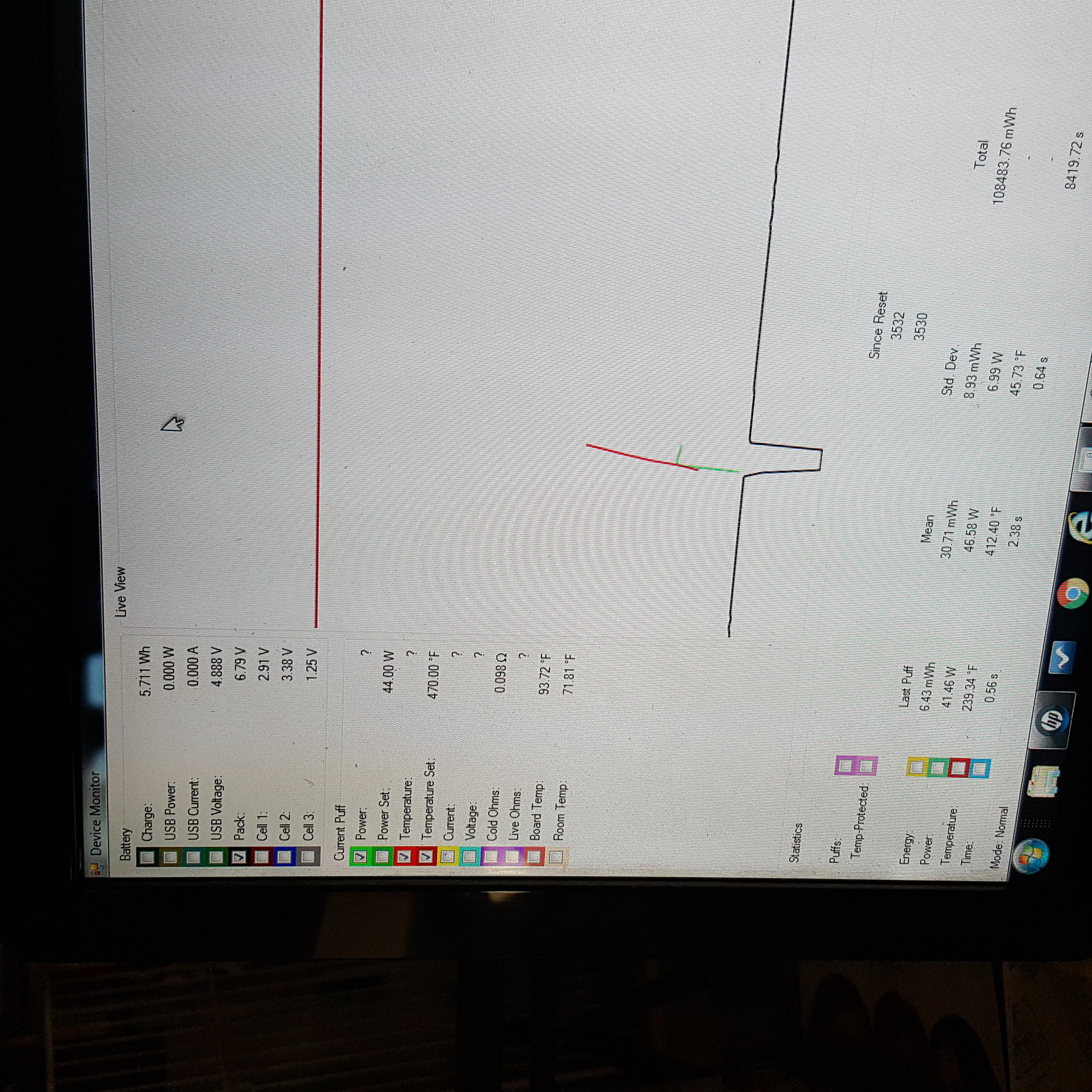

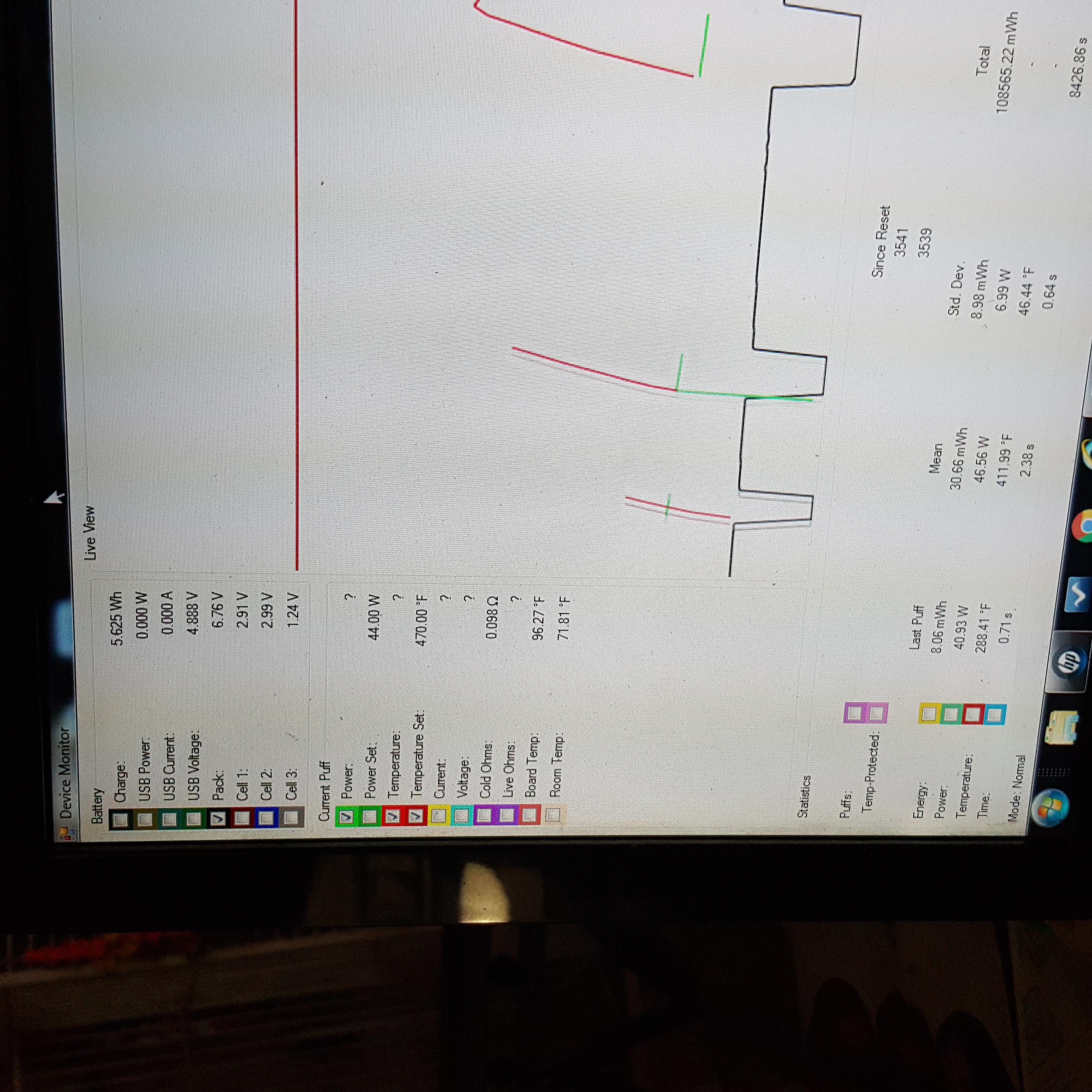

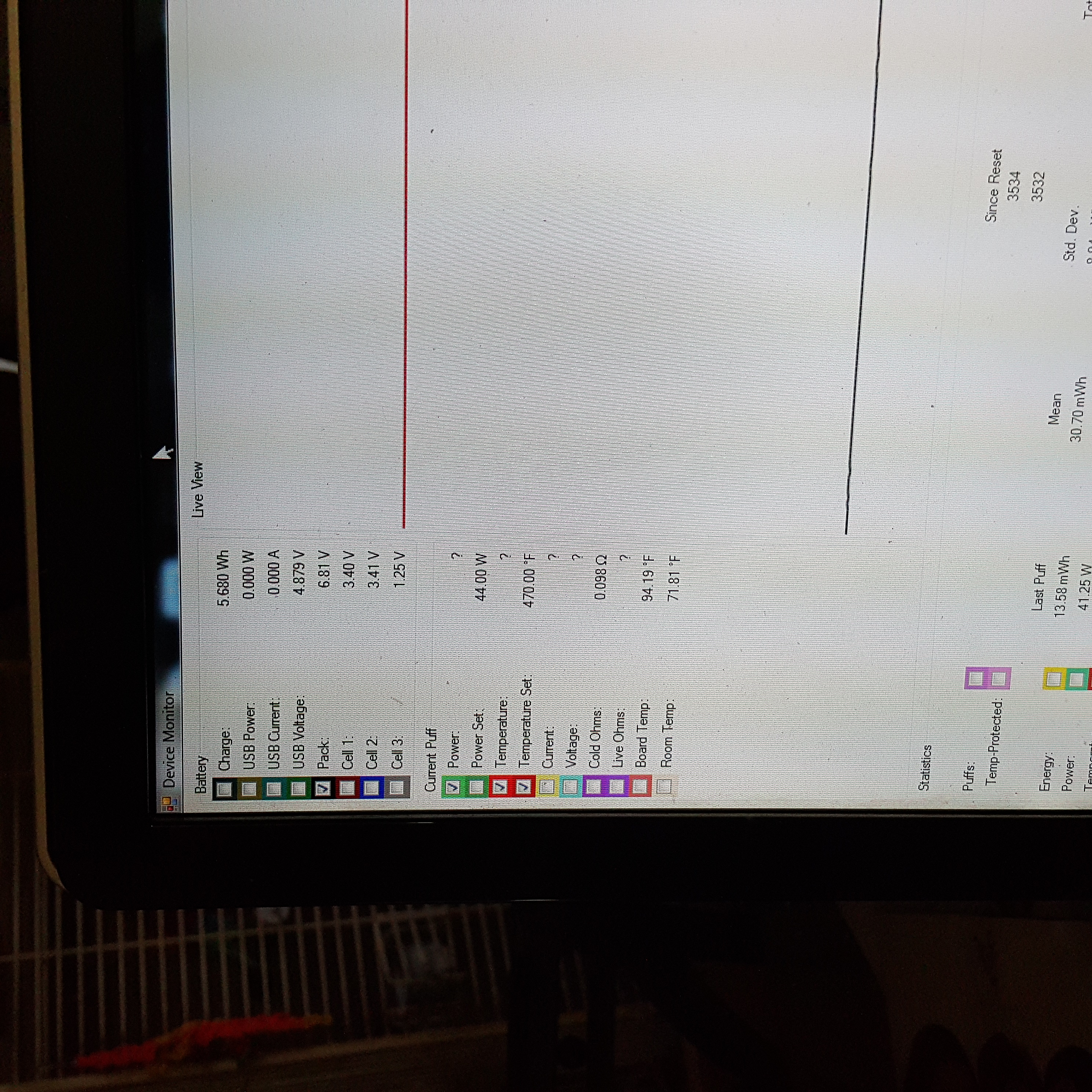

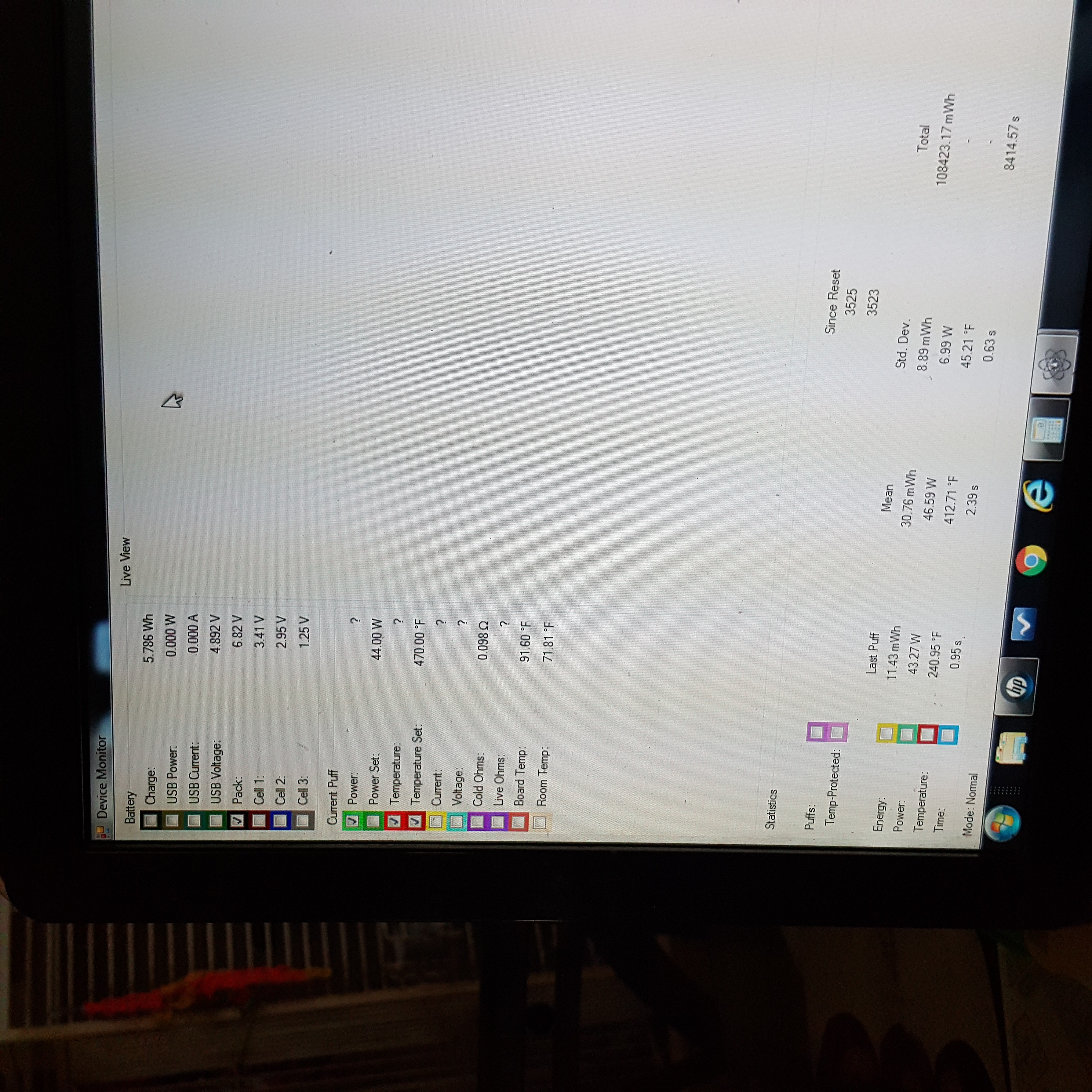

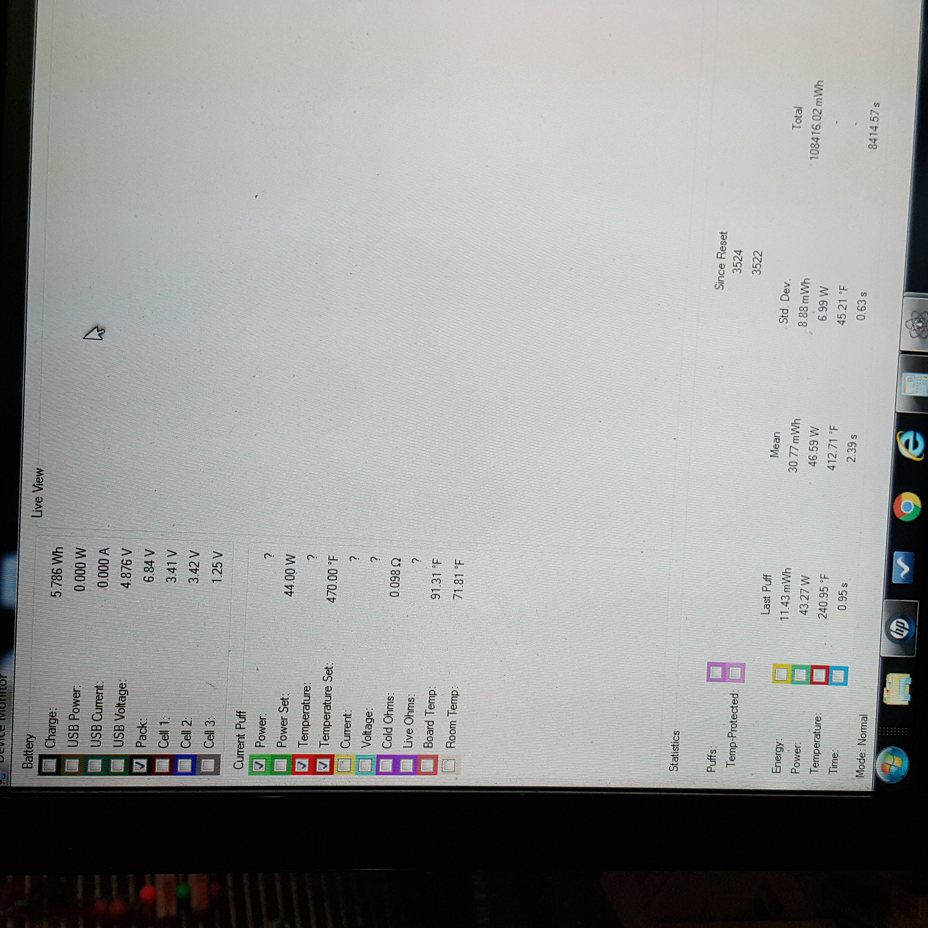

Jvape78 Posted October 27, 2015 Report Posted October 27, 2015 Not the batteries! Something bogus happening elsewhere but today I ran the brand new freshly charged pair of hg3000 mah down until I got weak battery note (set at 2.9v). Plugged into escribe at that point and this is what I got. . 3.4v batteries sagging down to 2.9 is not right. Not only that but I noticed that some times it doesn't register any sag,sometimes both sag, and sometimes only one or the other sags. .. I used 18ga wire and it's less than 2 inches long so I shouldn't think it's wire size. ..I am at the point now where it seems to be clearly not my batteries or my wiring. .kinda only leaves one culprit.

Dejay Posted October 30, 2015 Report Posted October 30, 2015 Like I said I'm no expert but I don't quite understand what your problem is. So I'm just trying to help and am curious:So your problem is that you get the weak battery warning when both batteries show 3.8V? The other four pictures you posted show the cells at different voltages. But that could be explained by your battery voltage being 3.4V without load and it sags down to 2.9V under load (which is normal and near empty) - and that the display is simply not getting updated quickly and you made the snapshot. Either it is delayed or maybe some data transmission error? You could track it much better if you would check the cell voltages to graph and look what happens when firing. And if they are indeed erratic and different from each other. Then it might be a connectivity problem after all.I do have a dual 18650 mod and haven't (yet) experienced any issues except that:1. the battery meter is not accurate because I assume either my mAh or my battery profile is not correct for my LG HG2 and 2. I get "ohms too high" on a 0.3 ohm SS build at 100W when my voltage gets too low. But both of that is to be expected I guess.Cheers
