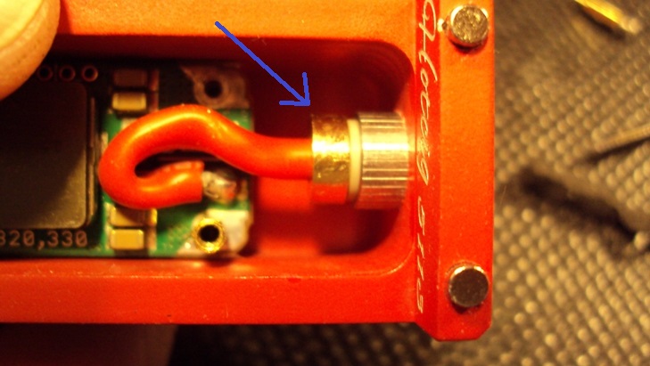

Posted
Podunk Steam said:
The 510s negative connection I'd have in question, it's been my only concern as I have one of the Hotcigs too. I originally intended to change out the 510 connector but didn't find need after opening the device up.
I've personally been running below spec just to see if anything goes South early on, 0.04 ohms resistance coil but only pushed at 30 watts so far. This has been in an effort to see how the questionable negative contact at the 510 would hold.

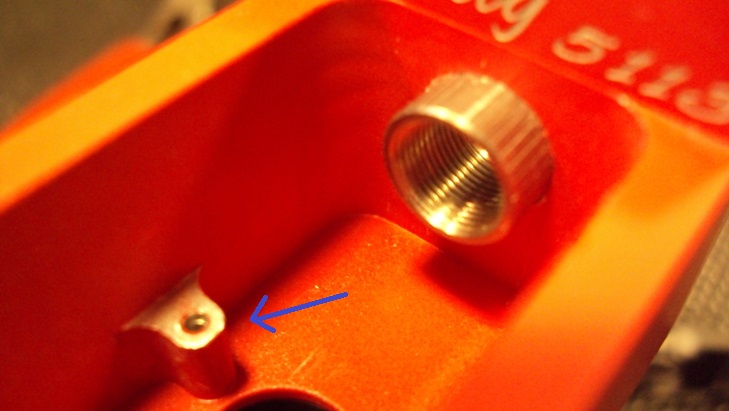

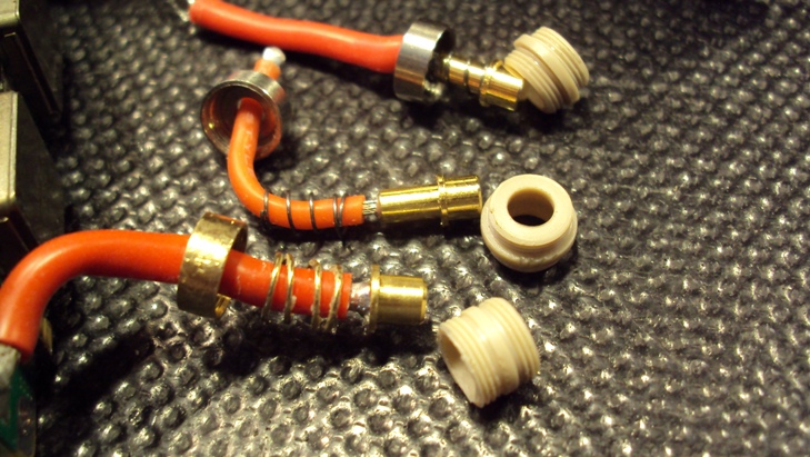

Posted
Ww34ww,
I assume your asking how to take the 510 apart? Here's how, if you need other info let me know, I have more pics of taking the HotCig apart.
To take the 510 apart, this cap unscrews, I use needle nose pliers to loosen
The tan colored plastic insulator may unscrew with it, the one in the middle is a hotcig, the other two are from VariTube V1 510's, I replaced the guts of the HotCig 510's with the VariTube parts because in my opinion they are better.
The main body of the 510 is pressed in, the guts of the VariTube 510's are a direct fit. The first pic above shows the VariTube parts after they were installed. Here's a link to the VT V1's http://www.varitube.com/VT-510-V1-Connector--Self-adjusting-Center-Pin-_p_141.html
(Note: While I had the board out I gently scraped the paint off the three board mount pads with a razor down to the bare metal giving a better ground for the board. Arrow points to one of these pads.)

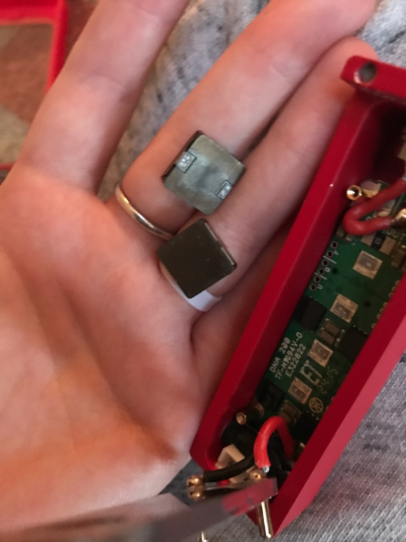

Posted
OK so now we have a new problem those two squares inside of the hot sex thing are actually broken offit's not the 510 pin it's those I don't know how to fix it help
