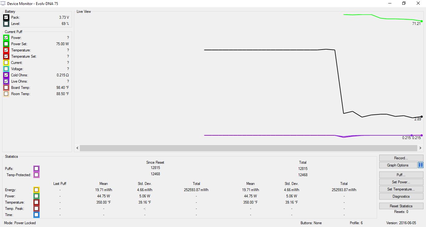

dwcraig1 Posted September 18, 2016 Report Posted September 18, 2016 So I set out to test my SDNA75 with LG HD2 18650 with my Velocity @75 watts....I eventually gave up (at 34 drags) as it just isn't my thing but here are the screens at the start and my finish. It seemed to do quite well I thought.But the flashing battery icon was coming soon...@ 2.75 volts.

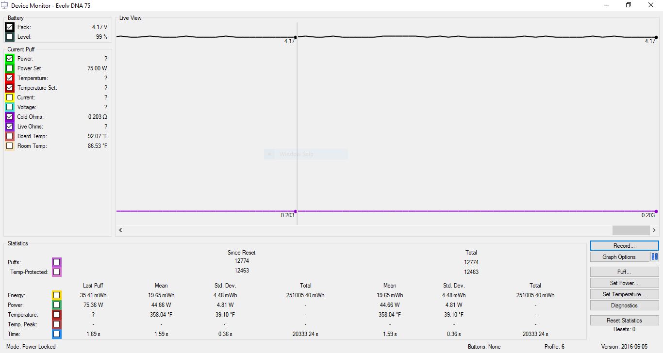

AMDtrucking Posted October 9, 2016 Report Posted October 9, 2016 This just in! I finally, got hold of A123 systems LiFePo4 26650 battery, that is NOT fake. I did some tests and, most importantly, vaped most of the day at 75 Watts. IMHO, that battery is our only salvation. It needed some adjustments though. I switched to "Lithium-Polymer" and set the lowest voltage to 2.5V, ran Battery Analyzer and saved the graph: As you can see, from the graph, the battery was charged to full 4.2V. But as soon at the first load was introduced, the battery's voltage dropped to it's normal 3.32V and continued to work flawlessly for pretty long time at 75 Watts. The usable capacity ended up being 7.967 W/h (2400mAh). None of my existing Li-Ion 26650 batteries was able to do that. VapPower 4200mAh = 158.9mAh (0.588 W/h), Sony US18650VTC5 = 619.5mAh (2.292 W/h), Sony US26650VT = 430mAh (1.591 W/h). "Weak Battery" message, is the thing of the past! Too bad, I only bought one of these batteries because I have two DNA75 devices. But I wasn't sure that LiFePo4 was going to do it for me. Especially, after my first A123 turned out to be FAKE, I bought it on eBay. I've already placed an order for few more HERE. If anyone is interested, I'm placing the content of my CSV battery profile. Just copy it into Notepad and save as .CSV file. Or use my, attached file, if you want."Battery Charge (%)","Cell Voltage (V)"0,31.12965977191925,3.049999952316282.78649425506592,3.089999914169313.86594724655151,3.099999904632577.05409812927246,3.1600000858306913.5810213088989,3.2000000476837231.5175094604492,3.2595.1173629760742,3.319999933242896.7490921020508,3.3399999141693198.3808212280273,3.53999996185303100,4.19000005722046I forgot to add: According to my measurements, the Internal Resistance of my A123 was 13 m? and I was able, easily, get 50A current from this battery. For that, I made special Voltmeter, that is capable of conducting such current. It is solid SS construction and the wire inside is 12 Gauge. Internals of the spring loaded 510 connector are from Fat Daddy connector.I also made me a hefty battery holder. For test and charge purposes with spring loaded terminal. I later, adjusted my discharge graph (manually). I only changed beginning voltage from 4.2V to 3.6V. Also, I changed my low voltage limit from 2.5V to 2.7V, otherwise "Weak Battery" message never shows, even when the mod can't vape anymore. But I was able to vape Billow V3 with two coils, made out of 26 Gauge NiFe48, with TC, at the actual power of 71W - 75W pretty much all day today. One Billow V3 and a half. All that, on a single battery charge. And I will only charge LiFePo4 battery in my SkyRC MC3000 to 3.6V because, USB will attempt to charge it to 4.2V and that's not good. "Battery Charge (%)","Cell Voltage (V)"0,31.12895047664642,3.050003051757812.78634595870972,3.089996337890633.86725568771362,3.100006103515637.0559401512146,3.1600036621093813.5804328918457,3.1999969482421931.5175342559814,3.2595.1170806884766,3.3200073242187596.747444152832,3.3399963378906398.3808288574219,3.4244186878204399.9991836547852,3.59883713722229 A123_LiFePo4.zip
