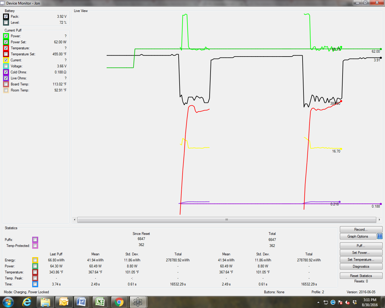

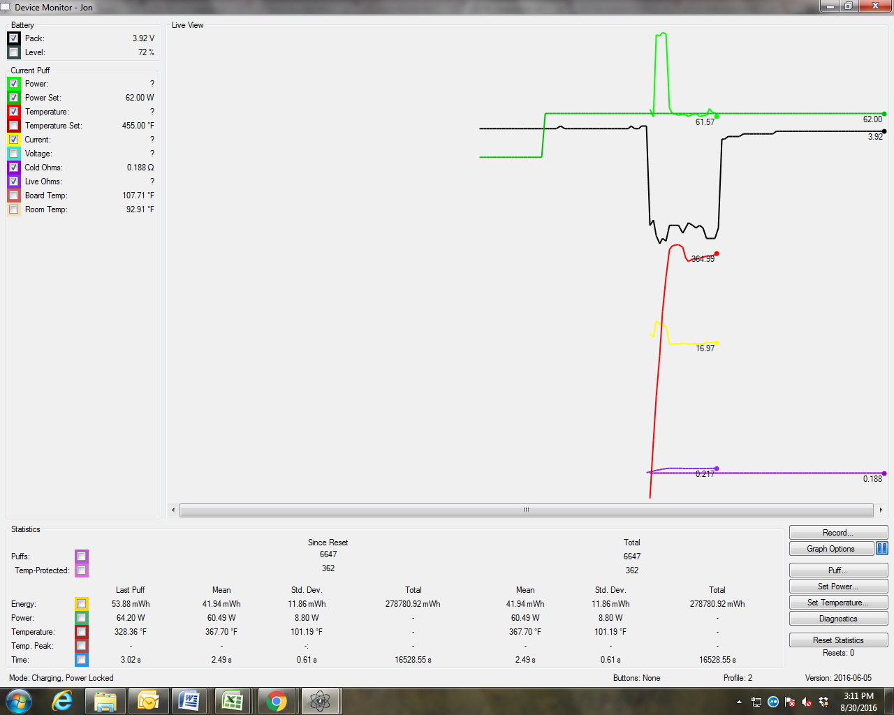

The picture above also happens (it's currently doing this). It's showing that it is reaching my set temperature, but producing little to no vapor at all. What the hell is going on? I've also found that if I take both batteries out then put them back in, it kind of resets itself and works again for a while then goes back to performing crappy.

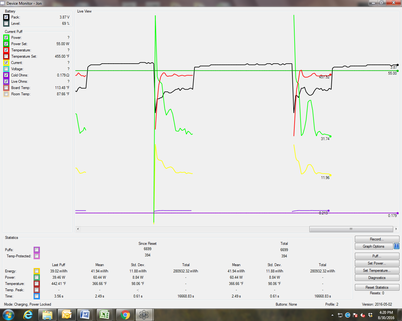

It looks like Escribe bumped me back down to the 2016-05-02 firmware. Any idea why it would do that? If you look at the pictures I posted in the original post it shows the 2016-06-05. Really weird!

You are fighting refinement. The cold resistance between your first post and 2nd post are pretty far apart. Always mate a cold atomizer with a cold Mod. It is even better if you set the mod down for about 20 minutes afterwards(after the new coil prompt).
Wait for refinement before settling on a temperature to vape at. Don't set your temperature at 455° then try to force your mod to vape at that temperature. With the tank you have and the power you have it set at, I probably would have it set between 480 and 520.
The DNA won't remember the cold resistance when removing the battery unless you have the resistance locked in. Replace the batteries one at a time so you don't loose power to the board.

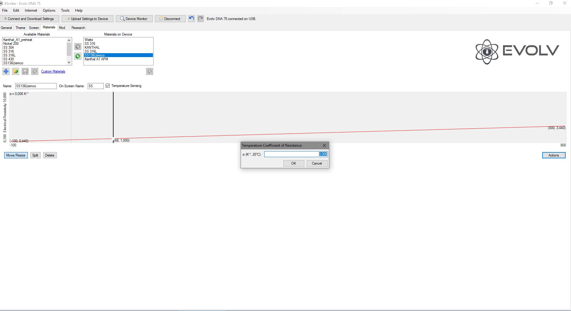

So here goes: I finally got it to work correctly by manually building a profile for the material (in Escribe) and long story short, used the 316L temp coefficient of resistances of 0.00159, then adjusted as per: 68F=1.0, and 800F=1.37.

A TCR value of .00091 will give you the same results...no adjustments necessary....00092 is a common TCR value used by lots of people & Daniel of DJSLB Vapes recommends a .00092 TCR value for 316L..http://www.djlsbvapes.com/dna200/..about half way down the page...00159 is very close to the TCR of SS410, which is .00155

Ok thanks, then I'm perplexed about all this...
I know my wire is 316L, all my non DNA device balance out the very same warmth at the same settings, and what I've done is the only way I managed (after hours of testing with the .00092 parameter that simply didn't work right at all and trying to adjust manually a curve that would give me a better result).
And from what I've found online in other forums, etc. including very this thread, not a single place have I found someone stating "this is the solution" and confirmed by every one else that would try it.
The few "solutions" looked like patches solutions follow with maybe one person saying that it worked for them, but then others that would say that it either didn't work for them is just temporarily.
Right now, my "solution" as worked for all of my tanks (several tested)... and I'm at the point of simply going, if it's working, let's not mess with it anymore.

SS can be a finicky critter to work with...can you post a screen shot of your 'Mod' tab in Escribe & one of 'Device Monitor', while firing, with the following boxes checked...Power, Power Set, Temperature, Temperature Set, Cold Ohms & Live Ohms...also, what kind of coils are you using?
