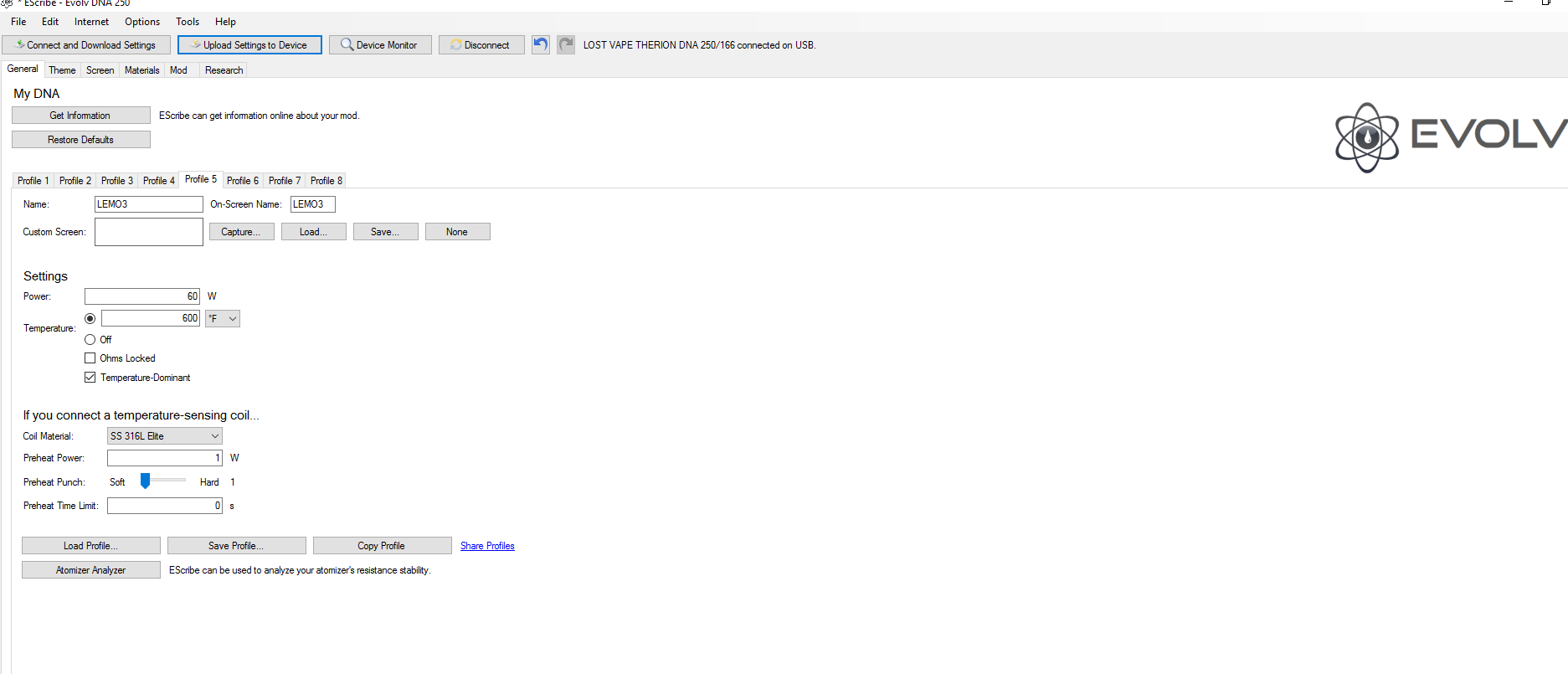

  8. I have only used the cleito SS coils once and I dont remember having any issues with them. Not sure what you mean by the "29 hour problem". As I said Its the same thing on different tanks so no deck or center pin problem. I too had a problem once with a wonky subtank base but thats not the problem here. I may just have to find different coils, normally eleaf coils are great (non ss) and they dont cost $20 a pack Sorry for the delay, here is the ss's of a puff on Lemo 3 (new) w/ eleaf notch coil general tab, materials tab, mod tab
