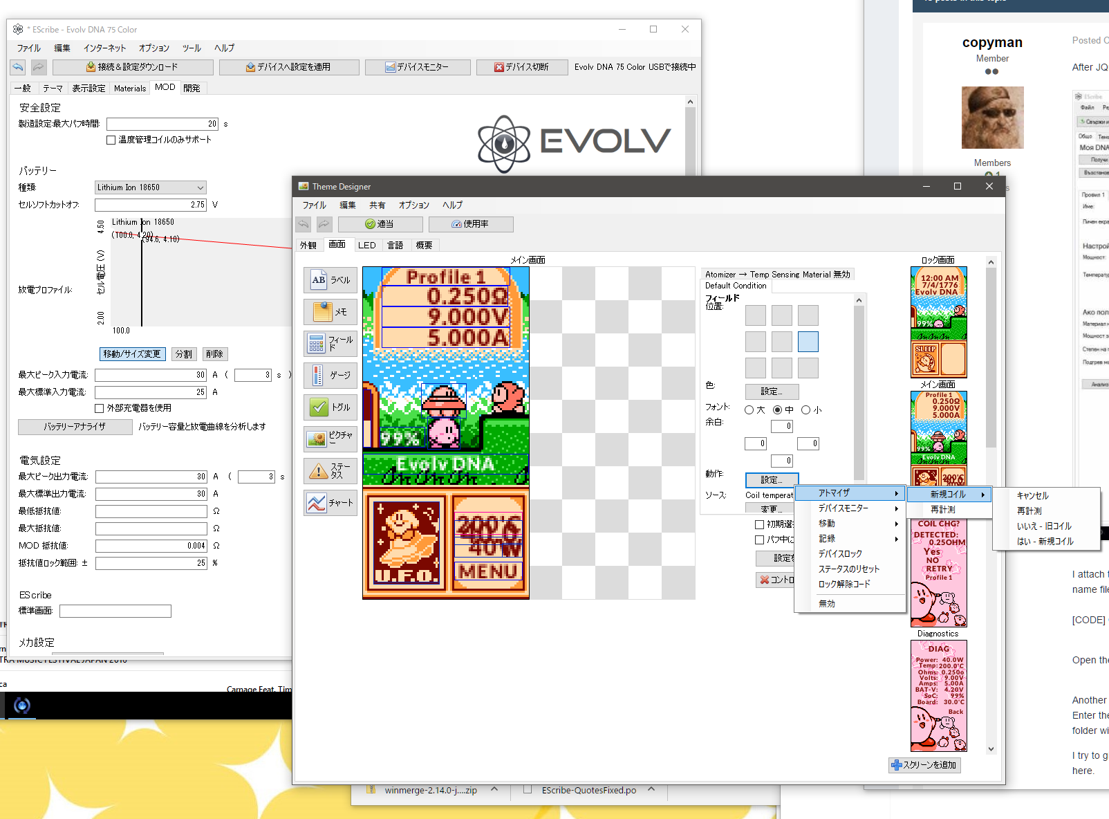

eucalyptus. Posted May 27, 2017 Report Posted May 27, 2017 Hello. Japanese Translation for eScribe 2.0SP2. By poedit. ja_escibe_20.zip 1
