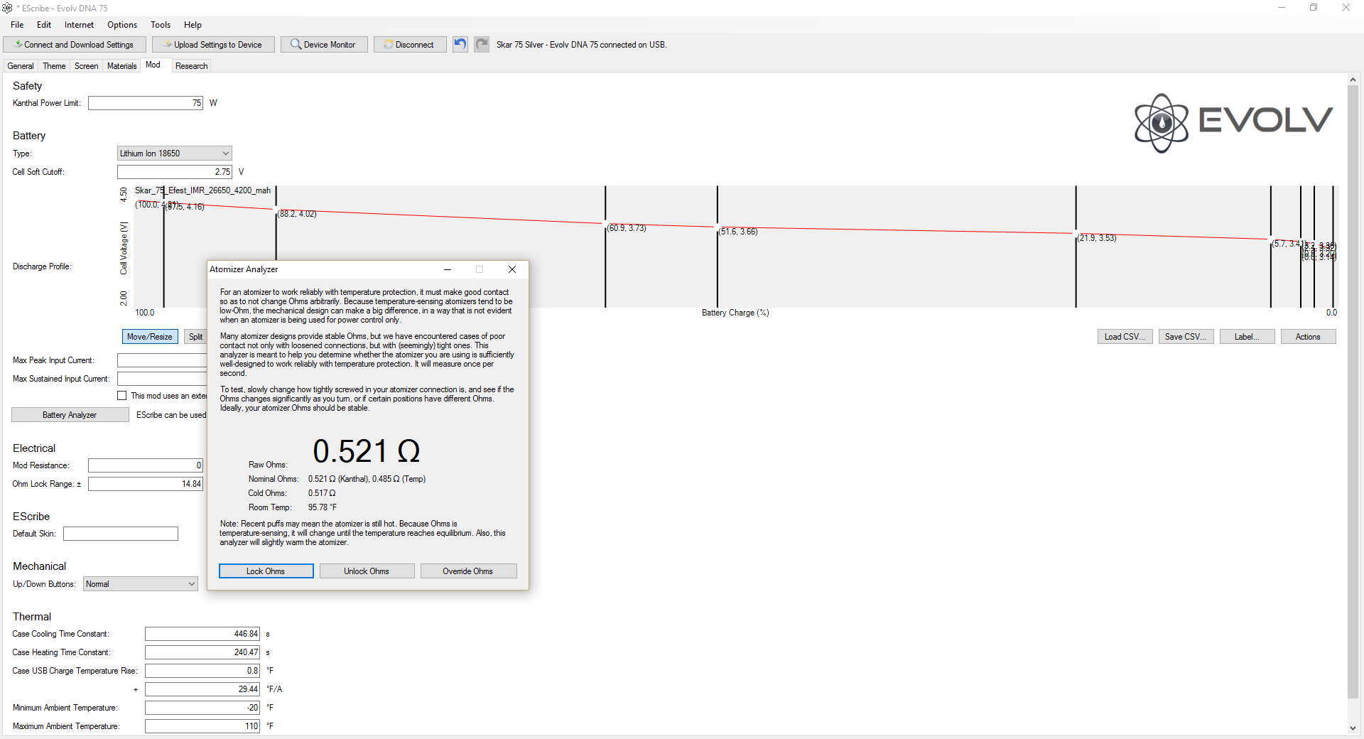

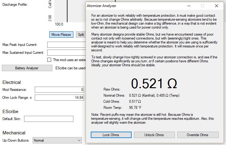

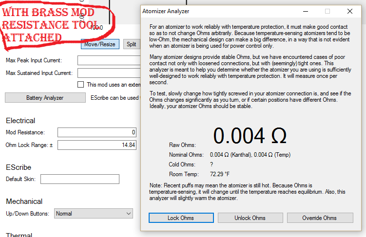

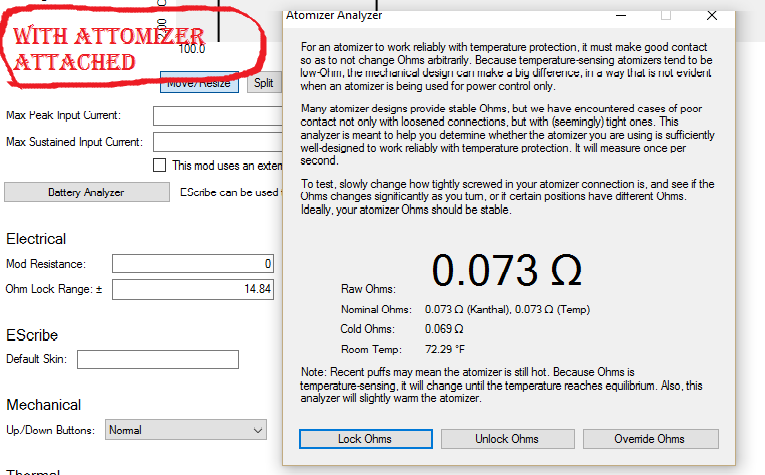

giz_60 Posted February 25, 2017 Report Posted February 25, 2017 These pics are of one of my 75's... AA still works properly with a shorting plug...different atty...
dwcraig1 Posted February 25, 2017 Report Posted February 25, 2017 Call me skeptical, I tried on my SMY SDNA75 which tests out to 0.002 ohm with tool. With an atty with 0.07 resistance it came out to 0.002 -0.003 with above method. But with an atty with a higher resistance (0.58 ohms) I got something around 0.008 ohms.Of coarse there's always the possibility that I didn't do it correctly....these things happen here on occasion (many)
giz_60 Posted February 25, 2017 Report Posted February 25, 2017 dwcraig1 said:Call me skeptical, I tried on my SMY SDNA75 which tests out to 0.002 ohm with tool. With an atty with 0.07 resistance it came out to 0.002 -0.003 with above method. But with an atty with a higher resistance (0.58 ohms) I got something around 0.008 ohms.Of coarse there's always the possibility that I didn't do it correctly....these things happen here on occasion (many)Tried that here too....different atty, same mod...Edit: atty & coil are brand new

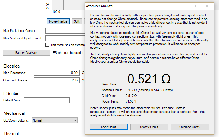

Catharsis70 Posted February 26, 2017 Report Posted February 26, 2017 Went with the giz method. Everything very clean. Brand new tank base and coil. Real resistance triple checked (two devices and a meter) for same or within reason same resistance all three. I could not get raw ohms to remain stable. Tightening, loosening. Tightened down more than my comfort level. Moving within 0.001 up and down from most stable number. Got a lock for about 10 seconds and used that numbrer. Final number 0.003 which seems to be a common range for 250 devices. Shave a hair off for safety margin inputting 0.00285. Vaping in temp mode beautifuly now even on SS nothch coils. Seems liks it reads cold ohms a hair low so I may fiddle the mod resistance input a bit to get it closer but otherwise its like a different mod. Thanks for the tip
