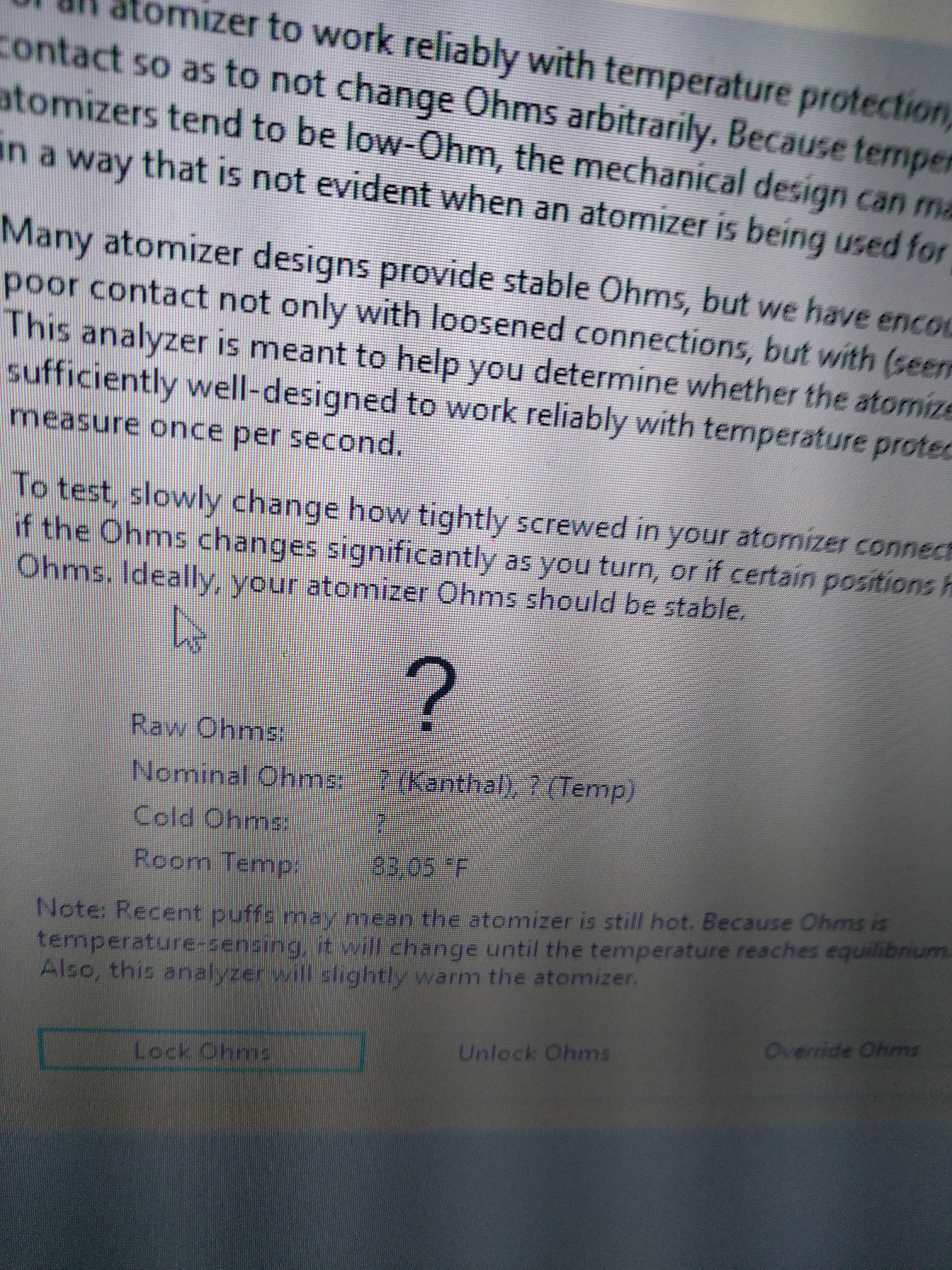

  3. Hi everyone, My device can't read under 0.008 ohms. I noticed this while shorting atom to know my mod resistance. No matter if I change atomiser or if I change wire (for instance I used a thick copper wire) but when I attach it, it start to read for example 0.011 and while I screw it began to go under and under, while the connection become more stable, until... 0.008 and then only "?". Picture attached. Please help! Shod I try to check 510 connector or maybe it could be a fault in the board? Thanks

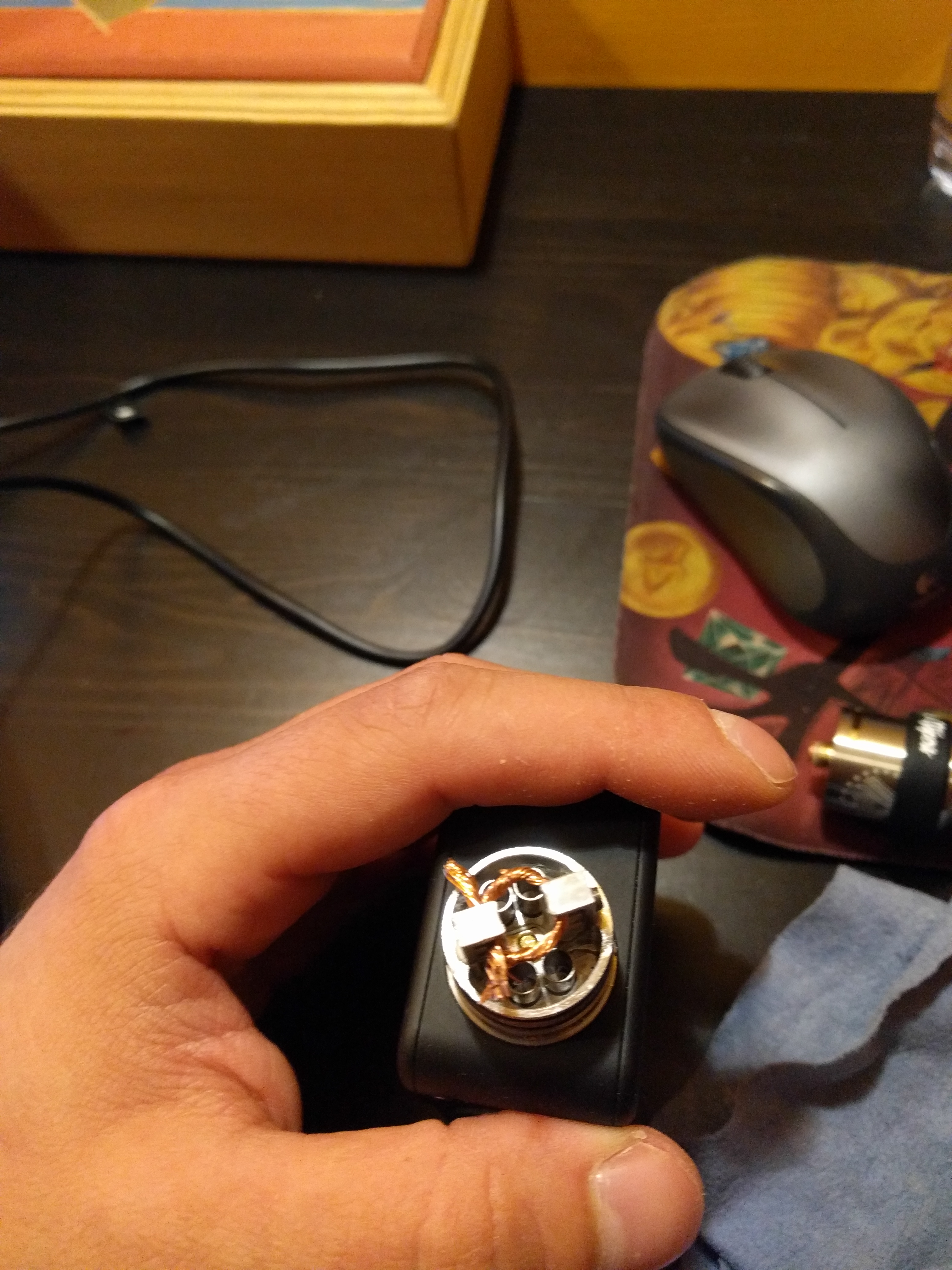

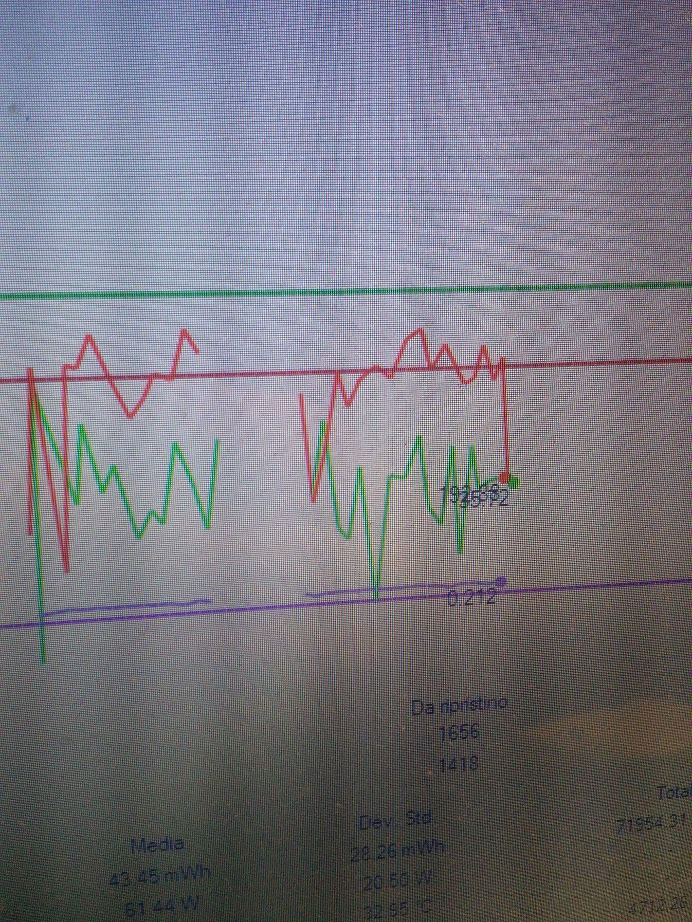

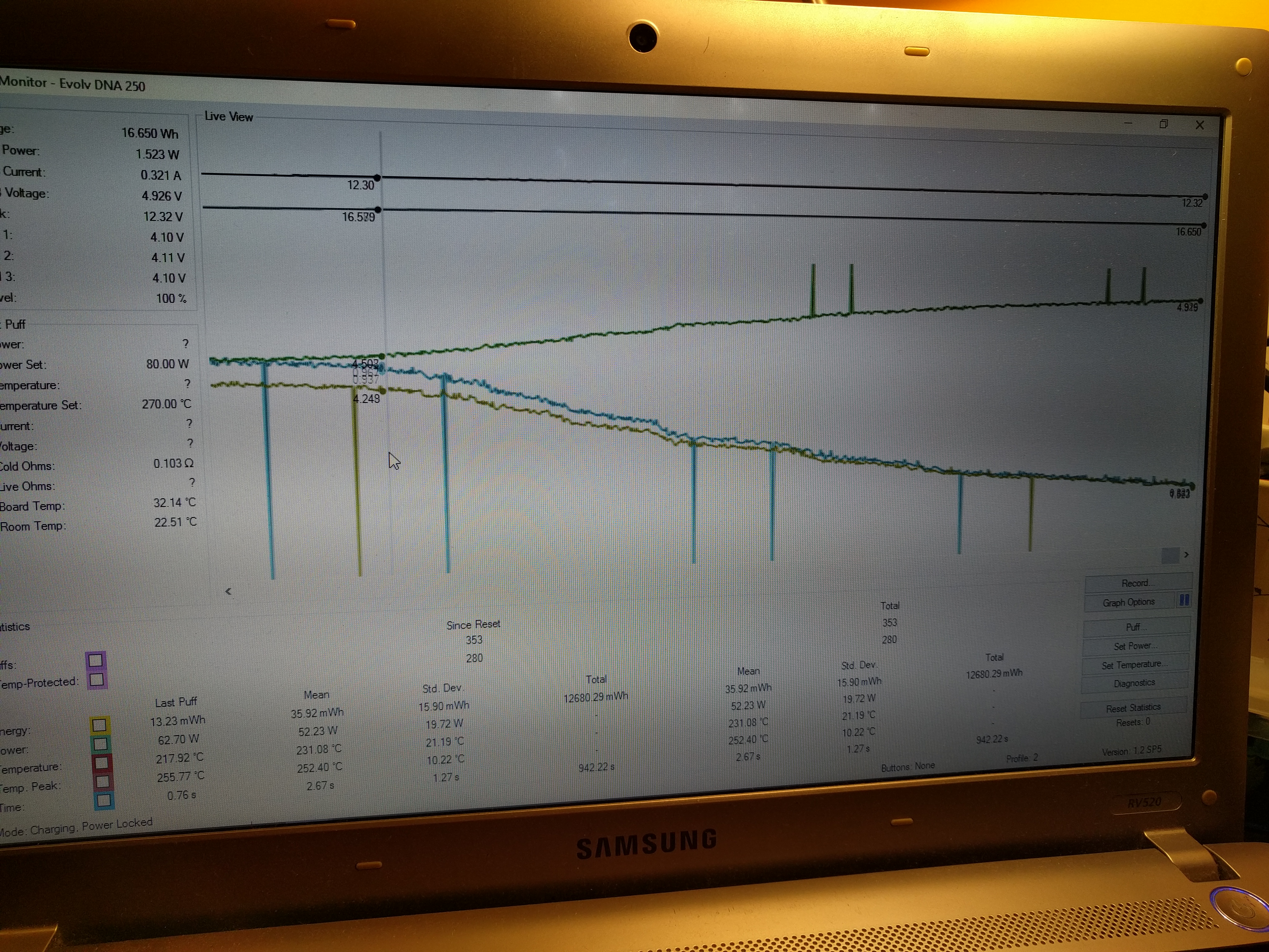

  7. Same story here... With 316L SS 0.60 first attempt and 0.50 second attempt, 6 wraps per coil - inconsistent temp curve staying at what device monitor says. No issue with nichel on the same atomizer. Later I'll try to use another atom and see what happens. To simplify tests o don't wrap and don't wick my coil just letting the wire looped and check device monitor while pulsing and firing. It just does not work. Downloaded csv files but did not change preheat and let it at 80 °C, how it wat set before on ni200 Check this pic
