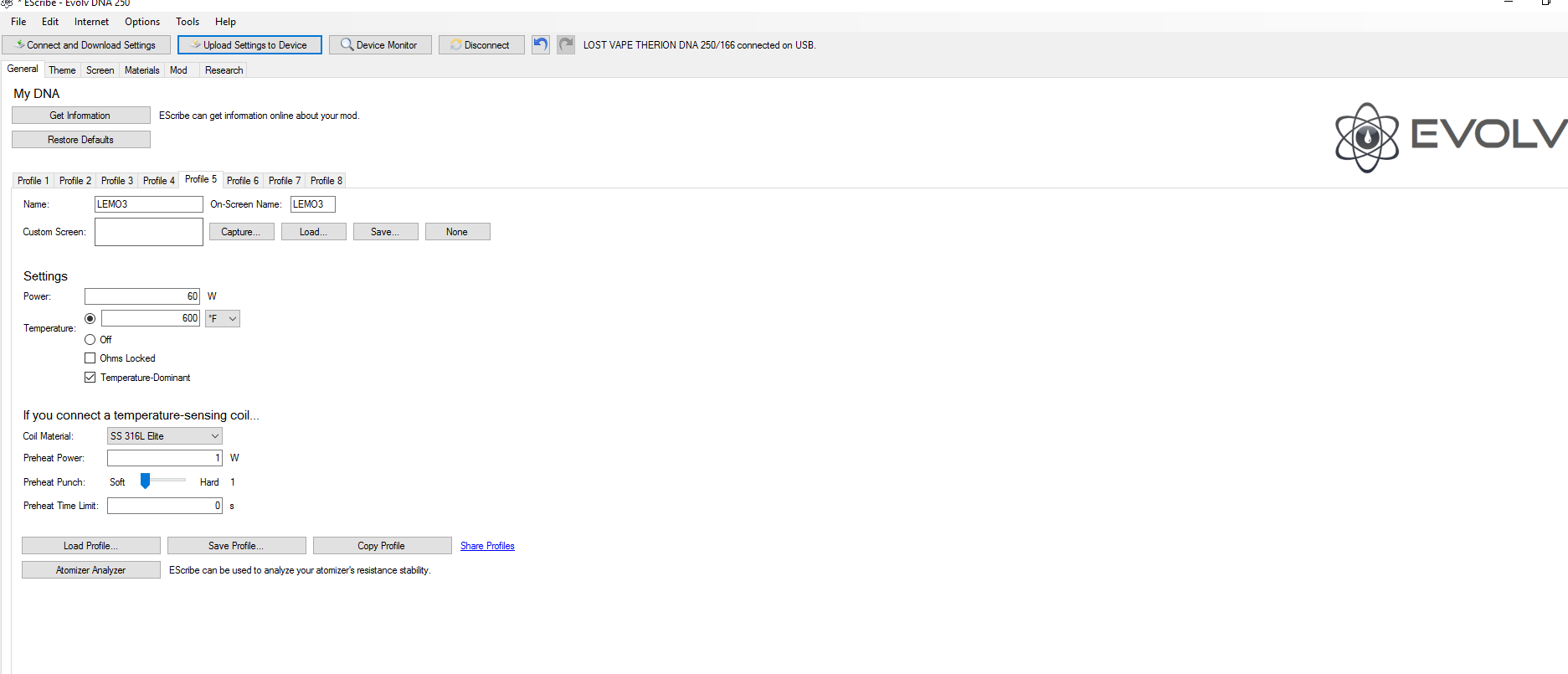

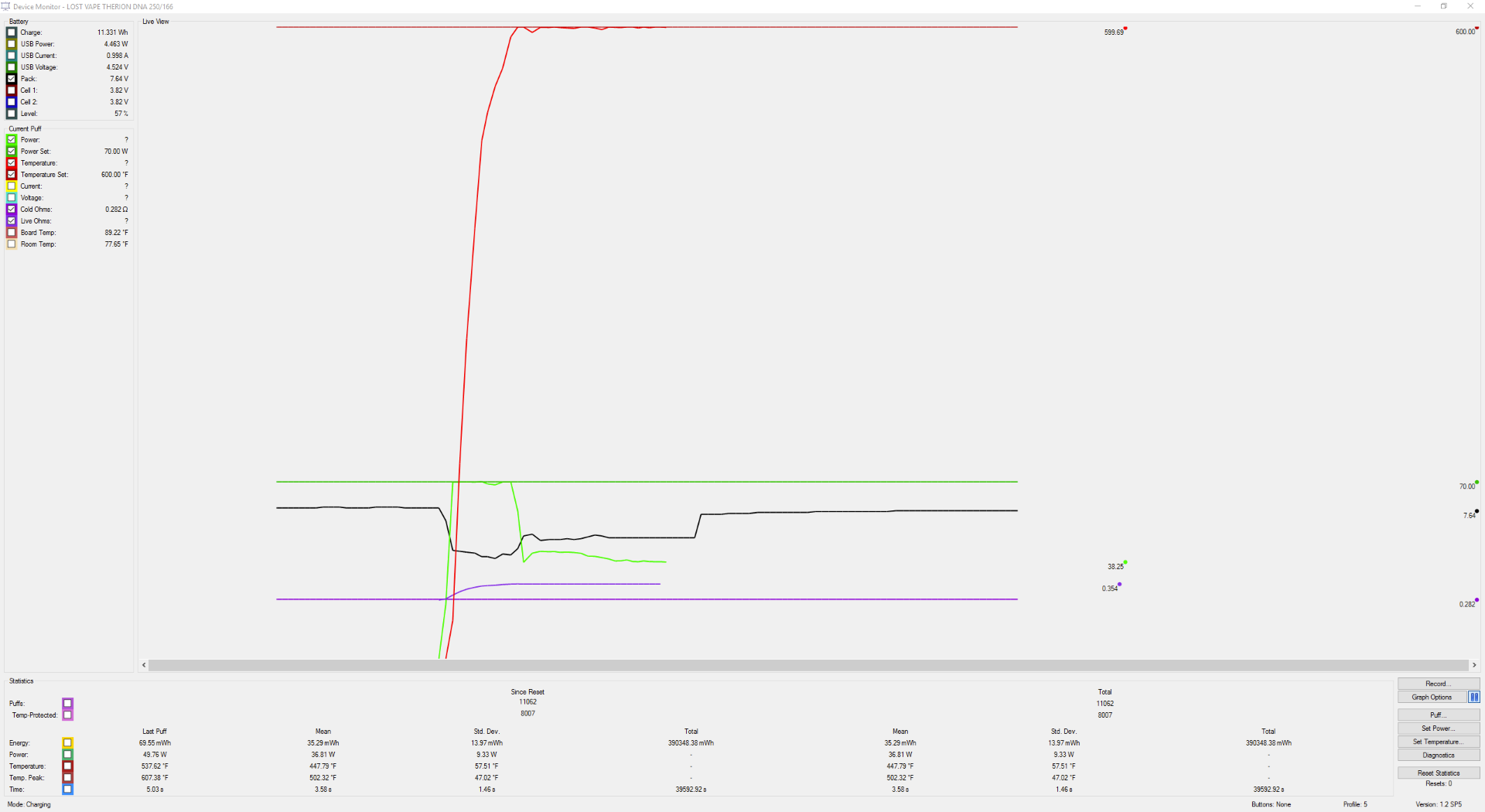

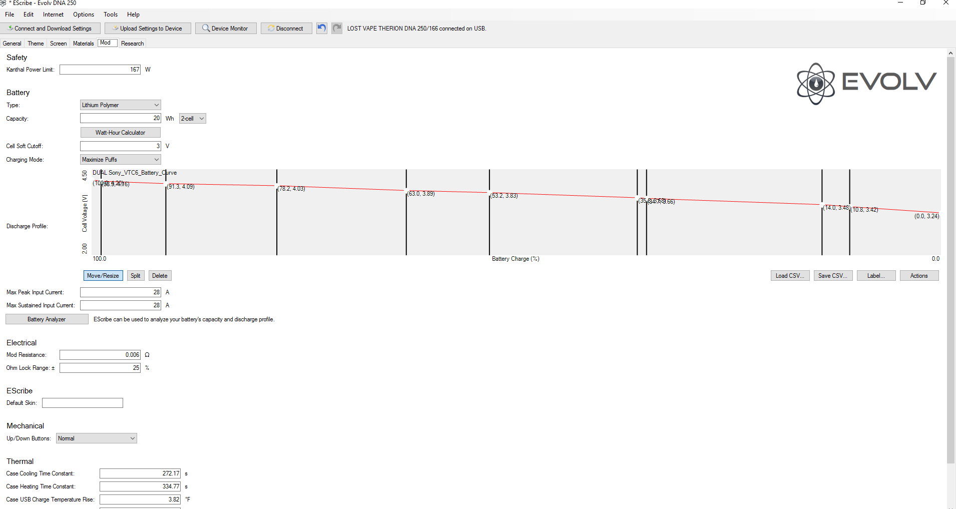

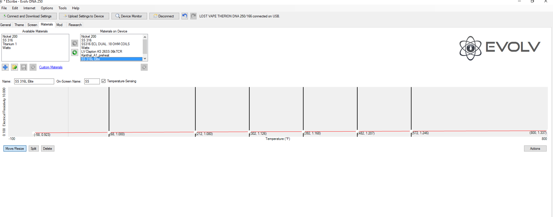

Wayneo Posted April 30, 2017 Report Posted April 30, 2017 I'm with @Saint_VB and @awsum. Pick one of your mods with this issue and post a couple full Printscreens (Mod tab, Material tab with wire type highlighted, profile you use) and finally Device Monitor while firing. Power, power set, temp, temp set, cold ohms, live ohms ticked.bgarren said:Not really for one profile. Try a greater preheat punch. They would have to recalibrate the entire chip to go above or below the temp thresholds in place. The issue is the temperature is at a threshold most materials are safest and most efficient at. Remember at the start 450 degrees was a setting to avoid dry hits at the burning point of cotton. Try a different wire for a warmer vape, such as sweet spot ti, it will probably be the warmest with one of the lowest k values or heat absorption to size ratio Guy, seriously? Pick any temperature, and your vape should have the same warmth WITH ANY WIRE TYPE. The OP is already here '600f and getting a weak vape' that's the issue.

Wayneo Posted May 1, 2017 Report Posted May 1, 2017 @sdmf74 YES, I use Aspire Triton and Cleito SS .4 premade coils succesfully in temp mode, the warmth I get from them matches my use of Ti coils at the same temp. Also closely matches when I 'roll my own' coils with 316L or 430.Is this ".... evolv 316l tcr with the LV wire" the material profile you're using for them?@giz That 'Aspire' in post 1 is actually what caught my eye first. Of all my posts, I only ever posted 1 Topic, which was about these coils. Without making assumptions I'm leaning towards that 29 hour problemEdit: spelling

Wayneo Posted May 1, 2017 Report Posted May 1, 2017 Not sure what you mean by the "29 hour problem". - That was meant for @giz.On a first look, I see nothing wrong with your settings. I'll have to ponder on this for a while

awsum140 Posted May 3, 2017 Report Posted May 3, 2017 I really don't think the problem is the chipset or the software. The biggest problem is finding the right TCR curve for the specific wire being used. Even relatively minor changes along the curve will effect how well it vapes. That's not chipset/DNA related, it's more related to inconsistencies in the wire types and the specific run of the wire or even variations inside a small roll or wire. Stainless does seem to be more prone to this problem though. The biggest problem is that without a lab quality micro ohmmeter it becomes a "by guess and by gosh" operation and leaves you wondering just what the real temperature of the build is.
